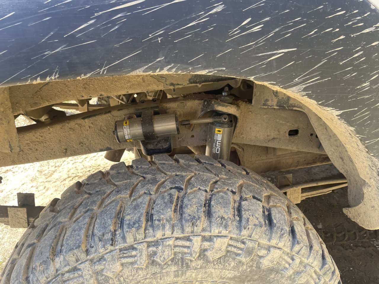

    Shannon’s truck isn’t finished yet but we gave it a little test run today. The bp51’s are a good improvement. You can feel the bypass in them when you are just compressing them off the truck. The have a very soft area at full extension and stiffen up considerably once they hit half compressed. Shannon hit some bumps at decent speed and the truck feels much more compliant, soaking up the harsh stuff while still letting you know it was a hard hit. I think the only draw back is the inability to adjust the preload once mounted. Which is a considerably inconvenient. 6D156FE5-7A6A-400F-848A-B7F67FA8AC92.jpg

    Could you adjust the Bilsteins on the truck?

    No, they aren’t coilovers. They have a snap ring that seats in 3 different positions. Pick your position and assemble
