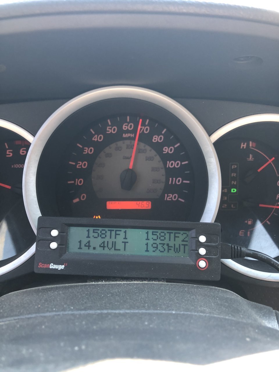

    Mine dont do that.. i wonder why

    you have a tow package? I somehow manage to find the only TRD OR without the alternater trans and oil cooler.

    Yes. TRD OR with tow

    I’m surprised with you running 4.88 gears that there’s that much strain on the trans.

    What was the outside temp ?

    80s. That was taken at 8:45am. I went to PA today to get a kayak.

    Mine gets hot after about 40 miles of highway driving (over 65 mph)in the mountains when the outside temp is over 90 degrees. around town on cool days with short trips it's about normal. I was messing around at shoe creek on some hill climbs and it spiked to 220 trans and 210 engine. Hopefully the radiator will help out.

    Hopefully you can pick @gearcruncher brain next weekend.
    220 is when i get worried. But before that im ok. Are you in 4th in the mountains?

    Im in 4th when going up any steep grade at highway speed. If im on the BRP I stay in 3rd unless its a long downhill. I generally like to keep the RPMs high and torque converter locked. It helps tremendously with trans temp. I have basically changed my whole way of driving sense I got the scangauge. Lord knows I cooked the trans on the beach and mountains before I knew any better.

    I definitely cooked mine on the beach at Cape Lookout. So much so, that the AT Oil Temp light came on. That shit was scary. SG2 said 330
