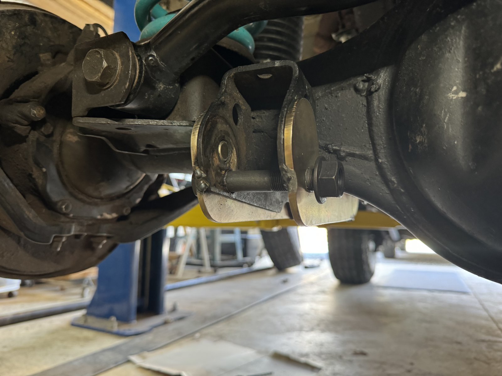

    Got the caster correction plates installed on the LC, definitely drives a lot better. Need to get the alignment checked to see what I ended up at (I was at 0* before).
    Rear bumper is getting close, pretty much just need to do final welding/sanding/painting.
    Caster plates:
    3pooches[OP] likes this.

    Does it push the front axle forward?

    No, it clocks the axle by repositioning the holes on the radius arm axle brackets. Hard to explain…spent about 4 hours drilling the new holes, not fun.

    Are you getting 37’s?

    This is just to have it quit driving squirrelly on the road. I mean, I eventually plan to get 37s but most likely not this year. I’ll probably need new radius arms when I go 37s to move the axle forward an inch, which aren’t cheap.
