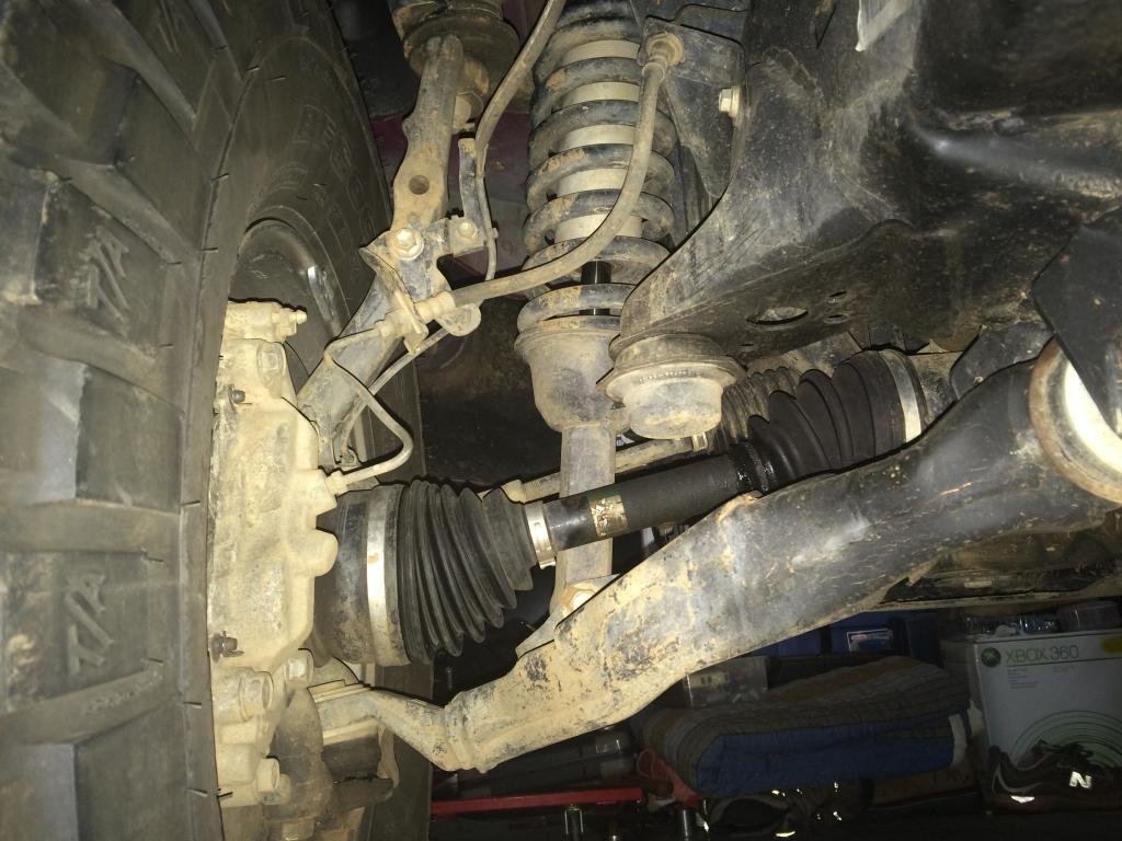

    Honestly it's hard for me to tell. My truck is so loud with the headers and exhaust and whatnot.but I first noticed whenever I pull into my mom's driveway I hear a tink whenever the driver side wheel hit the curb. Now that I've listened more carefully I think I hear it when I make right turns. If I put it in reverseand let it idle backwards and tap the brakes I can hear it. No grinding just a tink noise. Reason I think it's a CV is as follows. It does icon coil over lift not sure exactly on the height probably around 2 1/2 to 3 inches. There was no diff drops of the CV angles are bad

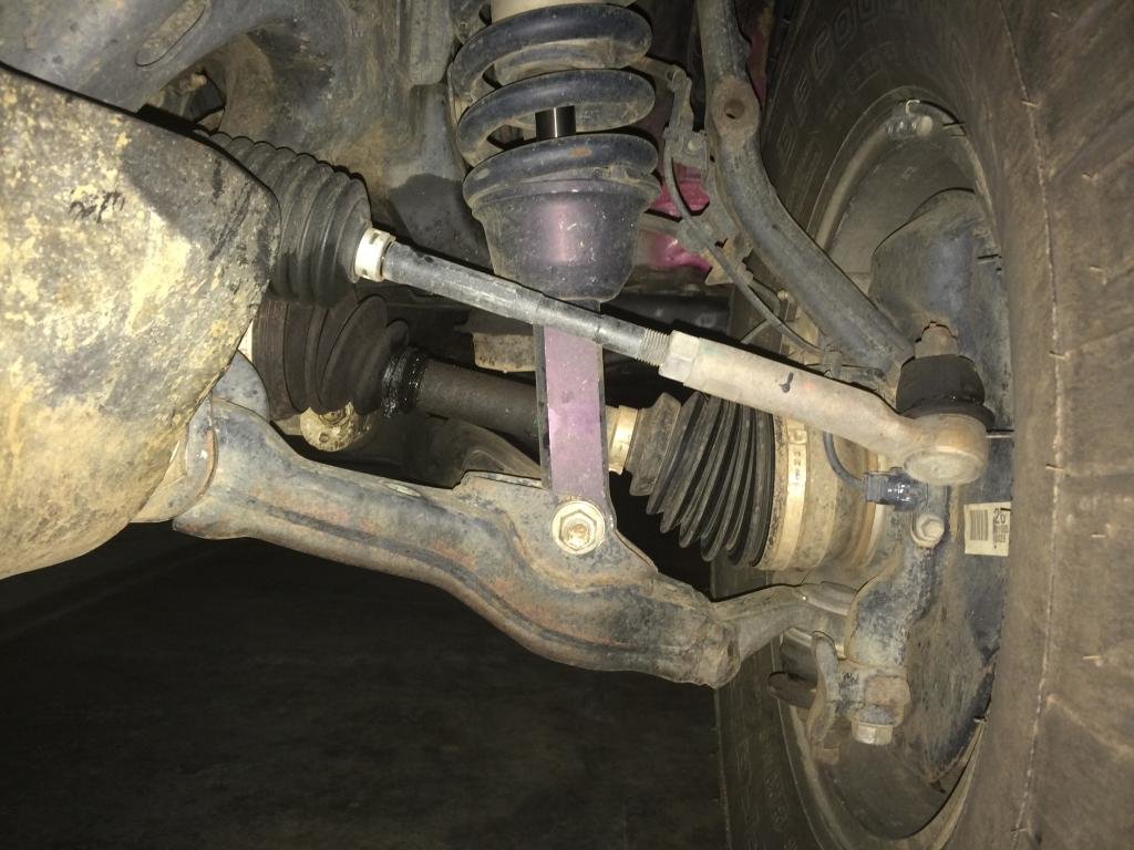

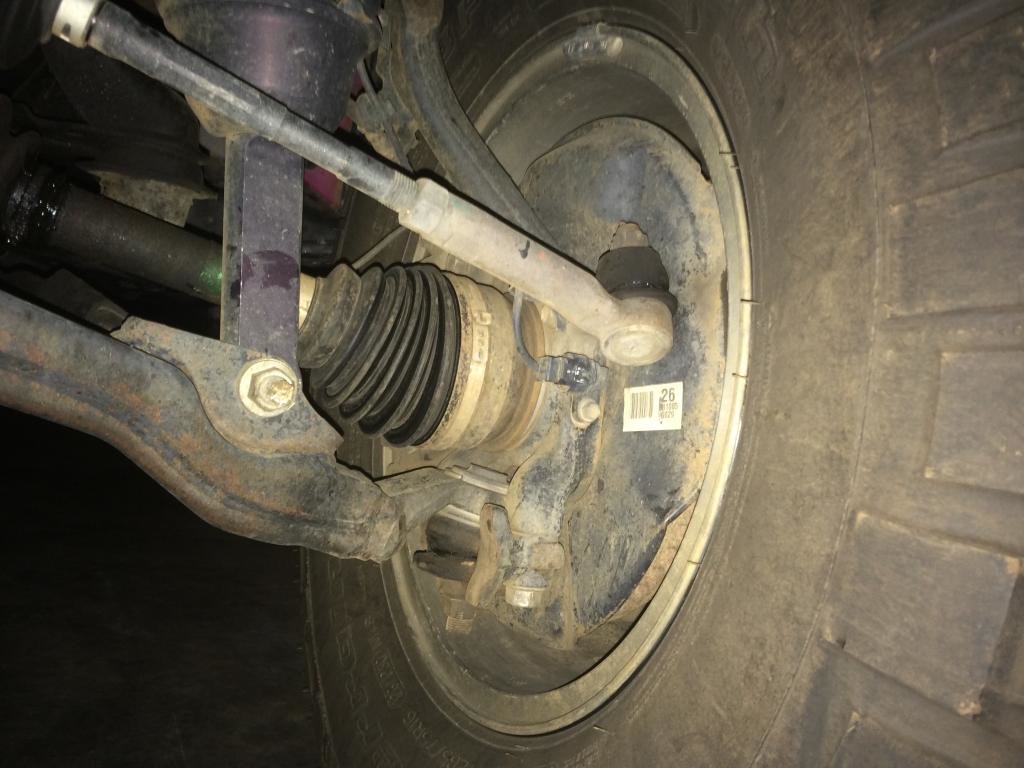

    Also the boot is leaking grease on that CV

    Need to be cleaned by the way... Lol

    the brake pads are shifting. mine does the same thing. I put brake lube on and they are quite for a bit, then the lube washes out and they clank again
