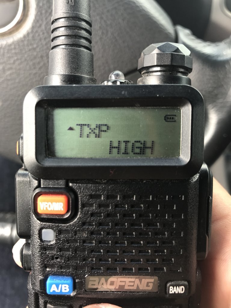

    Found it! Was already set on high. It's weird my last radio had better range than this one. Might need a better antenna.

    I just checked mine as well and it was set on high. The battery life span is great at that setting (Full weekend of use).

    I see you have a stock duckie. So yeah, get a better antenna. Something like the "Nagoya NA-771" is a really good antenna. They have shorter ones as well. The antenna length can be cumbersome inside a cab. Aftermarket antennas typically have better efficiency on TX and much better gain on RX!!!
    What were you getting, about a mile or less on HIGH power?

    Feels like a quarter mile, tops :(
    The one that was stolen from my truck ( :rant: ) handled a mile just fine. That antenna is super long! Think the NA-717 would still work better with my little 4watt radio?
