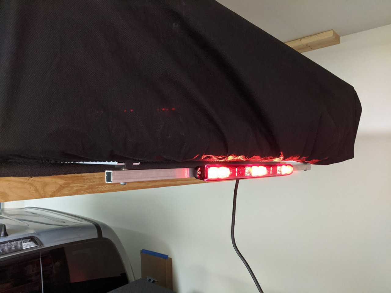

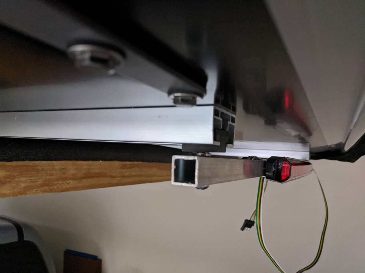

    While not as clean as @Frsh2df setup, a plug-n-play option is this trailer light bar, spliced to a 4-pin connector. I installed one for the roof top tent. The lights have all running, brake, and turn functions. (Turning signals are sequential, like on the new Audi's)

    Looks really good! Did the tapping into the trailer power go something like cables drop down by the tailgate and then a hole is drilled into the bed so the cable can be passed under, then a plug and play splitter for the 4 pin get used?

    Thanks! I actually didn't try to run the cables. I left just enough slack and then zip-tied the rest of the cables down. In my case, the lights are mounted with the RTT, which I take off for storage. Therefore this option was most straightforward for me.
    In your case, you might be able to try running the cables through the holes in the bedside storage compartment and avoid having to drill. (If you have 2019 or newer, I believe you'll only have that storage compartment on the passenger side.)
    I got this wiring harness for the length. Just cut off the female adapter end and splice with the trailer lights.

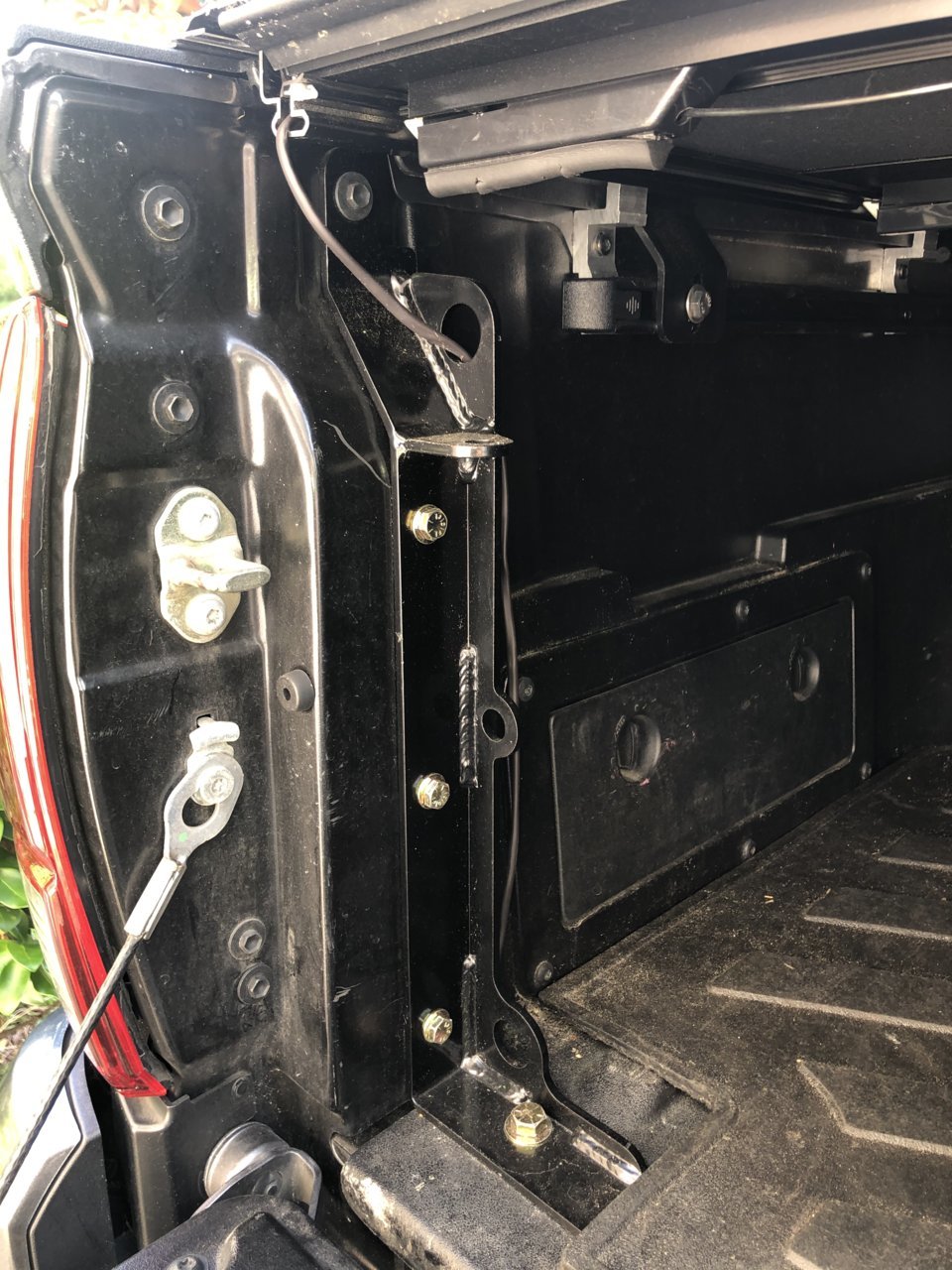

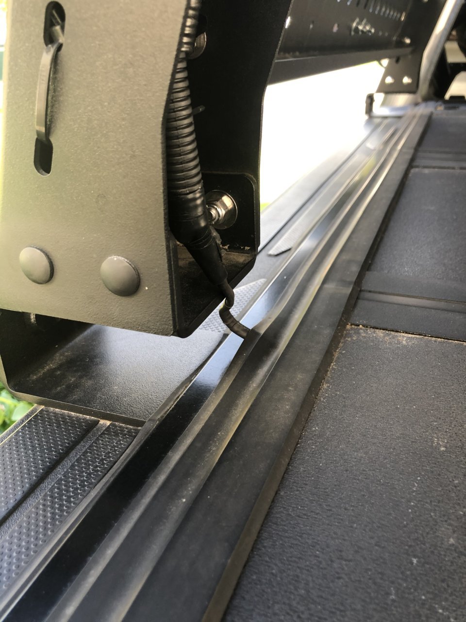

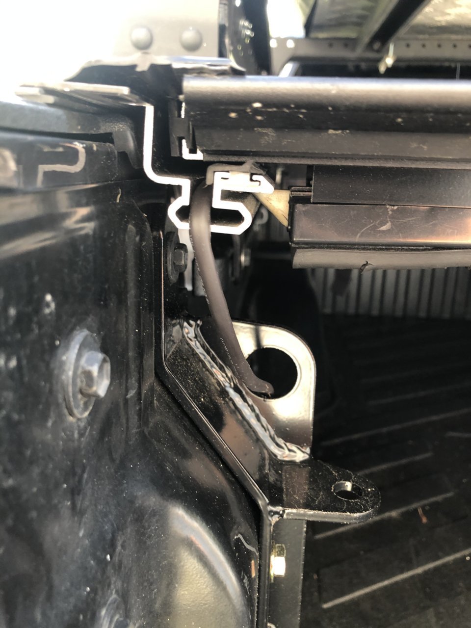

    Here are the pics as promised, sorry they took a few days.
    Where I routed the wires through the bed there was a small gap, so no drilling was required.

    that is perfect! I’m in no rush since I want to have all parts in my glamazon cart before ordering. I’ll definitely have to check the bed stiffeners for gaps in that corner! Thanks!

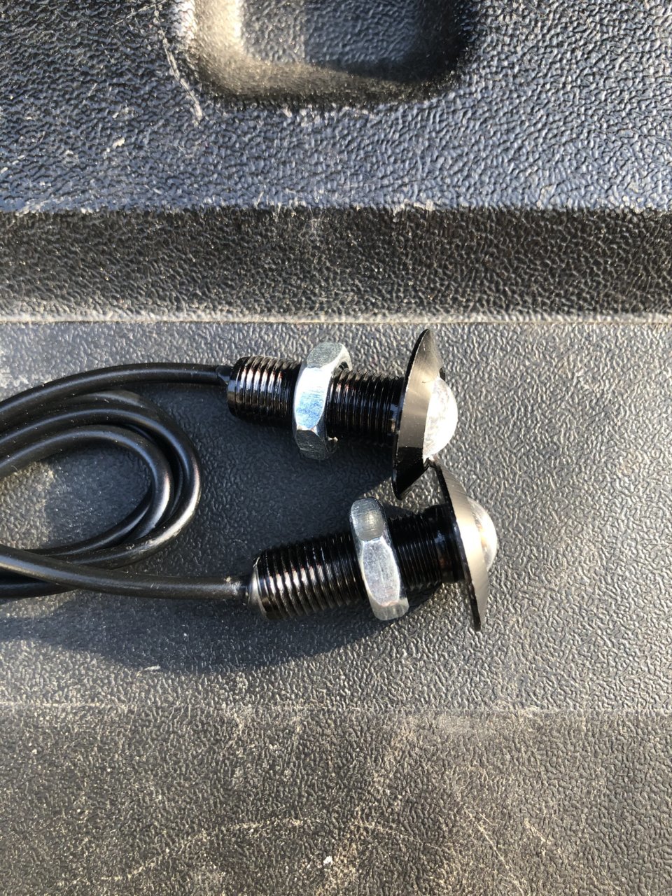

    The lights came in a pack of 10, I used 4 on the rack and have 6 left over in case one ever burns out.

    I forgot to add, it is easier to run the wires through the gap and then heat shrink them and pull them back up since it is a tight fit.

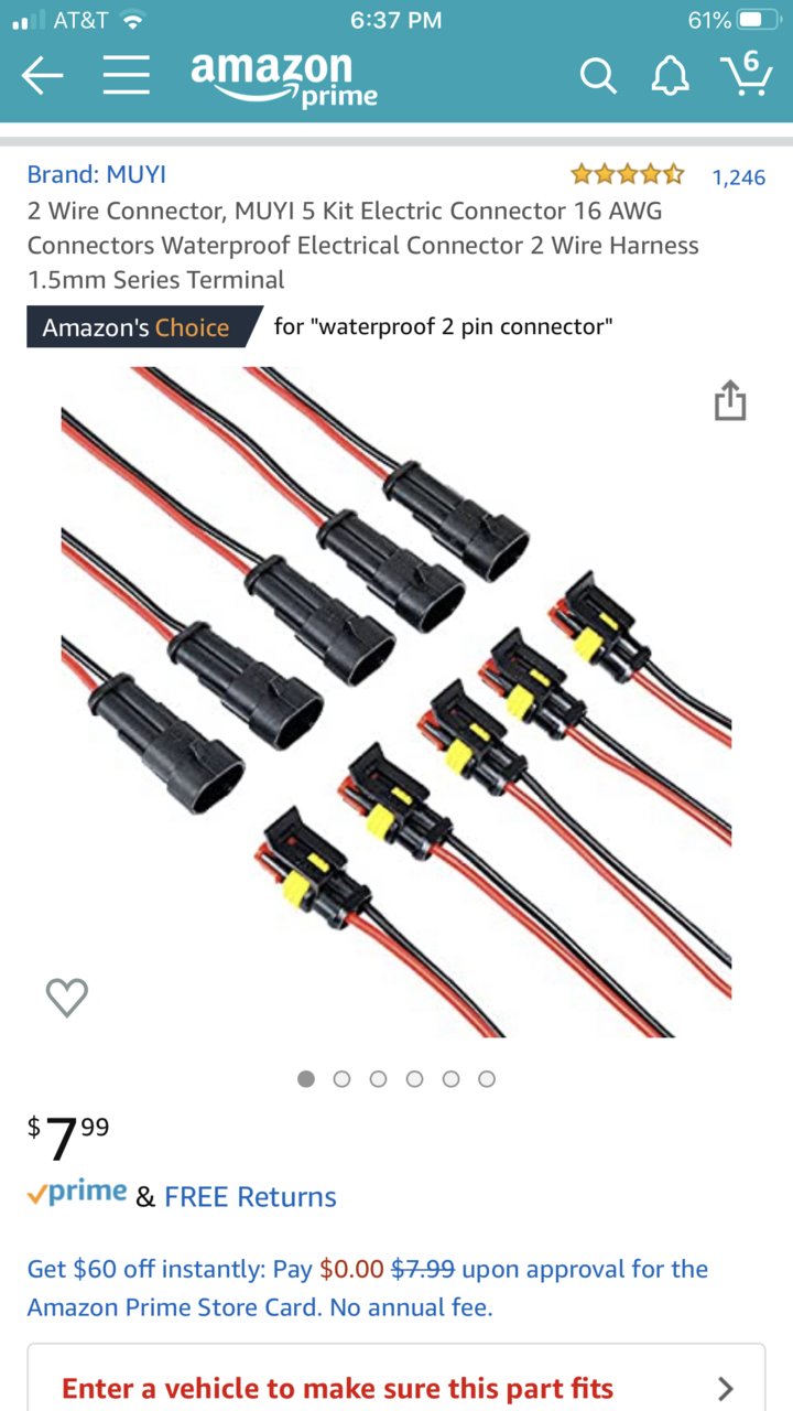

    I think this might be the last time I ask something, what connects did you get for waterproof quick connects? I don't know which connectors and cables are best on Amazon without having my bed burn to the ground!

    I used these and haven’t had any issues.

    they're generally called 'eagle eye leds'
    https://www.amazon.com/dp/B06ZXZXDBC/?th=1
    though i personally prefer the 3/4 grommeted clearance lights more because the led's are slightly more reliable design, and it's more of a universal design available far more places

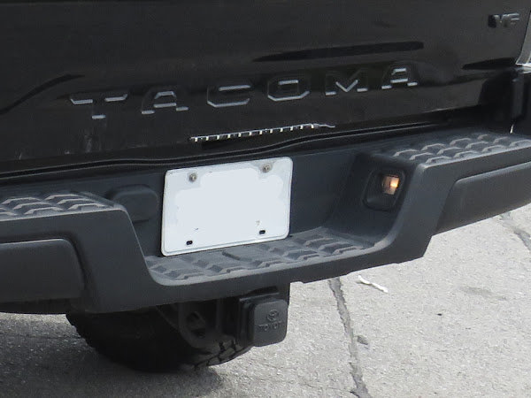

    I saw a guy just today that had those lights that folks put under their tailgate for brakes and blinkers mounted on the top bar of the rack.

    No sir. It was in Waco.
