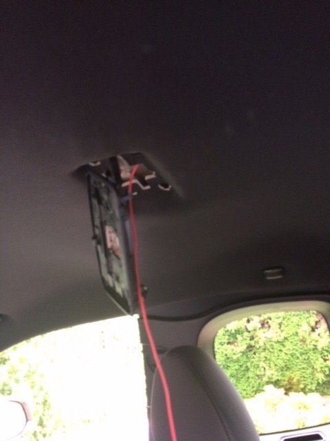

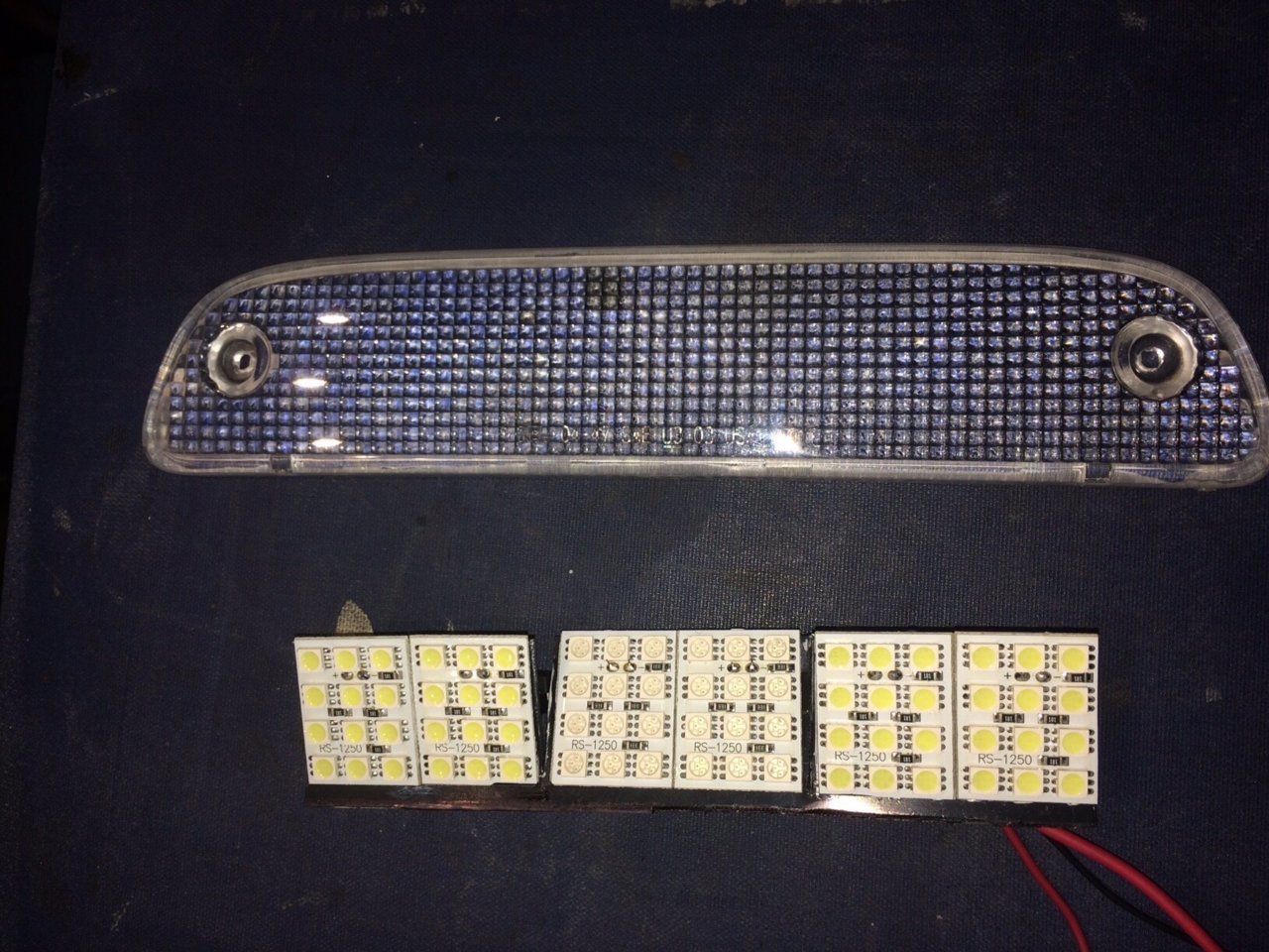

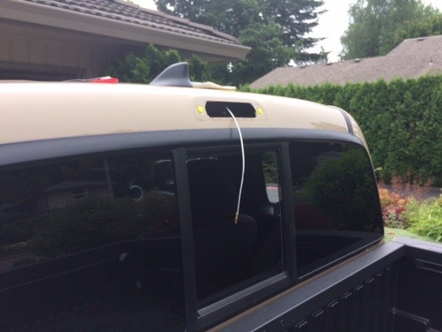

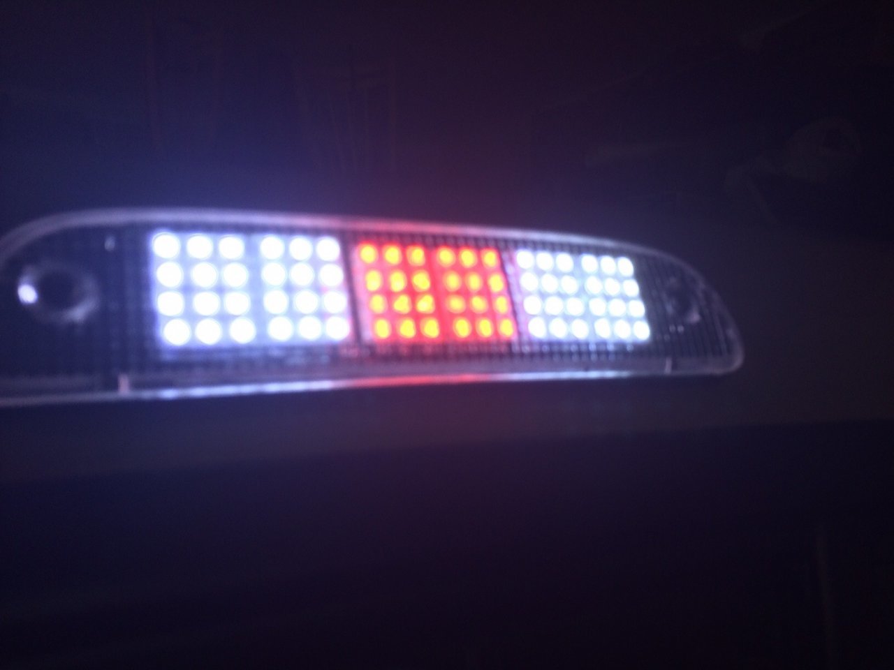

    Gen 3 double cabs come with a different third brake light that has the bed lights. They mount from the inside so you have to drop the headliner to access the hardware, Gen 3 access cabs have the same light as the Gen 2’s with the mounting hardware accessible from the outside but as you know they don’t have bed lights. I bought a clear lens and red and white led panels and made my own. I wired the bed lights to the dome light.

    Nice job any pics at night?

    Nope, but they light up the bed quite nicely.

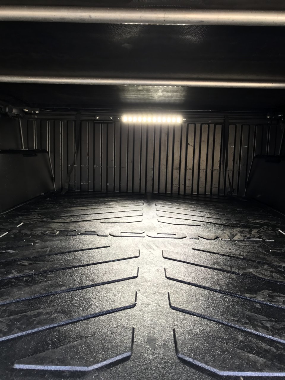

    I have a tonneau cover so installed a cheap Amazon light couple years ago. Amazing that the cheap stuff holds up when there not exposed to the elements IMG_1327.jpg
