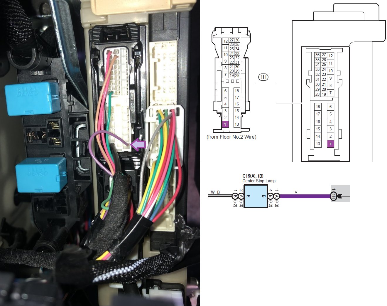

    Just bought a brake light flasher module (Stop-Alert) on Amazon to get my rear 3rd brake light to flash or pulse when I apply the brakes. Anyone have an install video link to help me with the install? Is there a place to splice into the brake light wiring harness that doesn't require taking down the headliner?

    Sorry if this is a stupid question, but this a pix from the fuse box in the engine compartment or under the dash? And where is the module itself?

    The cab fuses are on the under side of the module.
