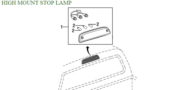

    Hi,
    Does anyone happen to know the part number for the o-ring that goes under the 3rd brake light lense? I went to replace the bulbs and the old o-ring fell apart into multiple pieces.
    I tried google-ing and everything kept pointing me toward a foam piece, which is NOT what this thing is.
    Thanks,
    Kyle

  8. Jul 7, 2022 at 5:53 PM
    super_white
    super_white Well-Known Member
    Feb 6, 2012
    #72230
    8,471
    Harry
    Connecticut
    2012 Tacoma 4X4
    All of my info shows it as an assembly and getting the o-ring separate isn't possible.
    You can try and measure the o-ring that's in there and order some o-ring cord and make your own with something comparable to this: https://www.amazon.com/Actual-Buna-N-Durometer-Thickness-10/dp/B00QVB68QW?crid=1P7KI4J92TBZ0&keywords=rubber+o+ring+material&qid=1657241517&sprefix=rubber+o+ring+material%2Caps%2C77&sr=8-3
    To connect the ends a little super glue will work. I made many custom o-rings at my last job using this method.
