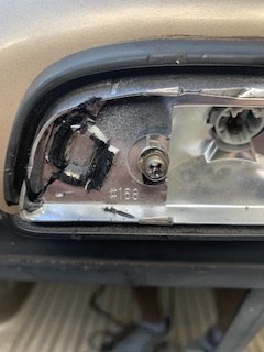

    Little over an hour

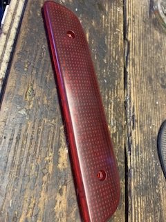

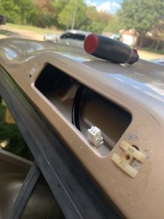

    Been researching here
    And NO FREAKING WAY was I going remove or attempt to drop headliner.
    Found some member who used a dremmel to cut old housing to gain access to 10mm bolts
    Started with that theory, but found better way.
    Let it be known that most of work was dealing with the cheap ass design of the led light.
    Definitely got what I paid for.
    Hopefully this helps out someone!

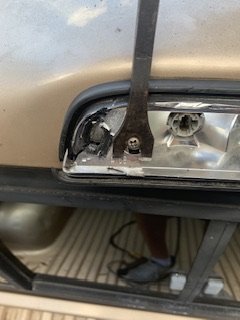

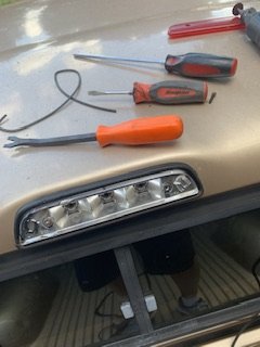

    Decided to try cutting away the housing tabs first….to see if would work
    Housing did become looser
    So had idea to put back screw then use the head of screw to pry housing off
  3. Sep 30, 2023 at 1:47 PM
    ControlCar
    ControlCar [OP] My Moto: Help & Learn…period.
    Jul 22, 2023
    #429578
    3,376
    Steven
    Sugar Land TX
    1996 Taco 2.4L 2wd Automatic
    Clock Volt meter/LSPV Delete/Hyundai 16’s/FP gauge/after 9months of wrenching ZERO oil leaks
    It worked!

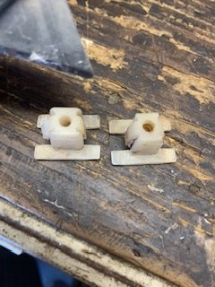

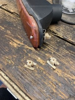

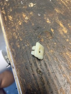

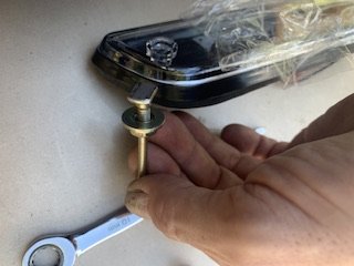

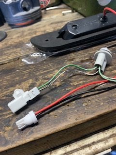

    So here is where the Chinese problems came into play
    AM lite mounts where the 10mm housing bolts go
    Besides coming with no hardware, had to think
    There is no way to secure bolt to tighten screw head to mount the new light
    I scavenged the clip nuts from the old front turn signals
    Trimmed

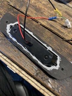

    Re wired/crimped the OE pigtail
  6. Sep 30, 2023 at 1:56 PM
    ControlCar
    Jul 22, 2023
    #429578
    3,376
    Steven
    Sugar Land TX
    Just in case, sealed.

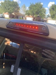

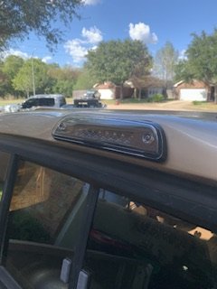

    Done

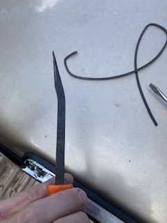

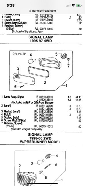

    Semco
    The driver side ‘slot’ is thinner than R side
    I found another thinner ‘fixed clip’ in my toolbox
    Or
    Can use same #7 trimmed clip and use a file to open up the thinner slot on L side
    Looks like this….
    semco-inc likes this.

  15. Oct 1, 2023 at 6:34 PM
    semco-inc
    semco-inc Well-Known Member
    Sep 9, 2023
    #433183
    129
    DFW & ATW
    1995 Tacoma 4x4 Extended Cab 3.4L
    Tundra Front Calipers & Rotors, Bilstein Shocks, 2DIN Head Unit, JBL Front Speakers, Tweeters in 4Runner Dome Pods, Transmission Oil Cooler, 16” Tacoma OEM Alloy Wheels
    This sounds a lot less intimidating than the full Monty headliner drop :thumbsup:
