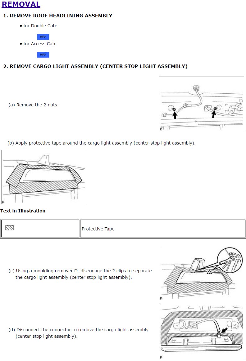

    Ordered a smoked brake light I don't see any screws like the older Tacomas how does it come out?

    I believe you have to go through the headliner.

    I probably won't do it but I pulled the headliner down just enough to access the back and could not find any bolts whatsoever. The only thing I saw was the wiring harness that runs up into the physical body. It goes through a hole so there's no way you can even get your fingers in there to unplug it. Not sure how that sucker comes out. Apparently on the 2018 s there different.

    There is someone around here that posted up the service manual. Its a big file but probably has the procedure in it. I'm on my phone right now so it's hard to search, but if you search for service manual and download it on your computer it may help.

    2 10mm bolts tucked wayyy back in there. Pics of your tinted brake light? It’s going to cut down on the bed light dramatically

    Thanks. Yeah I just talked to one of the Toyota parts guys and he was saying from his fish that the LED versions or internal and a pain in the butt to get to you really have to pull the entire headliner to access it from the fish. The non-led versions or the normal screws externally. He had mentioned that there is a company that makes sticker covers that will give you the same effect as a smoke light without all the work. You can even customize it to your liking.

    Ive pulled mine out, just needed to pull half of it down and reach up in there, its not terrible to do, and i like that it is smooth on the outside, easer to clean and its not like it should ever need a bulb change. ( i hope).

    If time wasn’t an issue, I could come up with an idea of cutting a square section of the headliner and create an access panel fitting...Perhaps out of carbon fiber to allow access to the third brake light. I hate that people will need to pull the entire headliner to access a simple brake light.:frusty:
