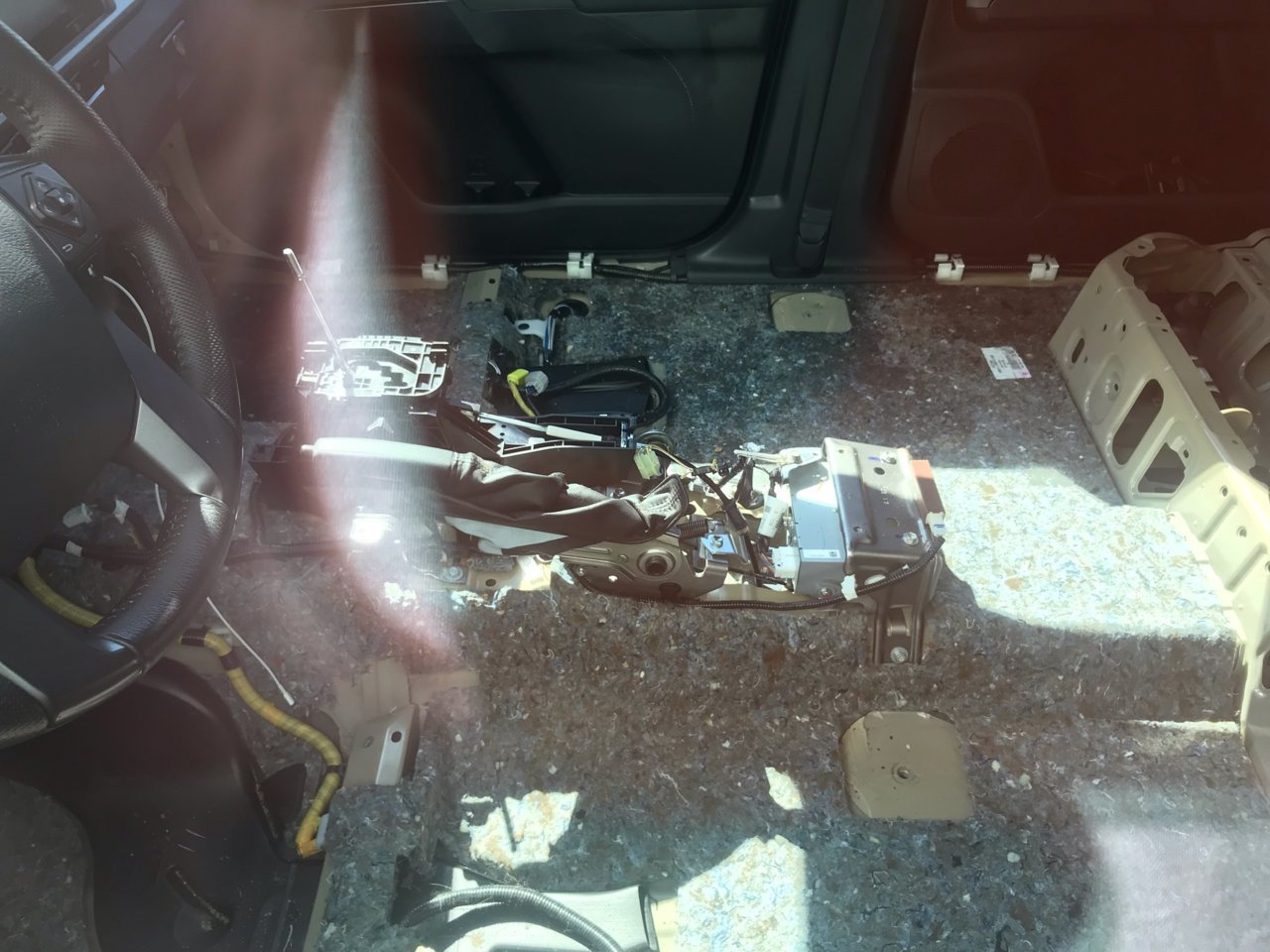

    Just got my truck back. New third brake light, new carpeting and padding. I was talking to the dealer rep when I brought the truck in. She advised me that there were two time frames from corporate on dealing with the recall. Easy up to two day fix and if water damage was found they could take up to two weeks. Figured if corporate would pay the dealer up to 14 days….. it was gonna take two weeks to the day! It did!
