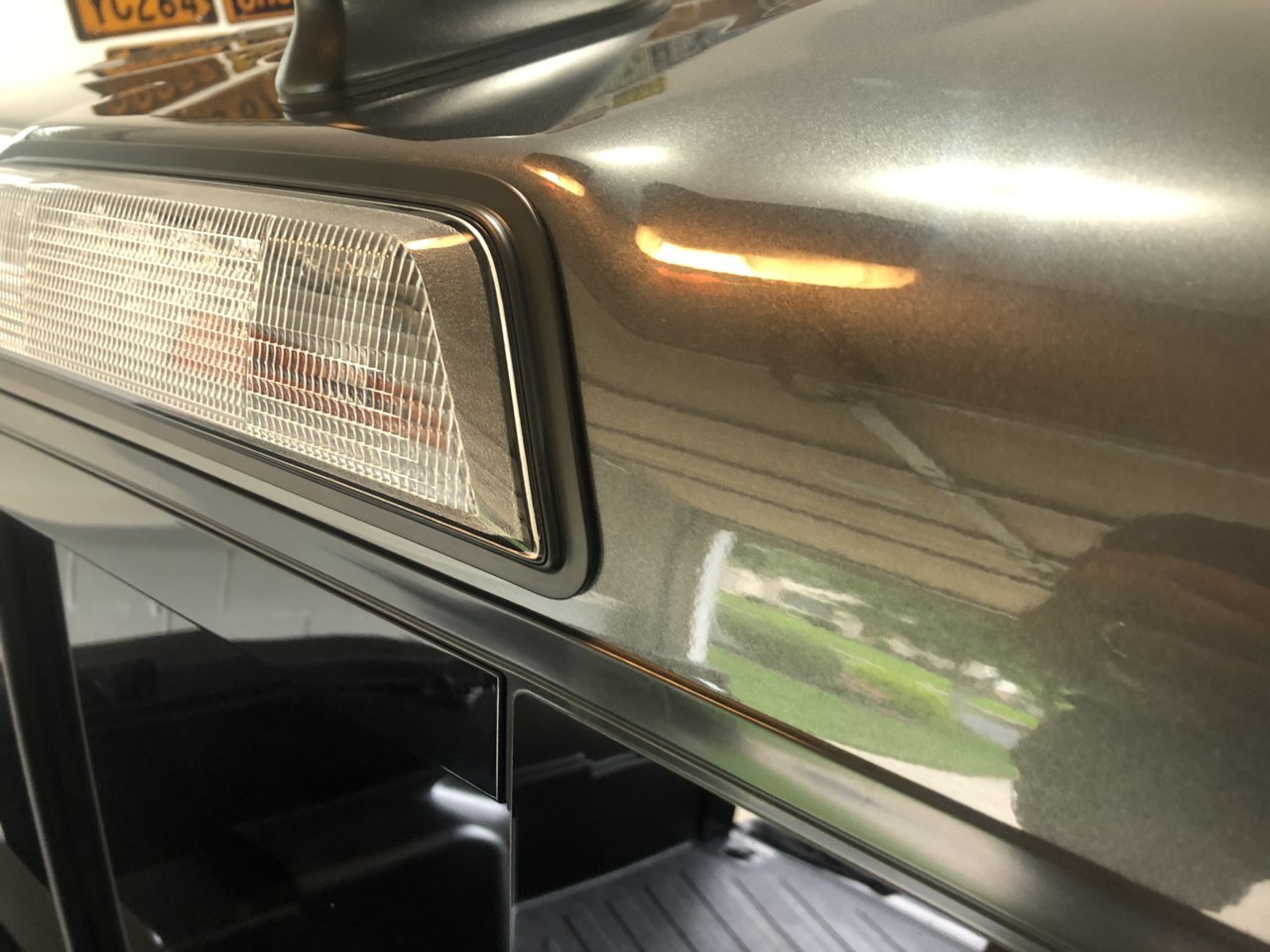

    Just dropped my truck off. They said they do it all from the outside. How can that be. They have to go in thru the inside to get to the light. Right ?

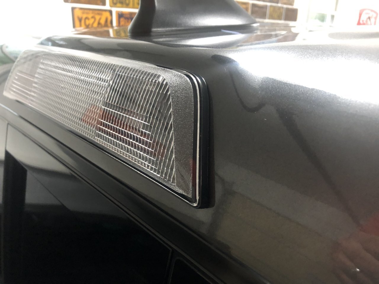

    Nope, they’ll check the inside for signs of leakage by looking behind the seats and headliner. If no signs of leaks they leave the light alone, put silicone sealant around where it meets the cab then cover that up with a new trim piece.
    If you do have a leak then I believe that they replace the light then do the above procedure. I didn’t have any signs of a leak.
    Here’s my before and after. 564D8866-DF6D-4A1E-819C-9C79983B4F52.jpg FF4250A1-5A28-4151-B563-D0B2E8208337.jpg

    A picture tells a thousand words!! Looks like they probably put a bead of silicone around the existing fixture, and that new trim piece/flange slides over the existing fixture and seals against the cab.

    Has anyone done this themselves? If so, a quick DIY write-up would be awesome. I'm hearing 2 versions of the replacement. Some say it can be done without removing the existing fixture, some say the light has to come out a a new seal/flange is installed. Based on the picture above, there's definitely a new flange of some sort that's installed with the seal and silicone.
