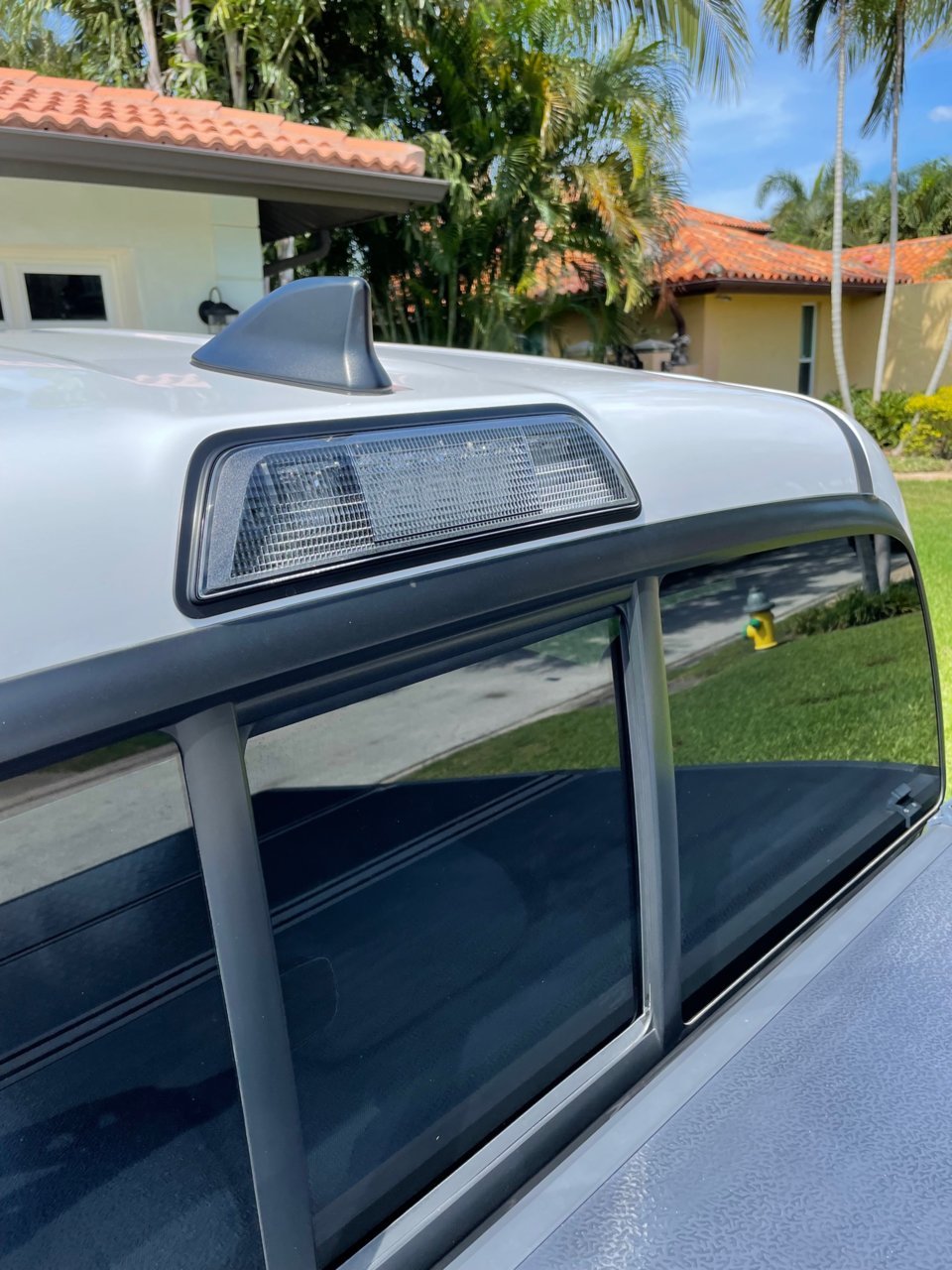

    I just had mine done this morning as a preemptive measure. Took 1.5 hours, but the service center was slammed this morning. The "fix" looks factory, and if it was there when you bought the truck, you'd never know the bezel was added. Actually looks "beefier" on the super white paint. What I thought was going to be a "duct tape" fix actually turned out perfectly fine.
    The only issue is, they used 3M 4200 evidently, which is not only a sealant, but has pretty good adhesive properties as well. I assume the light doesn't have LED bulbs from the factory which would last a long time, so replacing the bulbs in the future will have to be done without removing the fixture.
    CrufflerJJ likes this.

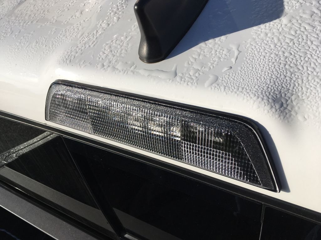

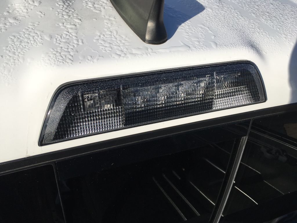

    Jay
    '17 Tacoma TRD/OR MT
    Bleep100 likes this.

    Thanks for the pics, looks good. When I first started looking into this and wondering why mine wasn’t on the list, I thought that all repairs (water intrusion or not) would end up with the bezel being applied. But looking a little closer at the repair specs it states that if inspection reveals that a new stop lamp assembly is needed the vehicle does not require the repair kit or the hardware kit (I’m presuming the bezel is included in both kits).
    Now I’m wondering if there’s actually a good reason why Cdn vehicles aren't on the list.
