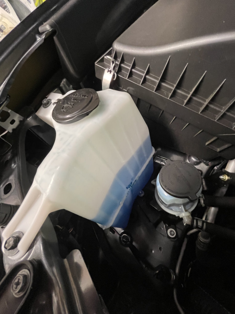

  12. Oct 8, 2021 at 2:01 PM
    #312
    MGMDesertTaco
    MGMDesertTaco Come on, live a little...
    Jan 30, 2021
    #354573
    10,438
    Just order a new light for $150 or less and swap it yourself. I can sympathize with you as my truck is 2017, under 11k miles, yet 2 months from being completely out of powertrain warranty. Today I noticed my windshield washer reservoir was cracked. $90 out of pocket and I get to swap it myself this weekend along with the new third brake light I ordered a while back. :facepalm::spending:

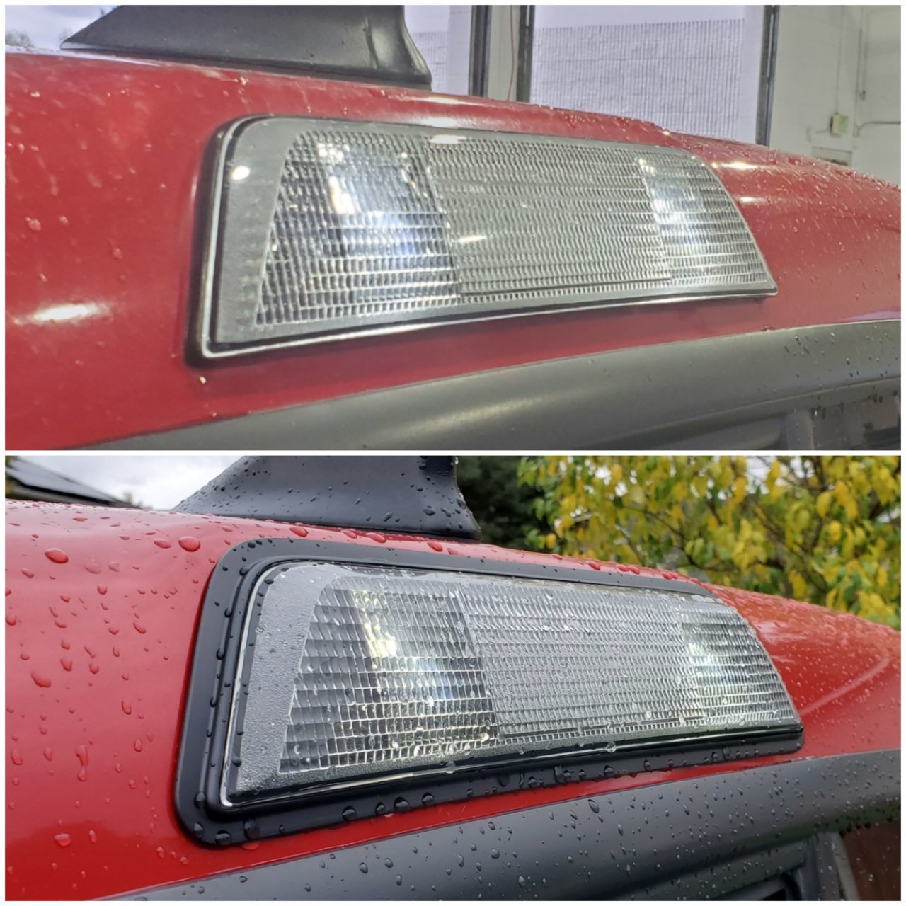

    #316
    number1stunna
    number1stunna Active Member
    Sep 10, 2017
    #229630
    42
    2016 TRD Sport
    Before and after

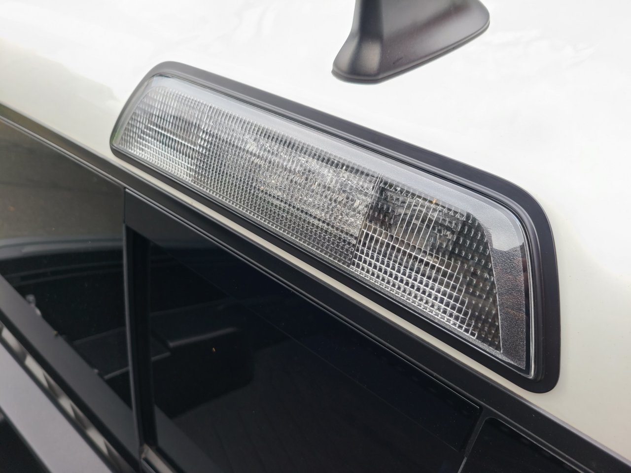

  17. Oct 9, 2021 at 7:21 AM
    #317
    Anton338
    Anton338 Ill-Known Member
    Oct 10, 2010
    #44454
    298
    Anton
    New Jersey
    2018 TRD Off-Road DCSB
    Mostly electrical shit that nobody cares about.
    Hey check this out. Just got my brake light replaced and I, too, noticed a dead bug in there while inspecting the repairs. I guess the trim ring kit doesn't call for blowing out the lens housing.
