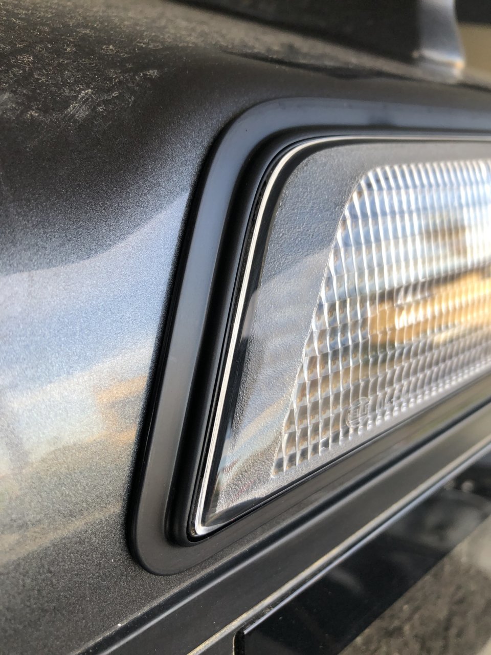

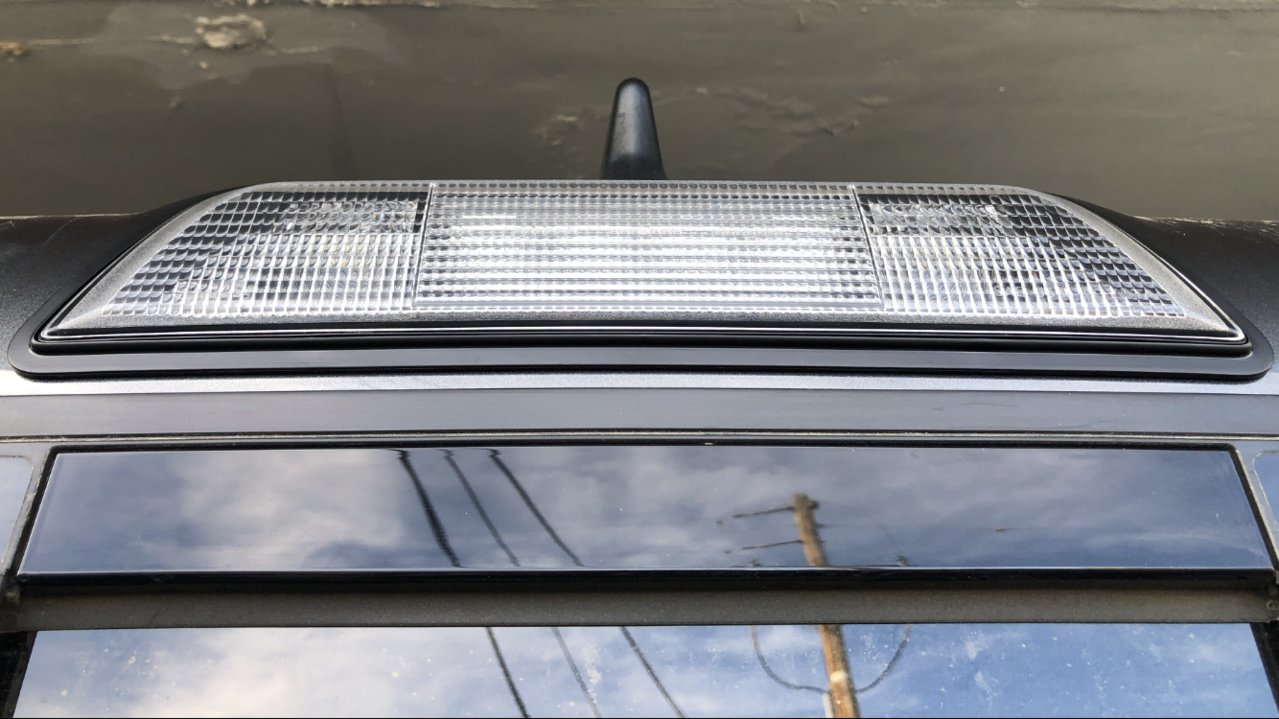

    Funny, last week I got the letter for this and Friday I went to my dealer to get this over with.
    It said if there was no leak they will change the gasket and if it leaked they’d replace anything that was damaged.
    The new gasket is very different.
    I haven’t gone through a car wash yet to test it.

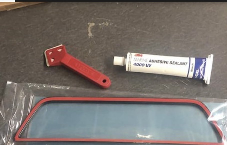

    This is also how I feel. I initially took it to the dealership but they said my Meso hexrack would have to be removed so they could inspect the light. I assured them that if my truck was leaking I’d know it but they said the headliner had to be dropped in the rear for an inspection and they couldn’t install the trim ring without inspecting it first. I left and ordered the part myself. I’ll do a better job anyhow.

    It looks like it’s more than just a surround, the light is sitting on top of it.

    They silicone around the factory light and use a stick on trim ring. The trim ring does not require the light to be removed.
