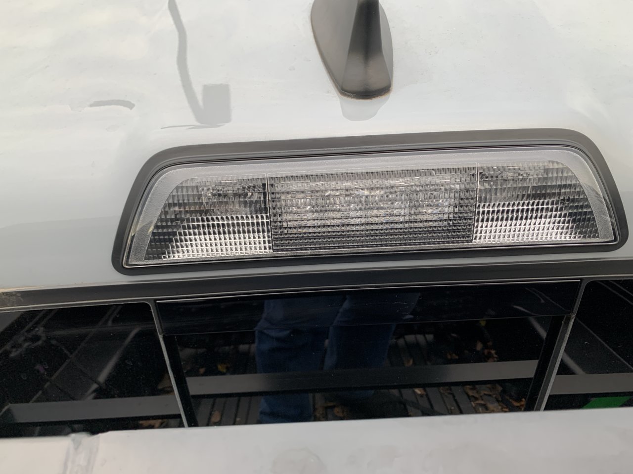

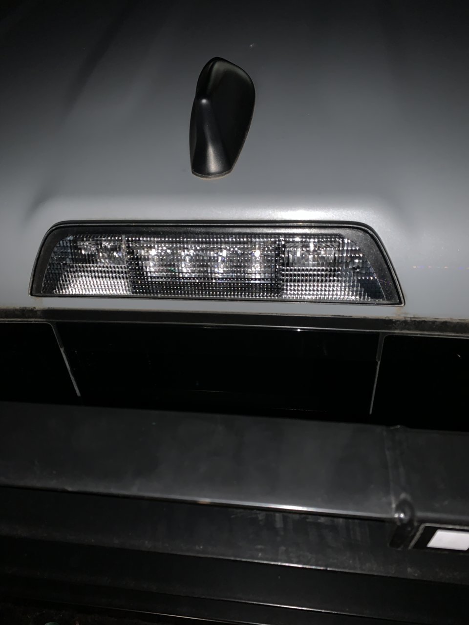

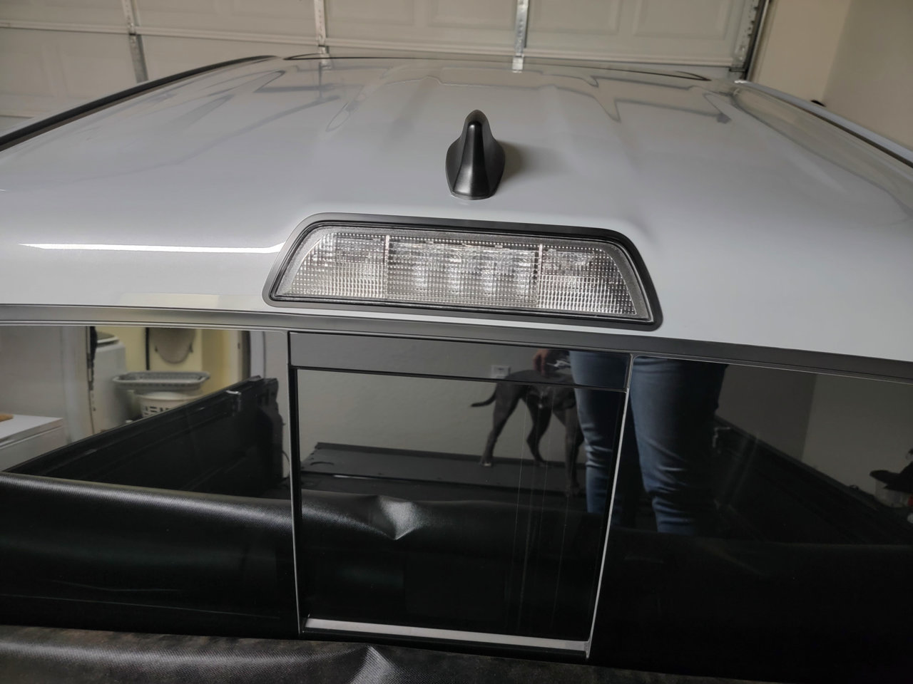

    Same as both of you. The past few times I was in the service department, they kept making comments my truck is "highly modified" and trying to get me to say we go off road and such. I'm done with them. I bought some silicone, bought the new trim piece to fix it myself, and called it a day. No water leaks so far (I'm in AZ) so not worried about the inside.

    The new gasket is considerably wider than the old one.

    This is after I put in the new one. Ordered from Olathe Toyota.

    Yup, that's the new one.
