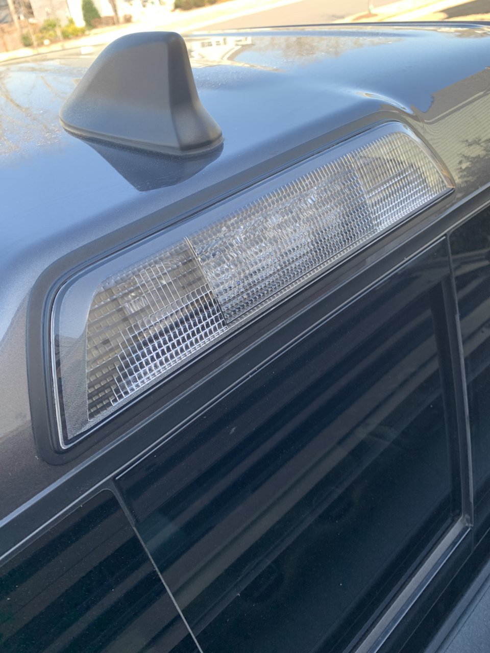

    Spent about an hour at my local Toyota dealer for the service campaign. No water intrusion apparent. Good news. So the procedure was to apply sealant around the perimeter of the third brake light and add an additional bezel. Not a new gasket. The light is not removed.IMG_1860.jpg

    Very strange. I just received my vehicle back, plenty of mold so per the official Toyota guidance, headliner was cleaned, new foam for seats, etc. a new third brake light was installed, not the fix kit. Kind of weird how it’s still the same shitty design as the old one which has plenty of obvious gaps and once the foam gasket degrades again, same thing is going to happen. The gasket appears thicker than the stock one, but you can see it. The fix kit at least addressed this gap with the bezel (that up you can clearly see looks much better in the post right above mine)

    Hope the "band aid" fix by Toyota with the exterior sealant and bigger bezel is a "good" fix. Time will tell.
