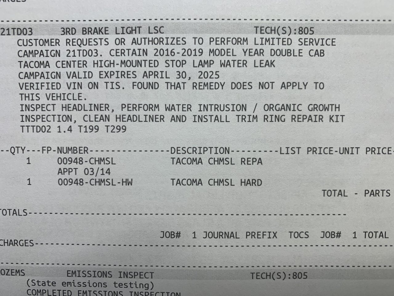

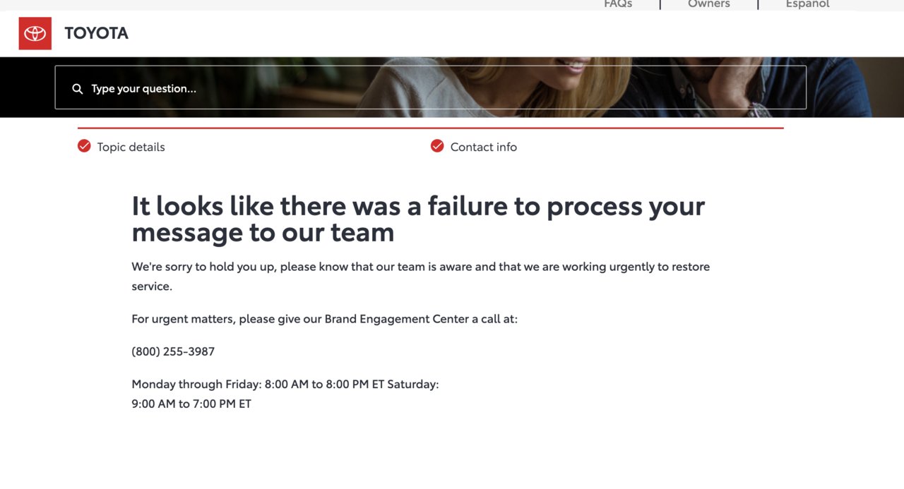

    So I got the letter and information about how to submit for reimbursement. I go through the steps, upload the documents and then it errors out - twice. Maybe temporary, but seems like maybe they don't want to reimburse anyone. Anyone have any luck?
    Oh, and just as proof of their incompetence, the phone number they give me on their error page is for Lexus. D'oh!
