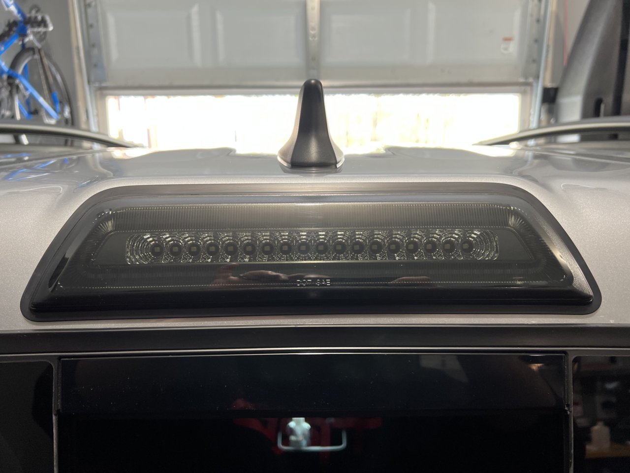

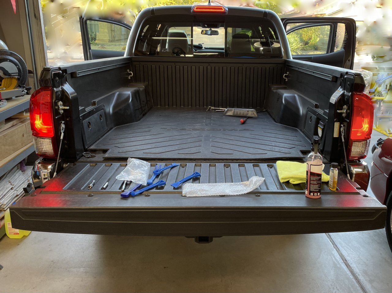

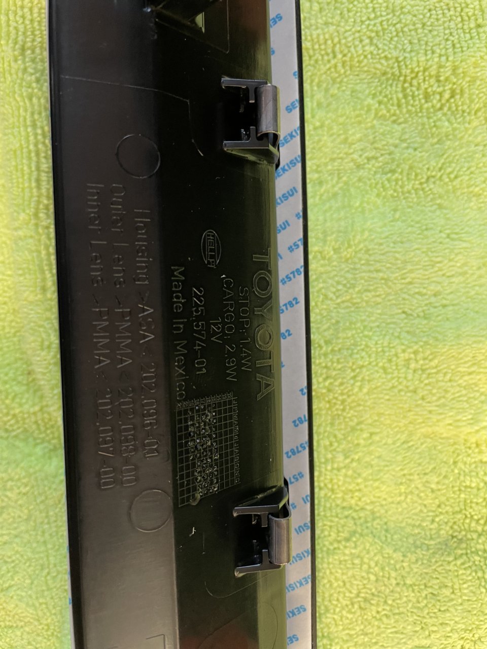

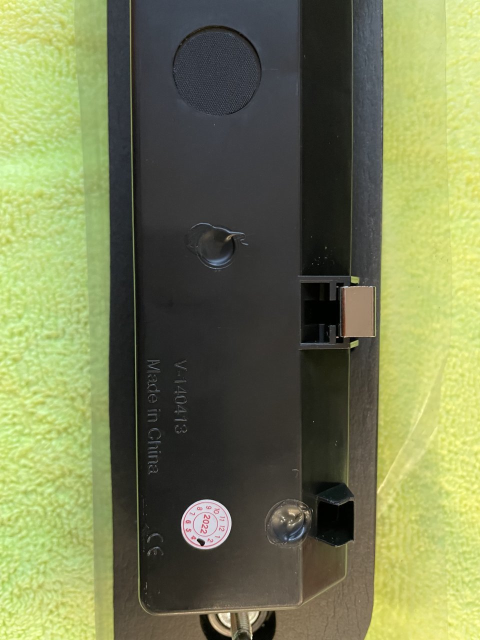

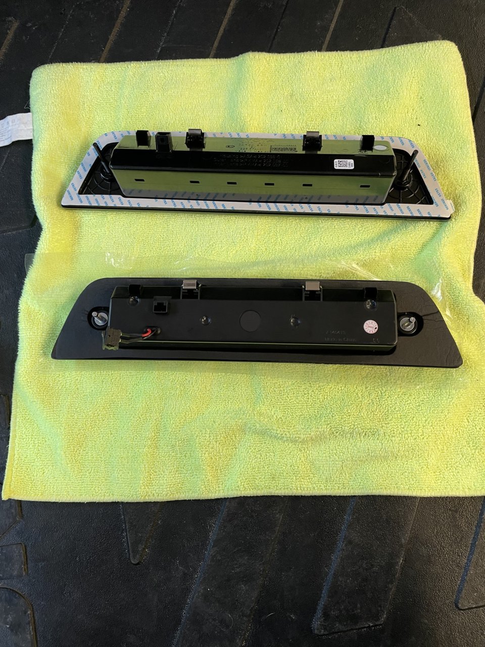

    Update to the @tacomalifestyle third brake light...
    It turns out the trim gasket (00948-CHSML) doesn't fit well with the tacomalifestyle third brake light. No matter how you position the trim piece there's a solid 1/4" gap on one side or all along the bottom. With that said, I removed the tacomalifestyle third brake light and installed the new OEM Toyota light I bought previously along with the silicone (00948-CHSML-HW) and trim gasket (00948-CHSML).
    OEM parts for the win.
    I did email my concerns to @tacomalifestyle about their third brake light not being waterproof and the nut posts being too short making the install more complex that it should be and got a response of "thanks, we'll take that into consideration." So much for customer service these days. :rolleyes:

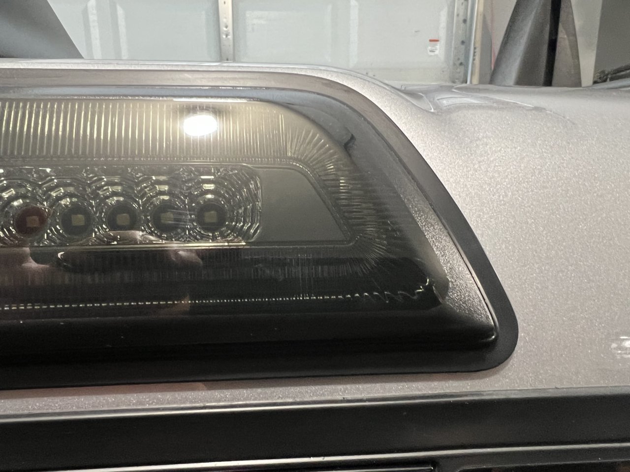

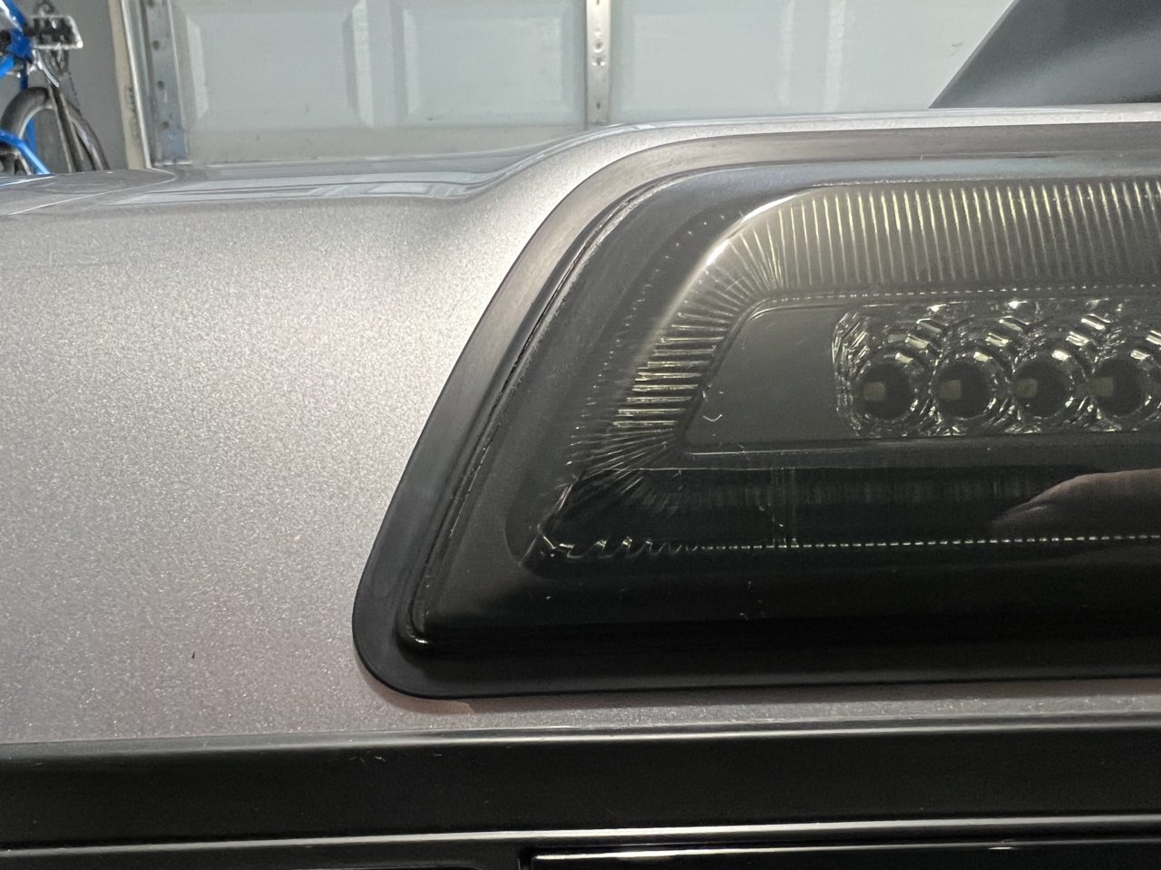

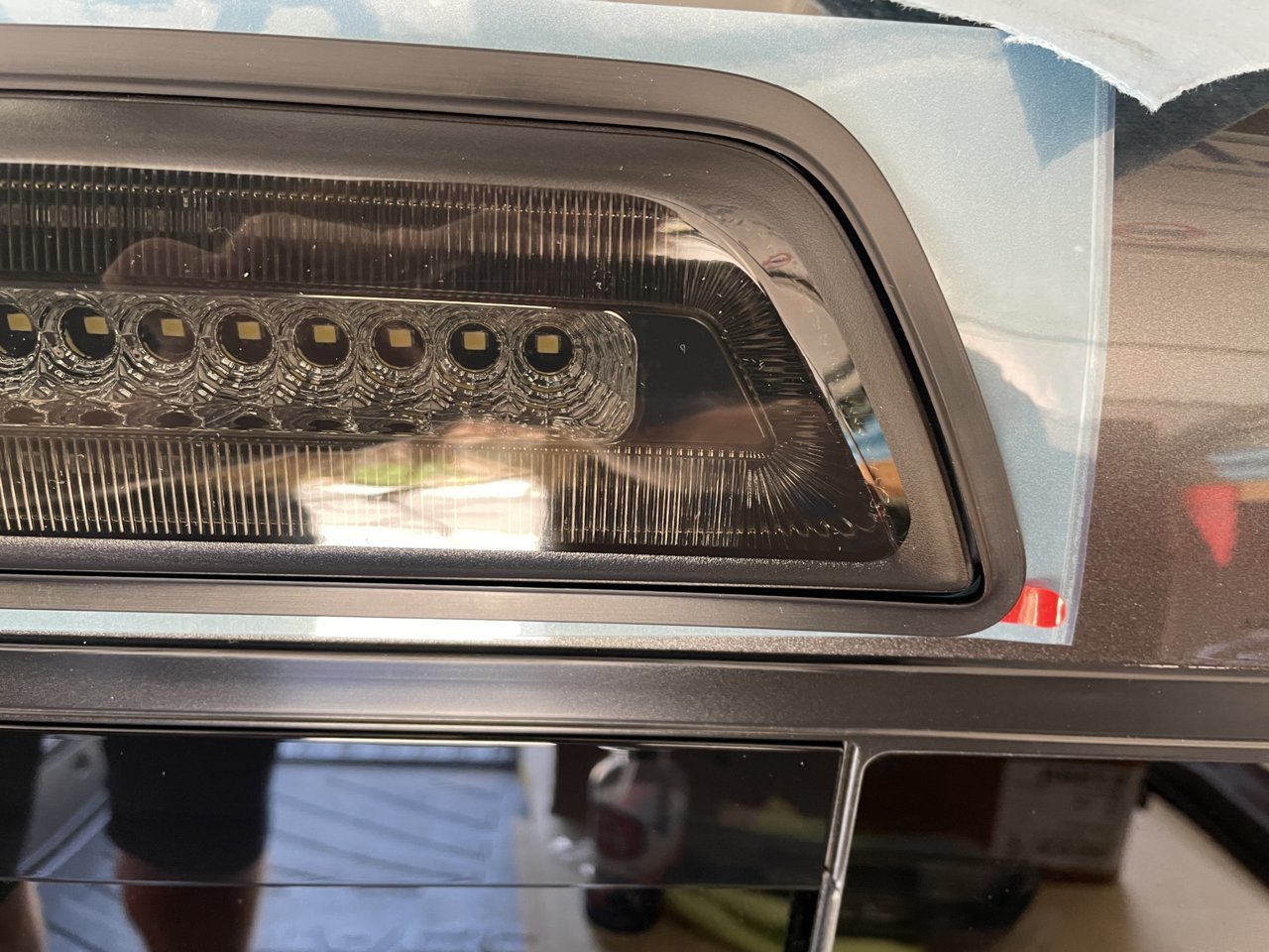

    I had a different experience. Mine does not have the gaps that yours has. Mine was very minor and I sealed it up with black rtv sealant on the outside. I used sealant around the edges before I put the trim on and then on the trim itself where the minor gaps were. Hopefully I won’t have any leaking issues.

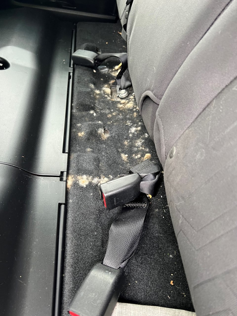

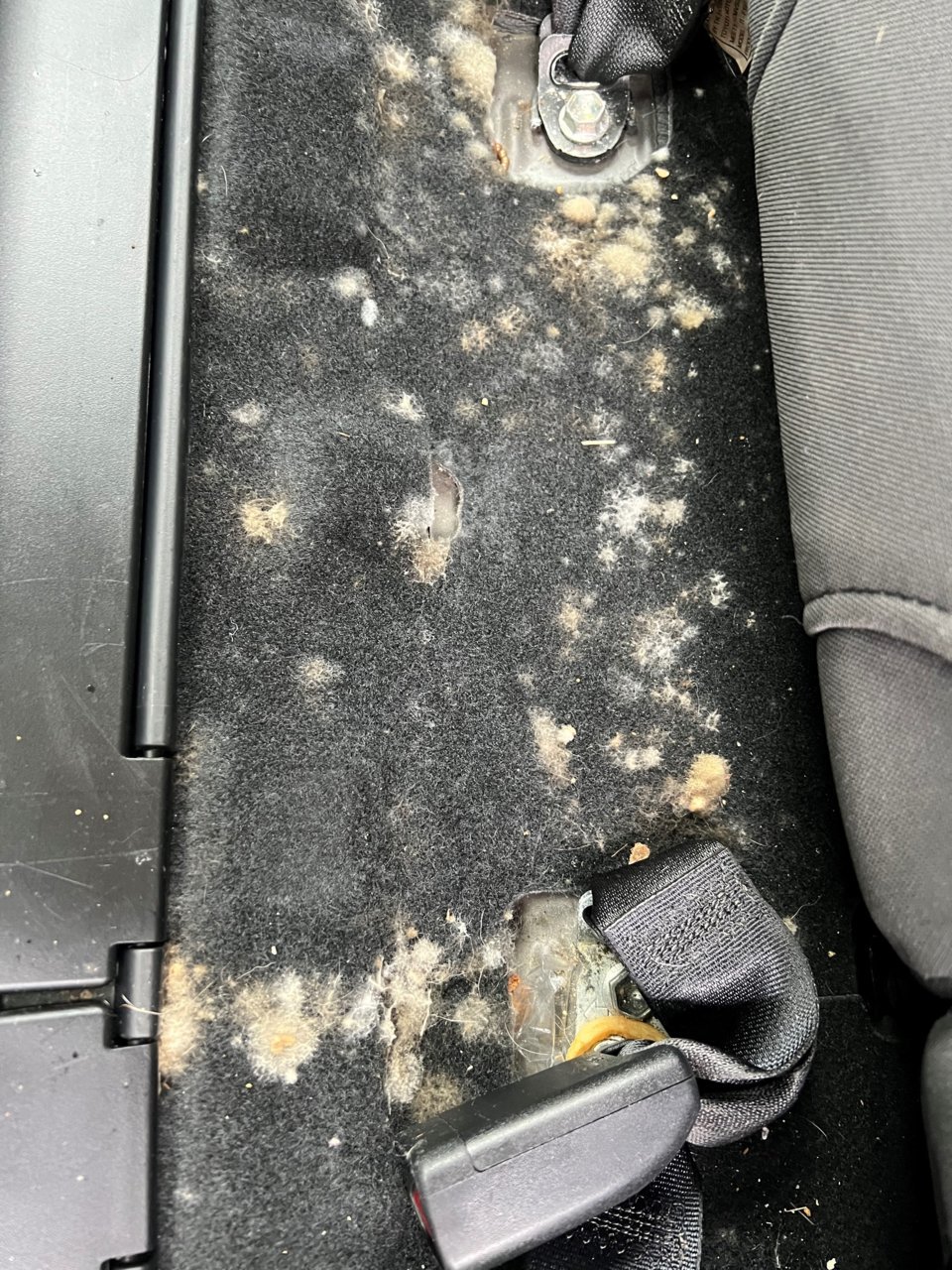

    Welp, it happened to me.
    The inside of the truck has always smelled when the temp gets high. Always thought the owner before me had left the windows down or sunroof opened. I have used quite a few air fresheners but they only temporarily mask the smell. After seeing the issues on TW with the light, I decided it was time to do some investigating. Took the truck through the car wash last night and its when I discovered water literally poring into the cab. I have to believe there is mold or mildew under the headliner. I opened the back seat and I can see water residue all down it.

    Took the truck in for the brake light fix this morning. Upon inspection, we found the inevitable. The whole interior needs to be gutted and cleaned. ServePRO will be the one doing the sanitizing. This includes headliner, all four seat, center console, dash board and carpet on the floor. Dealership put me in a rental Tacoma, could be up to 3 months they said. Pretty wild stuff.
