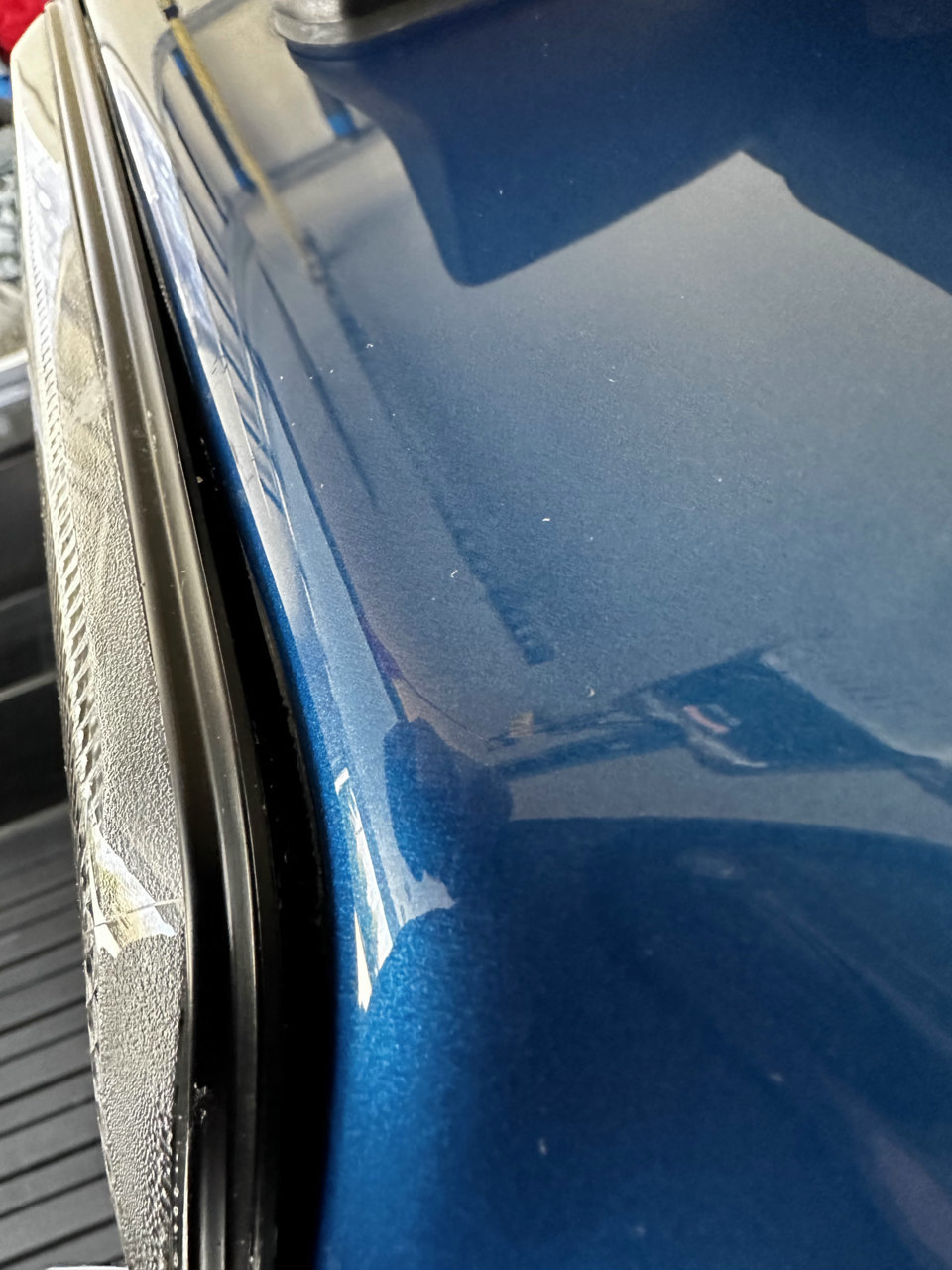

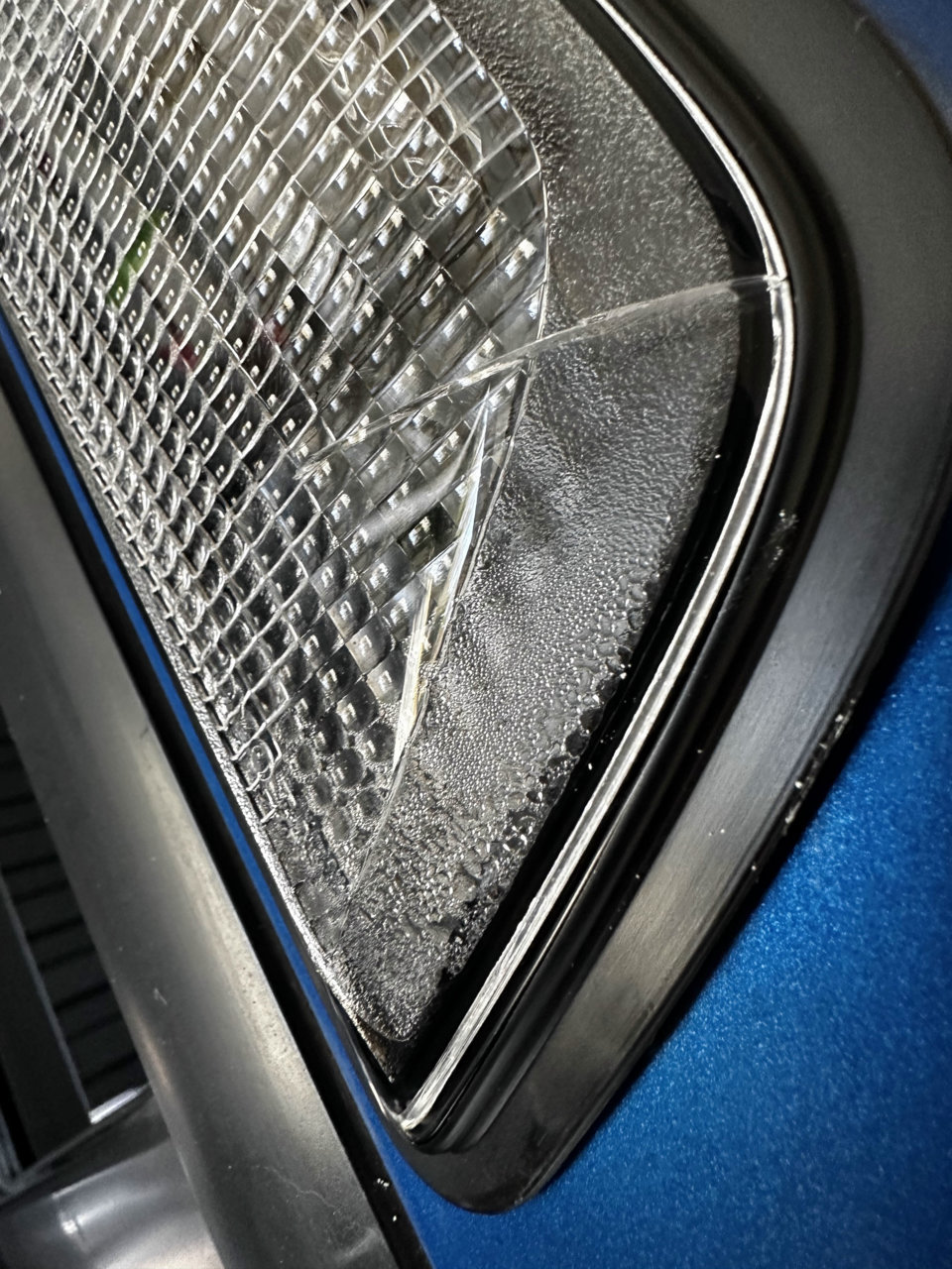

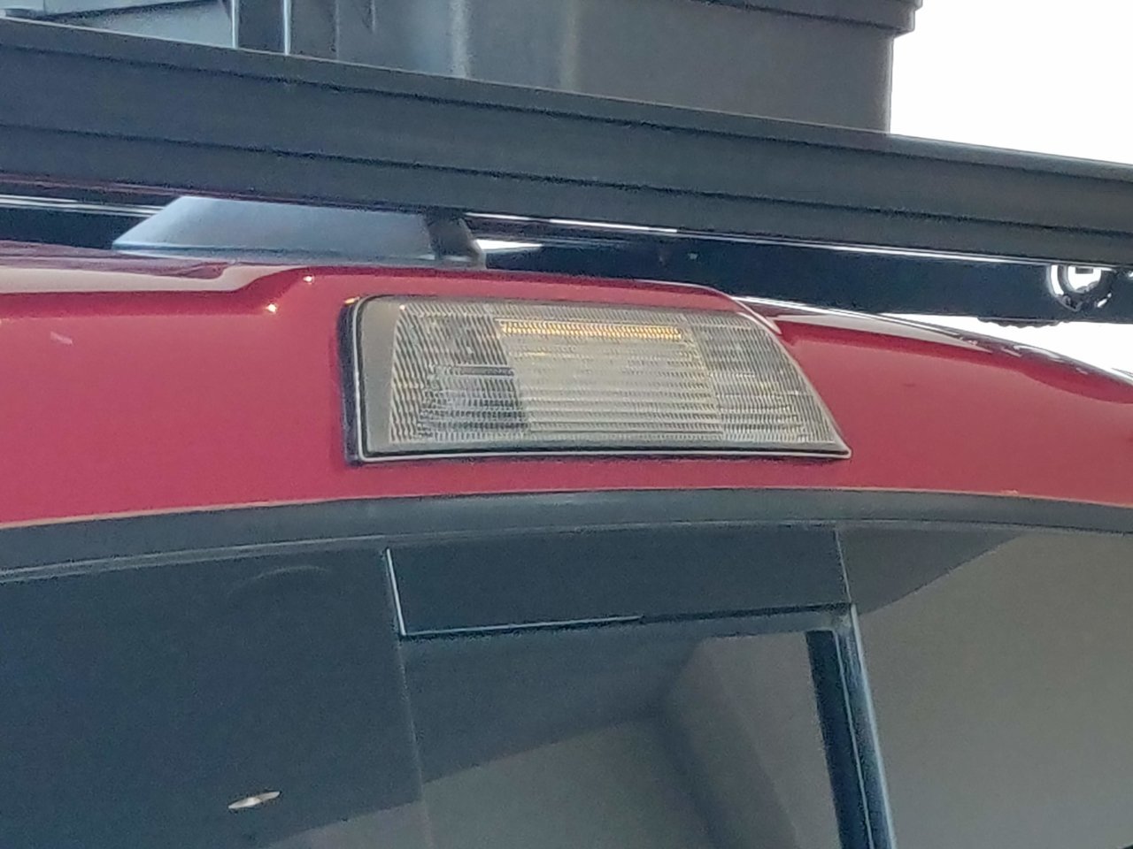

    I just got home from my recall "SERVICE". I had to take off my topper so they could access it. I didn't notice any leaking or staining but wanted it checked out. They sent me home and didn't say anything more other than "you're good to go. No leak evidence". When I got home, I noticed, the lens on the light was cracked, moisture was inside the lens and the housing was partially pulled away from the cab. If it wasn't leaking now, it will be next time it rains! I called the service advisor to ask him what he did and told him it was cracked. His technician had noted any cracks when it came in. So he tells me the technician DID notice a crack (yea, right) and put some silicone around the light to make sure it's leak proof. I don't think that is all they are supposed to do. ??? I think they are supposed to install a new gasket; aren't they? 40BC5543-6448-46C4-A4C2-E718281CA2F6.jpg

    mine was cracked in the exact same place - the service dept. rejected me for the special recall service as they said there were no signs of leakage. Then they proceeded to tell me they could replace the cracked lens and add the external cover gasket/bezel for a small fee (edit - $150 in parts for new light, bezel and sealant, and $350 in labor so more like $500 which is a rip off). I told them to f off - bought the lens/light on-line and did the install myself. Wanted to do the cover gasket/bezel too but they refused to sell it as they said it can only be sold as part of the recall work (bs). GL.

    There's no "gasket" What they do is put a bead of sealant (comes in the kit) Around the light then place a bezel piece on that to cover it up. They do this if they find no leaks. It's hard to tell from the picture if they installed the extra bezel. Did the tech note a crack or not when it came in. You said "had noted" which sounds like a typo. So what was done? Sort of confused here. You make it sound like you brought it in for the recall and they didn't find any leaks so ONLY because it was cracked did they put silicone on it then sent it down the road.
    SO was your truck apart of the recall? If not then, I guess you're SOL, as shitty as that sounds. If you got the updated part # of the light, it should have the updated gasket, as far as I know.

    yep, was part of the special recall. It was the bezel they would not sell me (my bad on calling it something else). So after I installed the new light (which has a gasket that is way thicker than the one removed) I did use marine sealant. Pretty sure the lens was cracked from the factory but I never looked close at it until I got the recall notice.

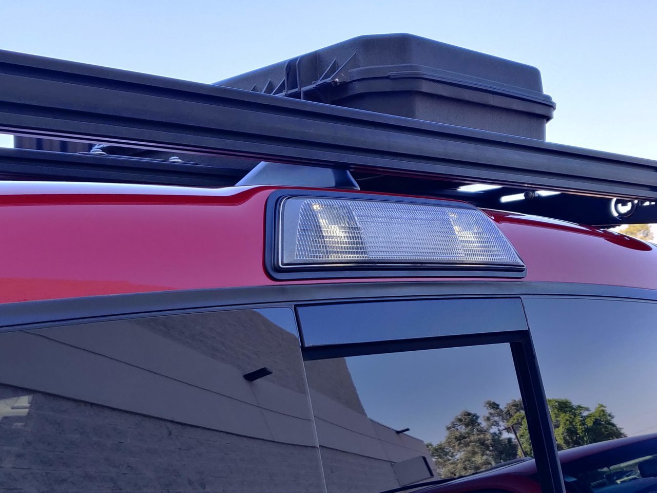

    I need to get this recall done but the dealer told Id have to remove the roof rack first. I cant see why as it does not cover the lens/light…

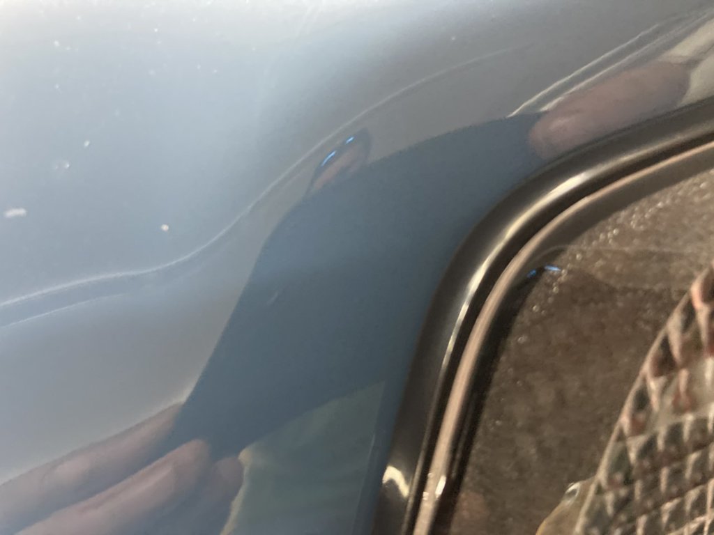

    Yes, a typo. He said he Tech DID NOT make any notations about a crack. The light is pulled away from the cab on the right side. Can anyone tell if it looks like they installed the new 'bezel' on there? 825B313D-0765-442C-9995-EB6817DF7A18.jpg5022BC9E-6A4B-4A98-A82E-954B782FA13B.jpg5022BC9E-6A4B-4A98-A82E-954B782FA13B.jpg825B313D-0765-442C-9995-EB6817DF7A18.jpg825B313D-0765-442C-9995-EB6817DF7A18.jpg5022BC9E-6A4B-4A98-A82E-954B782FA13B.jpg

    That black bezel around your brake light is the "new" bezel. Looks to me that they installed it incorrectly, as that part is simply meant to cover the RTV silicone around the original bezel/gasket.

    Okay, I guess after installation, the bezel has pulled away from the cab by the time I got home. I am taking it back over there this morning to see if they can fix it.

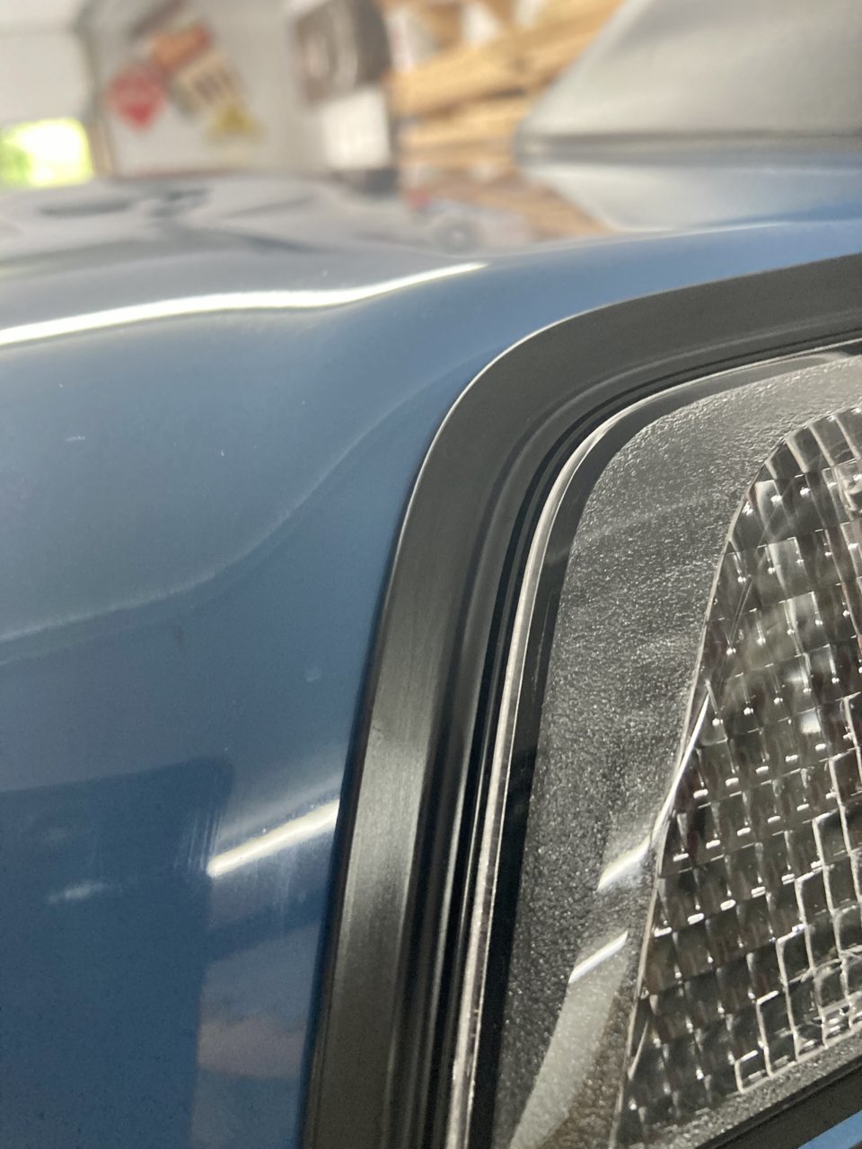

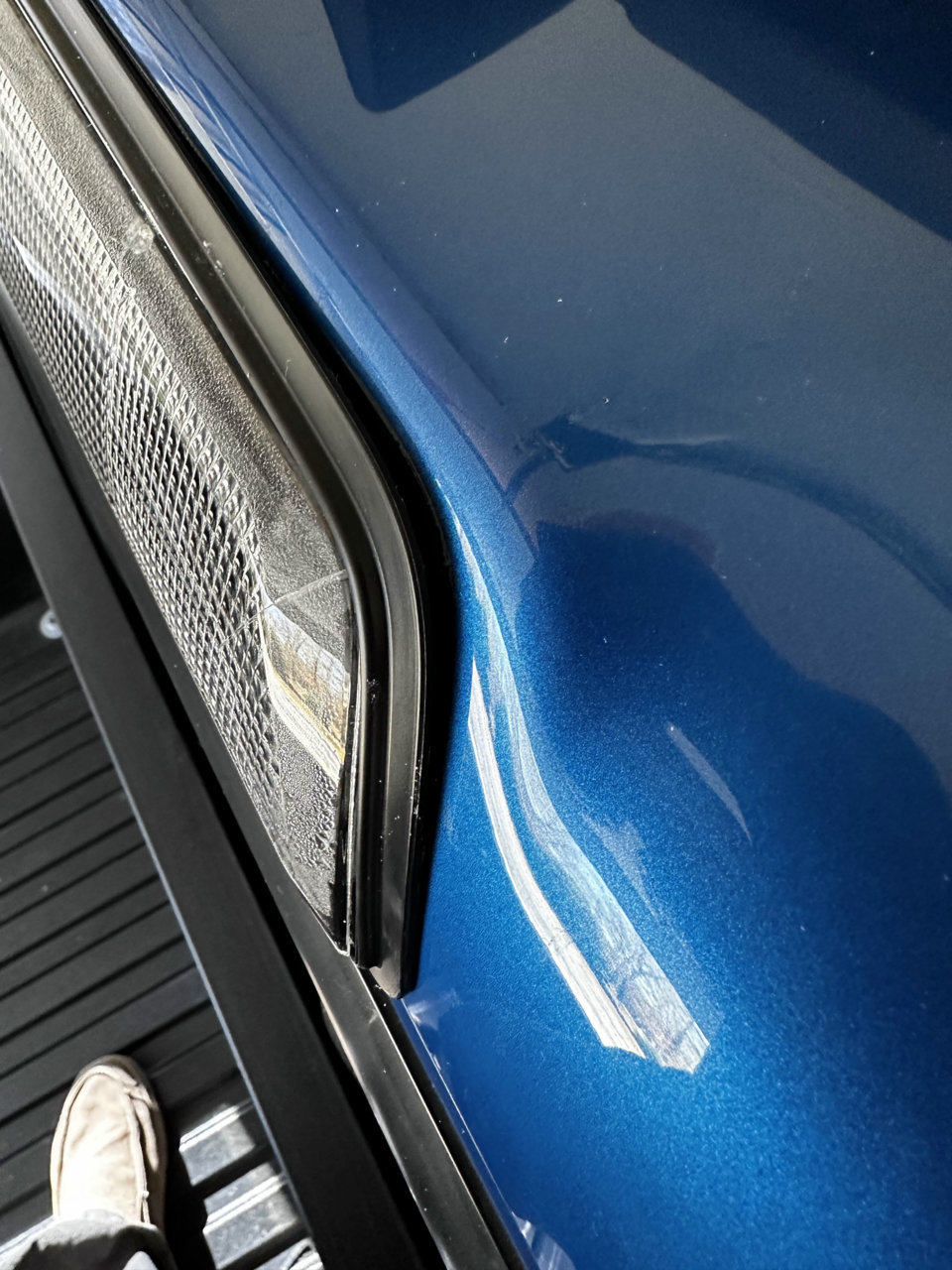

    Before
    After

    The light will need to be replaced to fix it right. See Goldenbrew's quote. I actually thought that was high. I bought the updated OEM light off of ebay for $90. There's some instructions on the internet on how to remove the light. It's not hard. Just make sure you plug the electrical connection in THEN set the light in place. I forgot to put the electrical connection off and lightly set it on the truck and realized what I did and almost compromised the gasket. It's VERY sticky. I still got the recall done just to clear my truck from the list for future buyers.
