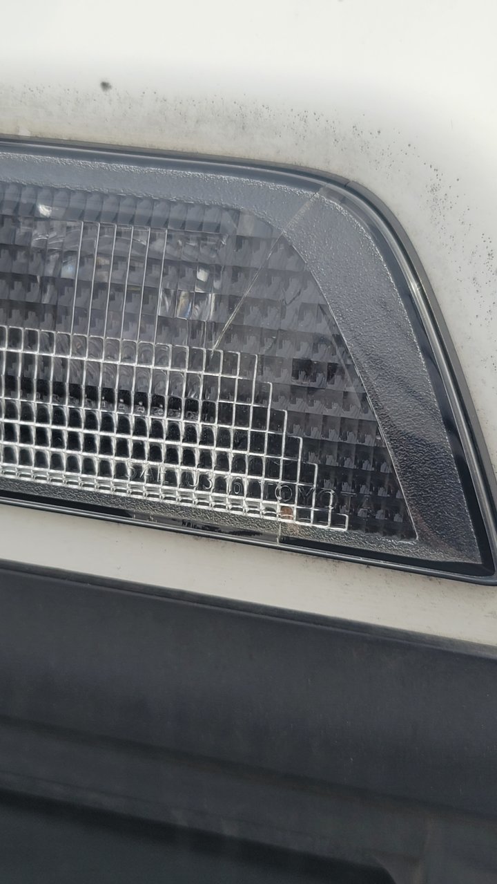

    5
    2016 Tacoma TRD Sport Longbed
    Add mine to the list of Tacomas with the same identical crack in the 3rd brake light. I took mine to a dealership about a year and a half ago to get the leaking fixed and they told me to go pound sand. I'm wondering if anyone has ever had any success on getting this issue fixed by Toyota with the crack? If so I might try another dealer.

    2016 Limited MGM 4X4 DCSB AT
    Damn! Had the same crack in my light and just assumed it was done by the guy who installed my cap. Cost me $300.00 plus so they could go ahead with the service campaign.
