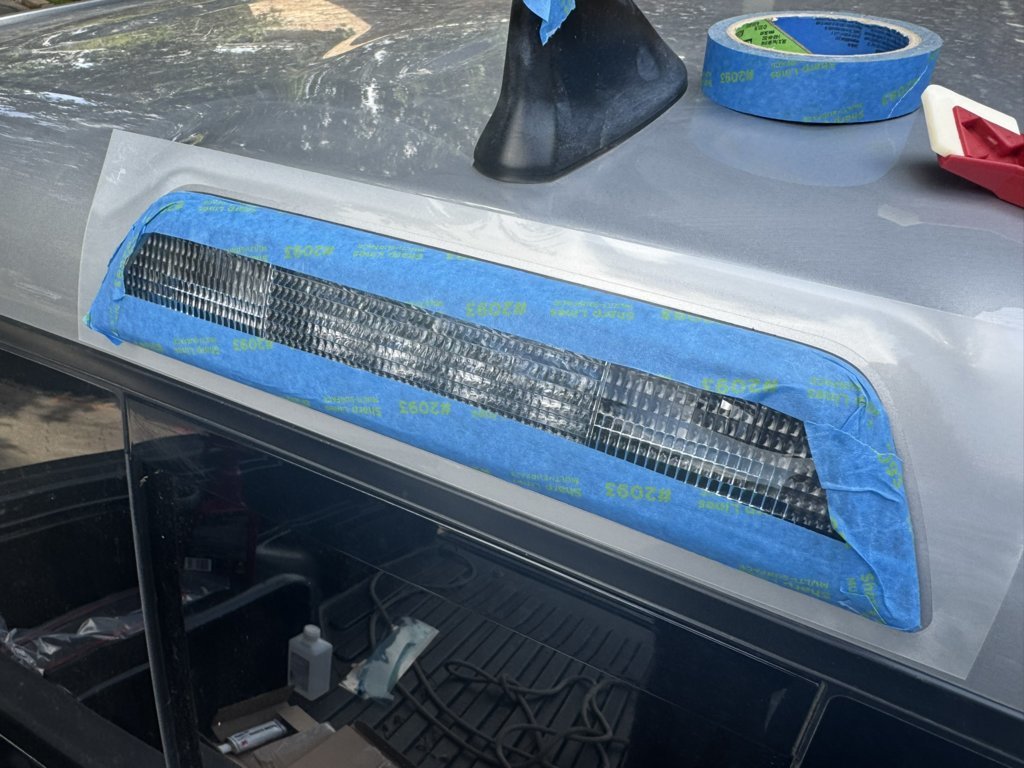

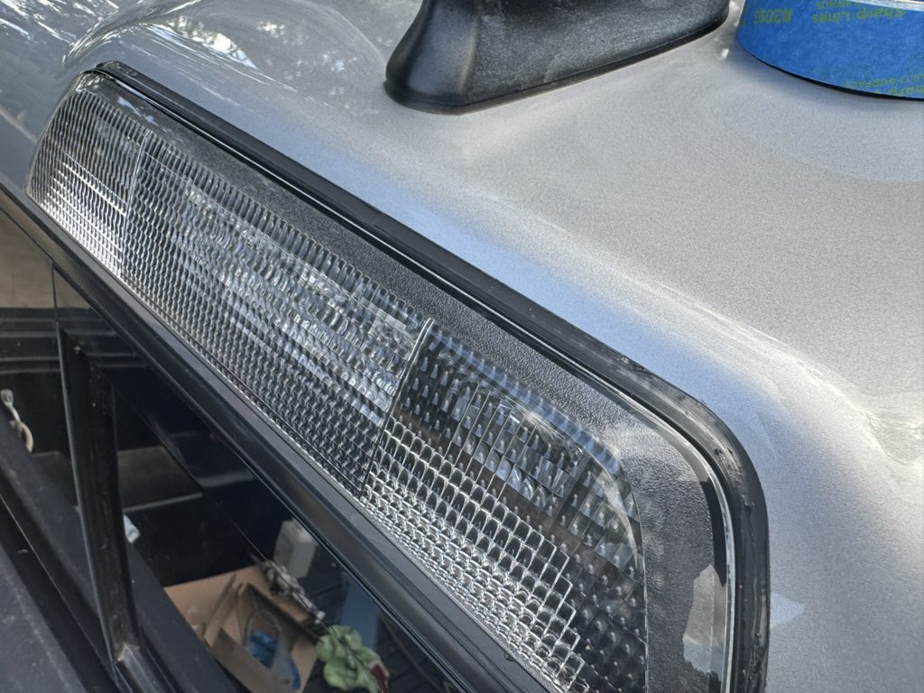

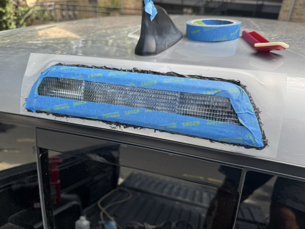

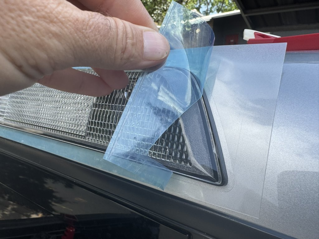

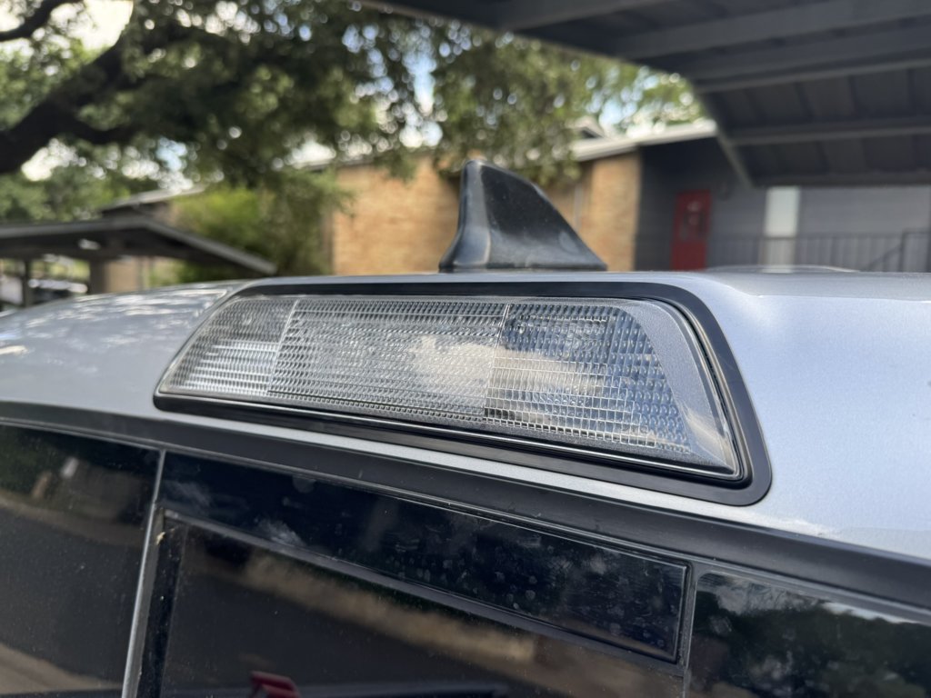

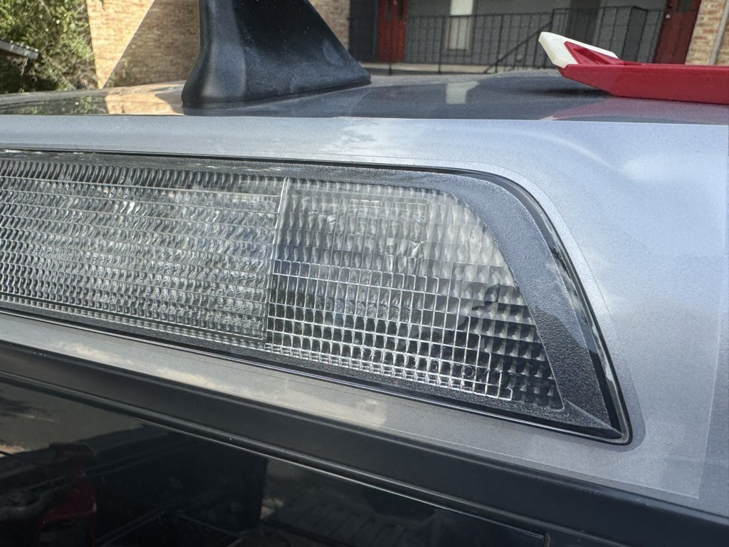

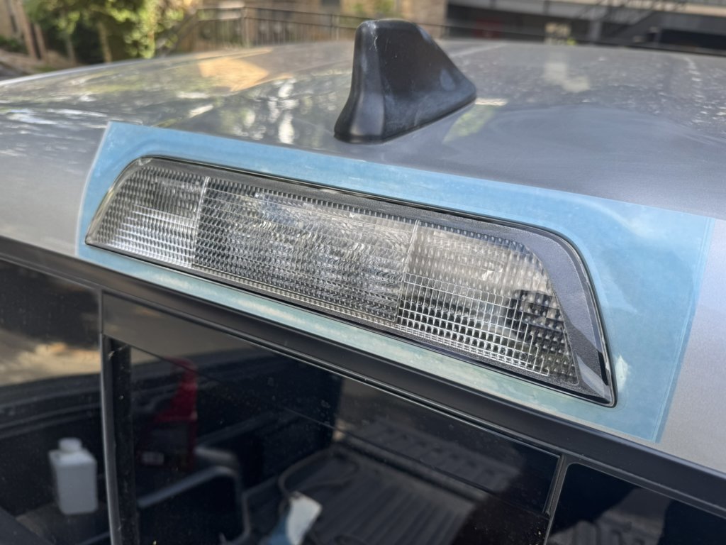

    I just installed mine today. Got frustrated after a false start with the dealer wasting 3 hrs to tell me the ring kit was cracked during install, so I just ordered the parts for $80 and installed myself. My light was just slightly leaking before the install of the ring kit.
    Recommend: wearing gloves (my 3m UV4000 tube cracked and leaked on my hands), and cutting the nozzle wide enough so you aren't squeezing too hard and get a good bead. Overall it was easy, I made a mess of it because of the leaking tube and my nozzle hole too small but the finishing tool cleans it up. Note the nozzle is included with the trim ring and the mask, so you can buy your own caulking finishing tool and tube of UV4000 for less than the dealer or ebay price (I paid $79 for both kits).
    IMG_4220.jpg IMG_4222.jpg IMG_4223.jpg IMG_4225.jpg IMG_4226.jpg IMG_4228.jpg IMG_4229.jpg

    that looks pretty clean
