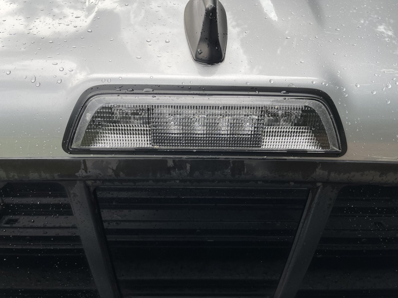

    Toolndie7
    Toolndie7 Well-Known Member
    Mar 29, 2021
    #360924
    192
    2019 Sport DCSB Cavalry Blue
    Found this pic on the web. I've got an appointment for Saturday so I'll see what they end up doing...

  2. Aug 18, 2021 at 4:30 AM
    #102
    HelloFelix
    HelloFelix Well-Known Member
    May 15, 2020
    #328097
    340
    Felix
    Las Vegas
    2017 MGM 4x4 OR Tacoma
    Come on trim ring part number .

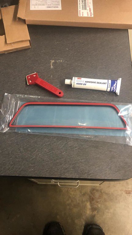

  15. Aug 19, 2021 at 2:28 PM
    #115
    TSmoove
    TSmoove Well-Known Member
    Oct 3, 2017
    #231890
    596
    Trevor
    Atlanta, GA
    2017 Tacoma
    Just had mine done. 3 hours, to clean headliner, small leak that hadn’t made it through all the way, sealed, and exterior gasket. 37D10364-9A31-4FBD-8D0A-76640AEC6D51.jpg

  16. Aug 19, 2021 at 3:20 PM
    #116
    HelloFelix
    May 15, 2020
    #328097
    340
    Felix
    Las Vegas
    Haven’t found it for sale, anywhere. PArt#. 00948-CHMSL

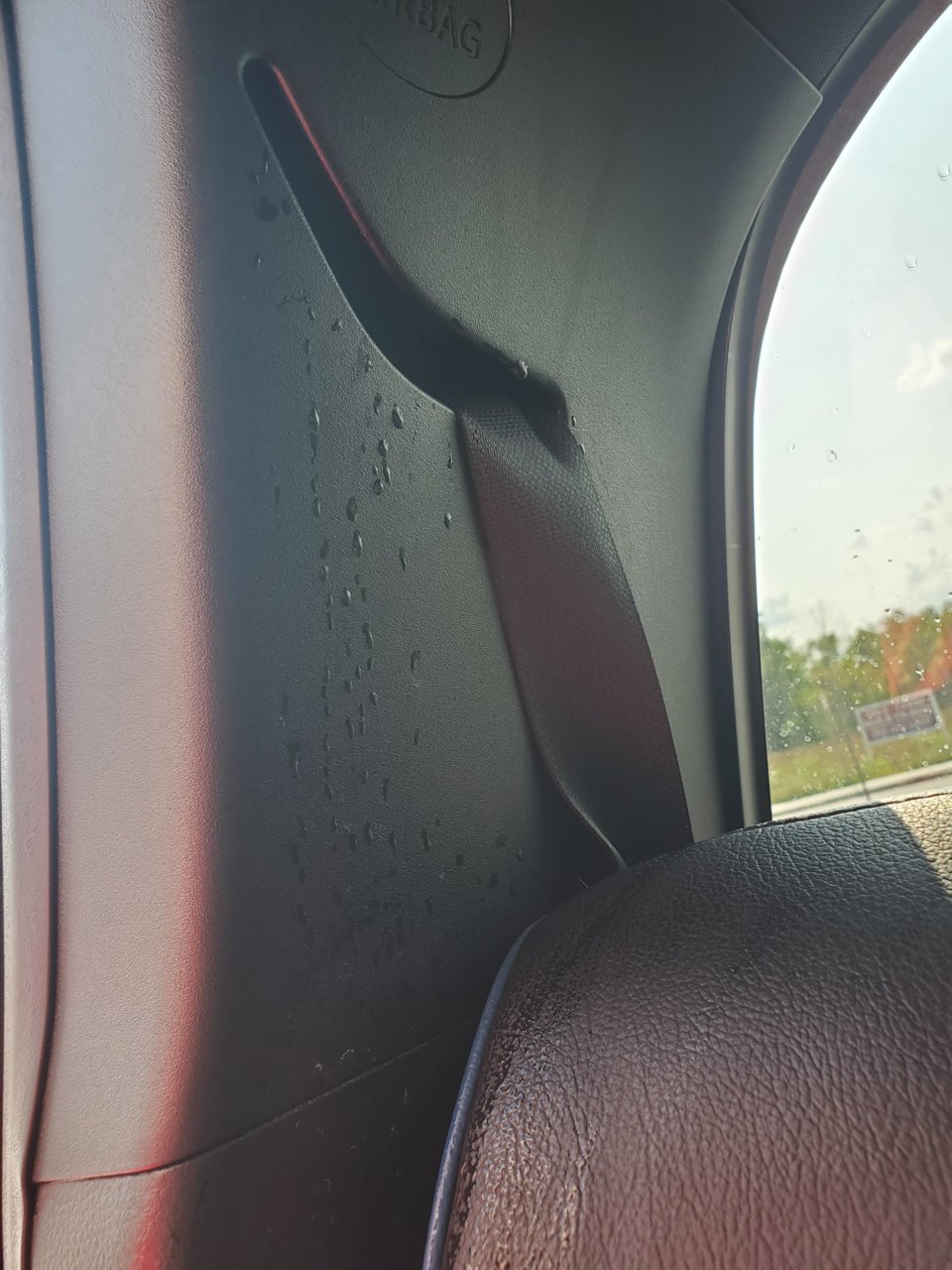

  18. Aug 19, 2021 at 4:45 PM
    #118
    Aqualoon
    Aqualoon More stickers!
    Jun 22, 2016
    #190263
    1,452
    Minnesota
    2019 Off-Road DCSB Cavalry Blue
    Just went through the car wash and went to vacuum right after. Saw water on the back passenger side. I wasn't having issues before but I am now...joy!

  19. Aug 19, 2021 at 5:11 PM
    #119
    Pongo
    Pongo Well-Known Member
    Mar 15, 2021
    #359427
    59
    Scott
    2016 Inferno Tacoma TRD Sport
    This was after you had the service done?
