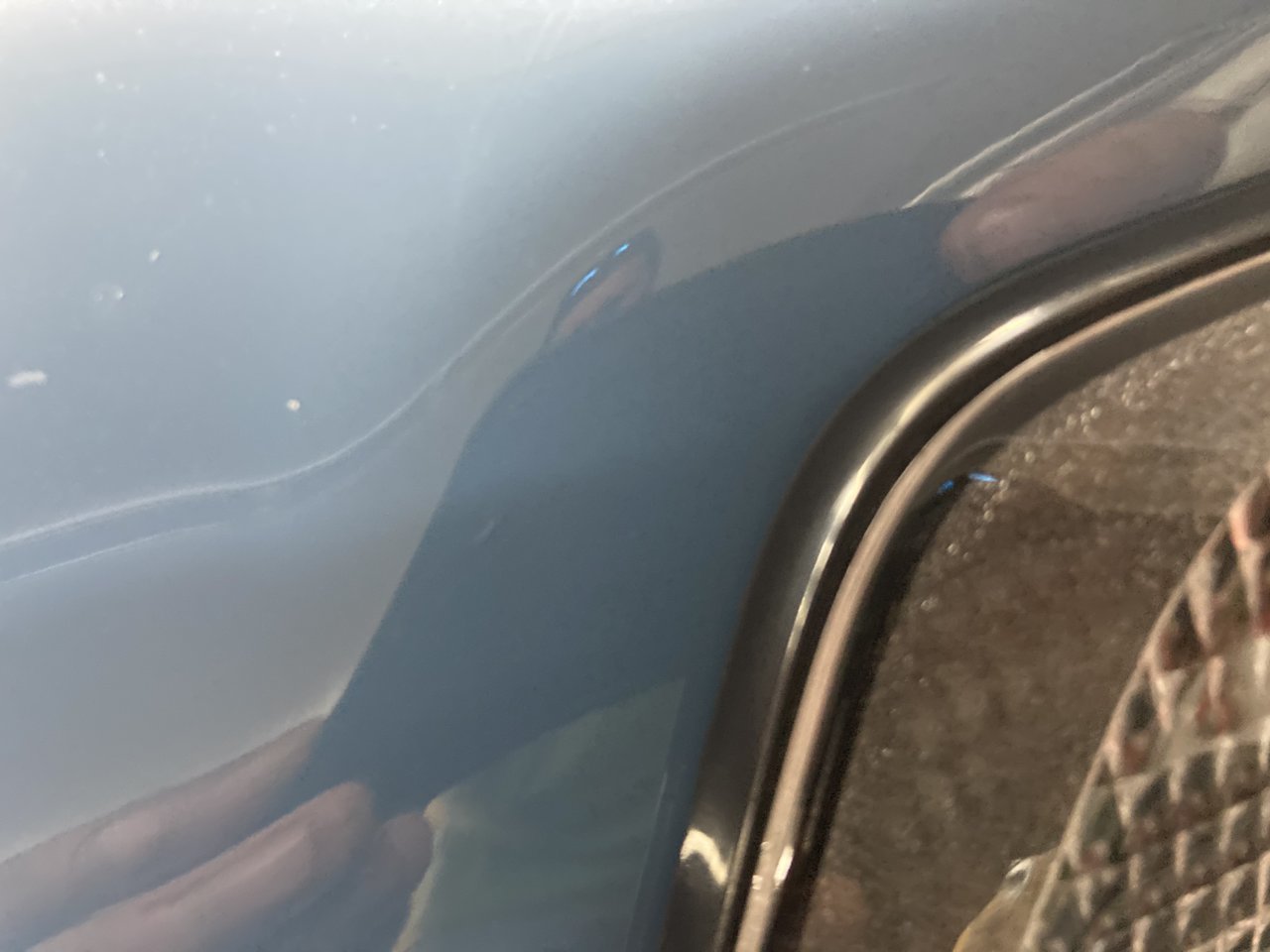

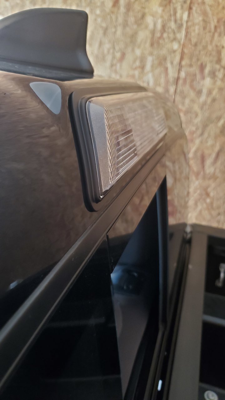

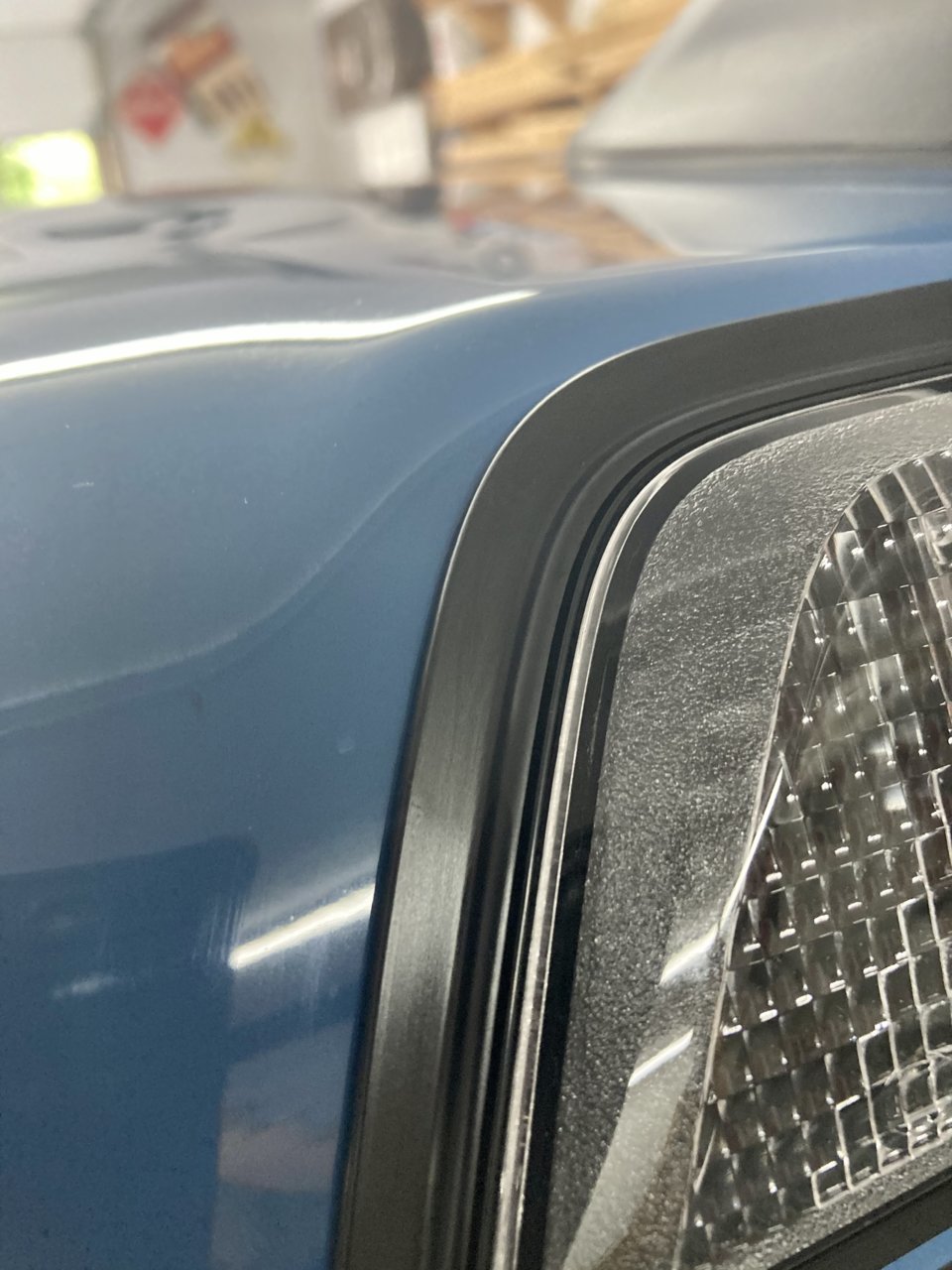

    Just had mine done this morning. Had no leaking but figured I’d get it done anyway. Took less than an hour. Here’s a few before and after pics. Dealer noted to not wash vehicle for 24hrs
