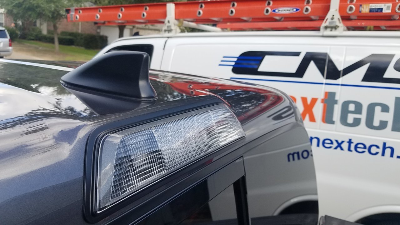

    I had to go in to the dealer for a battery replacement under warranty. When I scheduled the appt, the scheduler told me there was a recall for some kind of leak. Nothing else. So I rolled in with my bed rack and rtt on. When I got there, they told me the recall was for the third brake light and they won't be able to work on it with the rack on my truck. Had to reschedule that. At least I got a new battery out of that visit. Had some bad weather soon after so I took it back in without the bed rack. Never had any leaks but I also live in the desert. Took them about 90 minutes.

    Just chiming in that I had my light fixed under the bulletin just this morning. I was advised it would take up to two hours, had it back in about 40 minutes and the light now has the bezel just as the other photos show in this thread.
    No damage done and nothing seems out of place in or around the cab/light.

    Mine was done yesterday, done in under four hours. Like Shaggy135's pic above, there is now a plastic ring around the light. Looks like they redesigned it in order not to leak (hopefully). Mine didn't leak prior to taking in.
