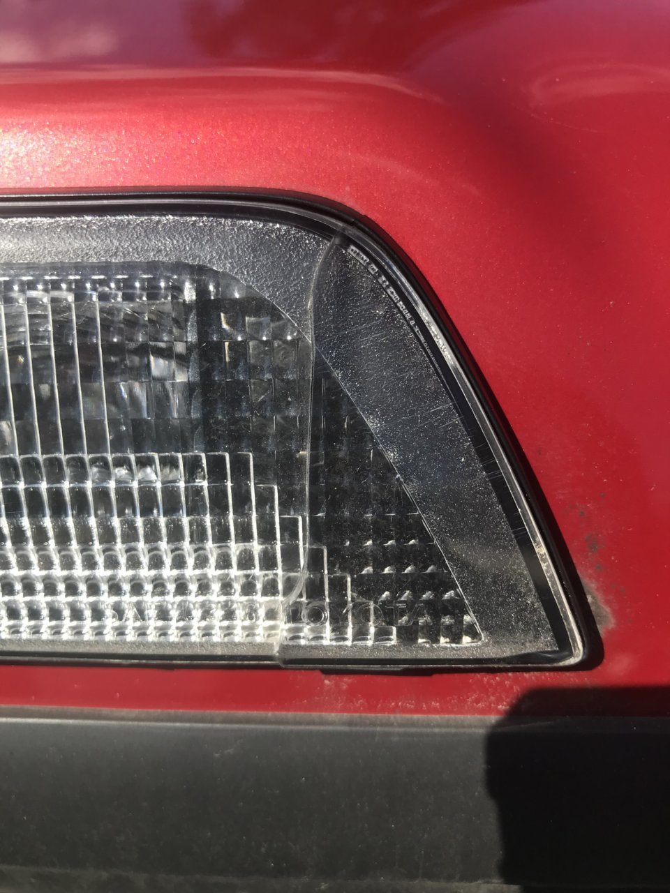

    The 3rd brake light recall is supposed to apply to my 2016 Tacoma. When I went to the dealer they said it is not covered because there is a crack in the lens. Well the only reason there is a crack is because water got in there and apparently froze last winter cracking it. There was nothing in the recall notice saying they won’t cover it if the lens is cracked. The dealer says Toyota won’t allow them to cover it. I’m so po’d. It’ll cost $1113.86 to fix it. Who do I contact at Toyota. This is ridiculous.

    The recall is for the seal on the light leaking water into the cab of the truck. It does not cover damaged lens. IF the light seal was leaking water in the truck, there is a few different steps they would take. First inspect the headliner for water damage and attempt to clean it. If it can be cleaned, they install a new trim ring around the light and seal it. IF they can not clean the headliner, they replace the headliner and light. Third, is if there is "organic growth" (mold). Then they remove the interior, remove all the sound leading from the floor. Have Servpro remediate the mold. Install new sound deadening, carpet and padding, and whatever else is mold damaged. New head liner if it cannot be cleaned and a new light.

    The Toyota fix doesn't require pulling the headliner. It's simply a flange that's goes over the existing light from the outside. Silicon is used to seal the light fixture, and the flange is pressed over the fixture and "glued" in place. I had it done proactively on my '17, and the fix looked "factory" to me, and not out of place.
