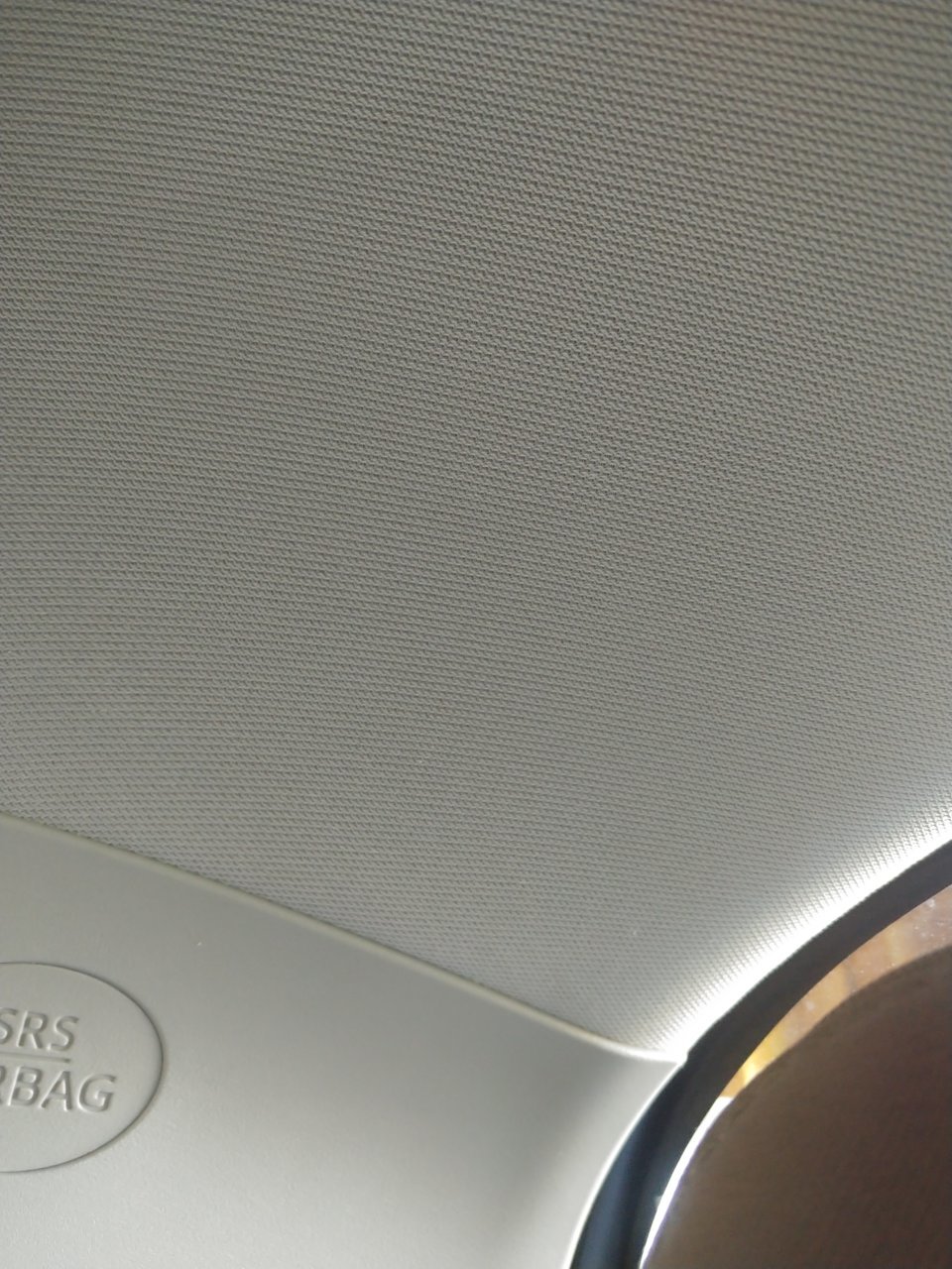

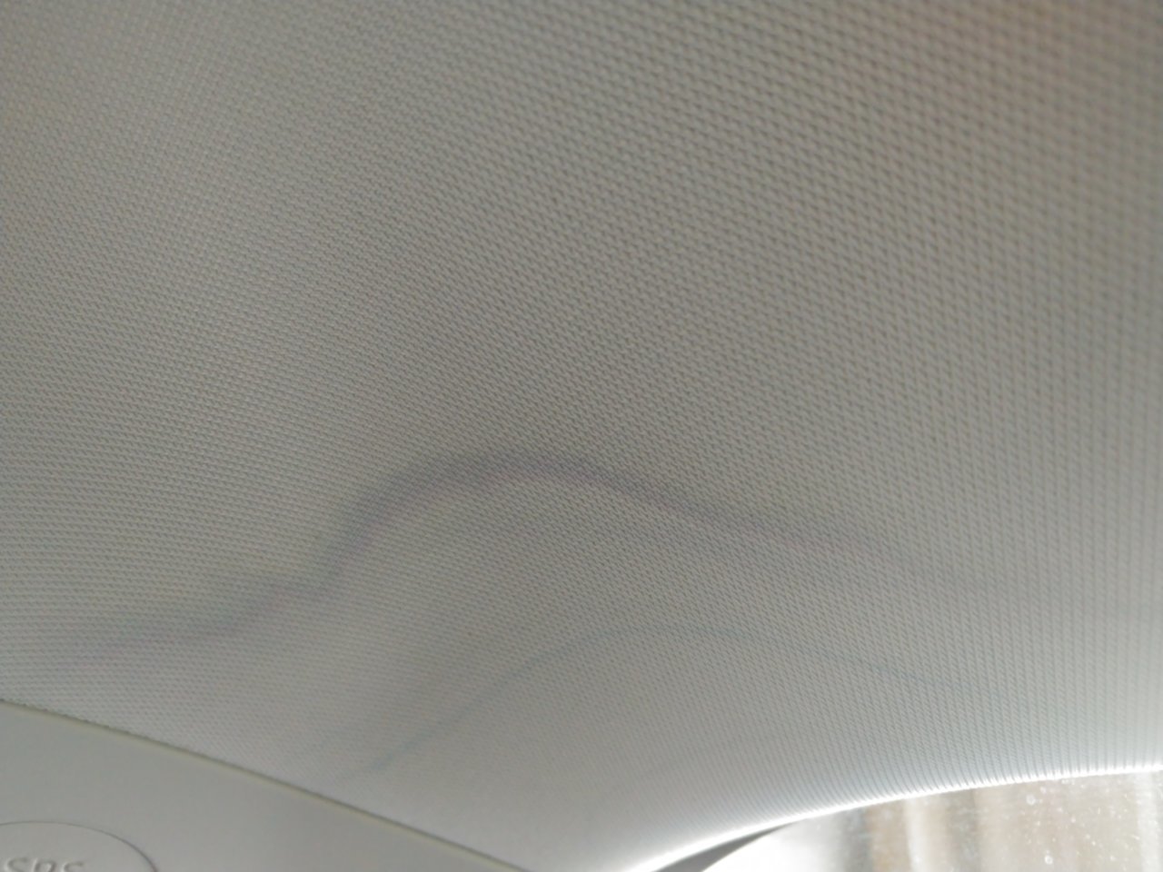

    My friends 2017 is leaking badly as well dealer said its not their problem. Pretty bad water rings on the headliner.

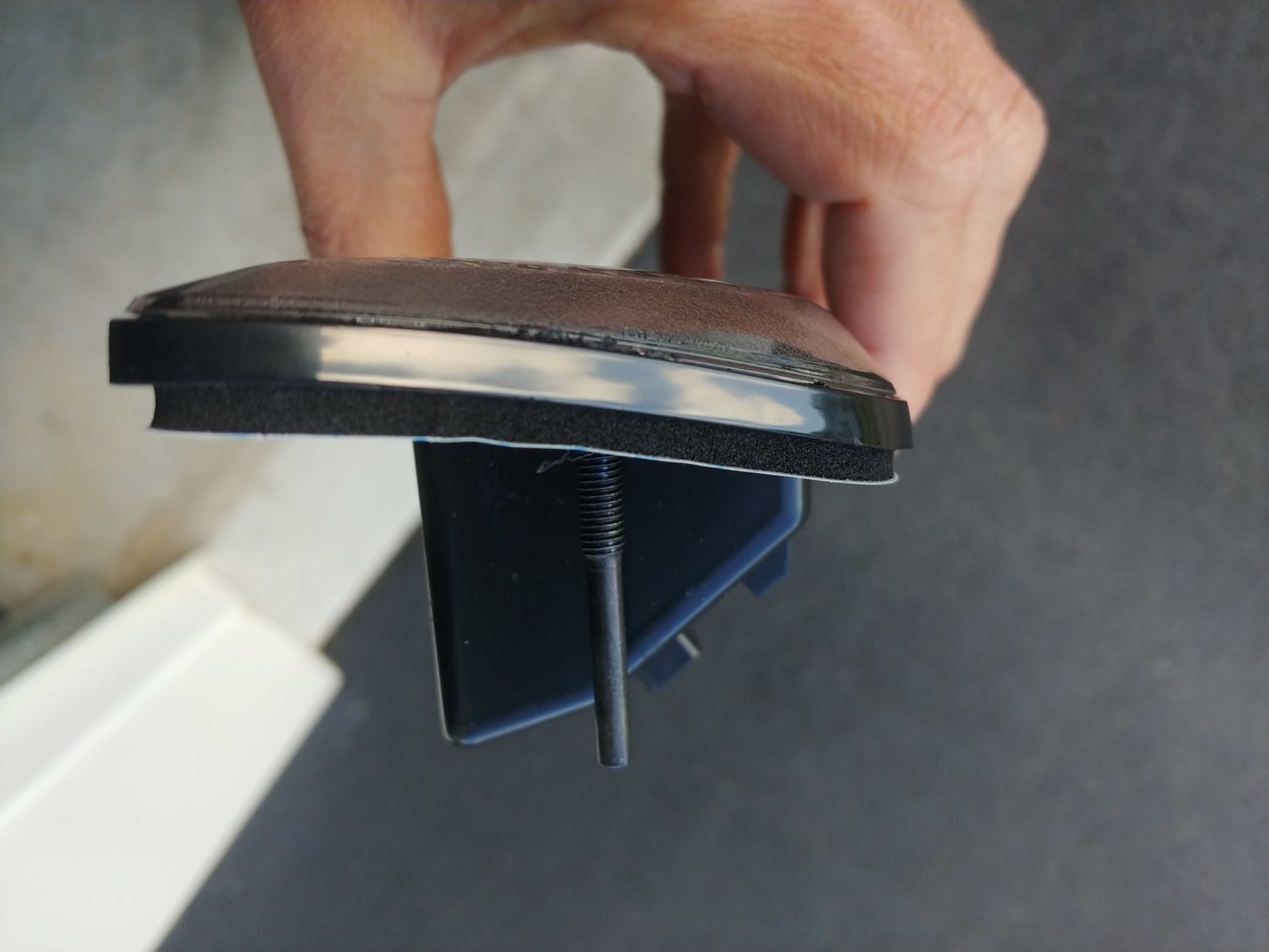

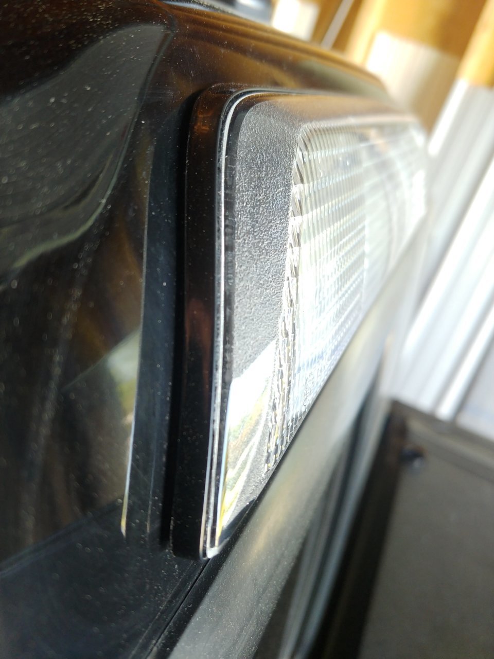

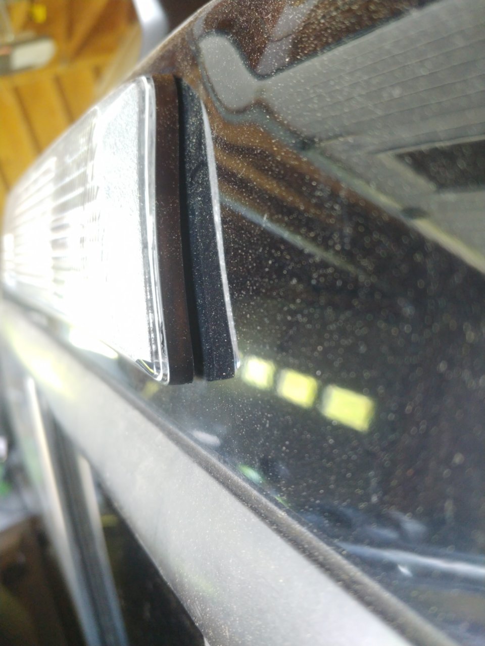

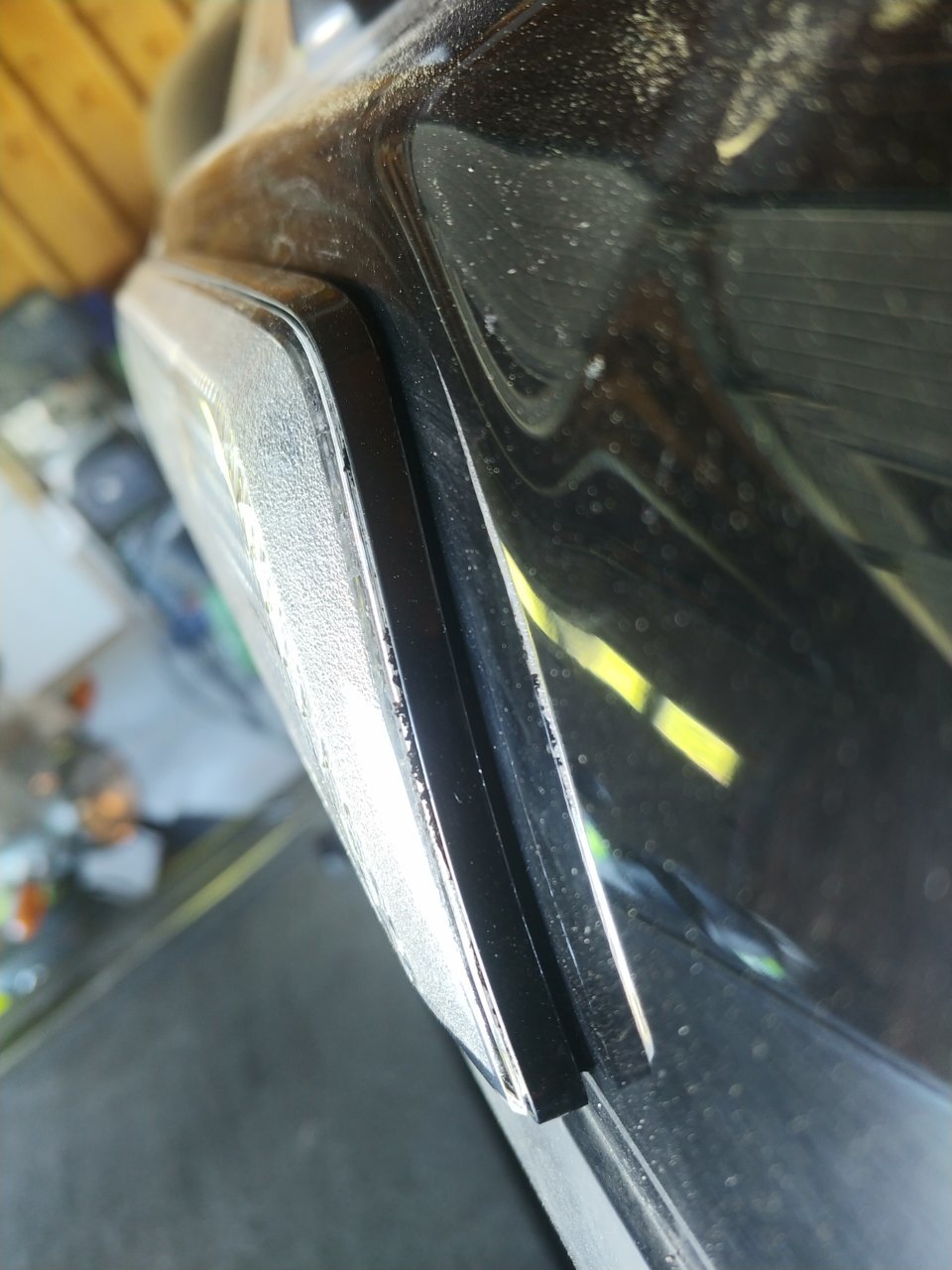

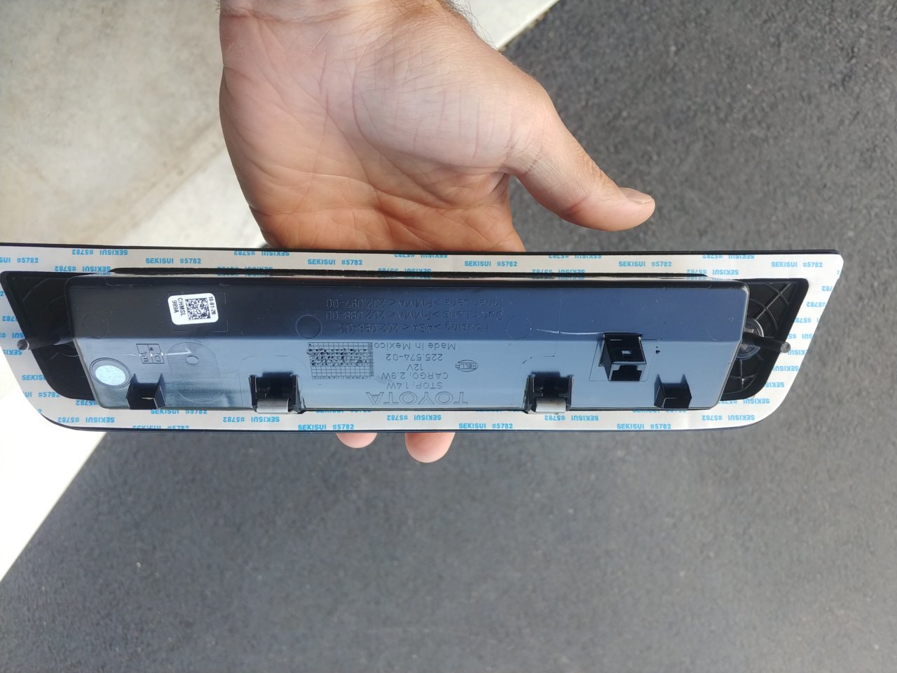

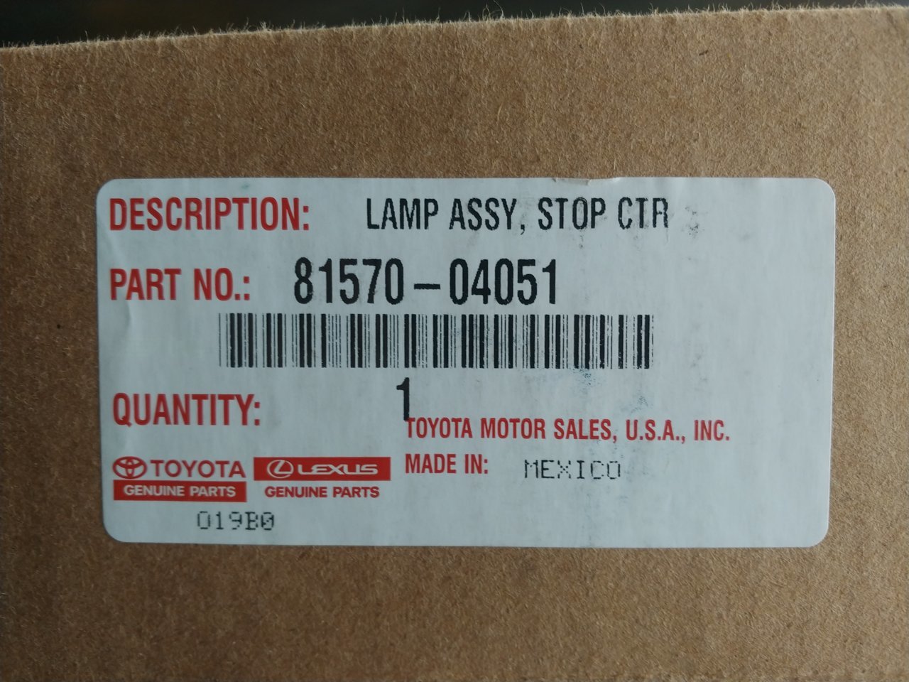

    I'm actually dealing with a leaking 3rd brake light right now. There was indeed a TSB about this... I think mine had been taken care of prior to me purchasing it, but my third brake light has a crack in it. I have taken photos for your comparison and will be installing this over the weekend. There are at least three part number for this part for the double cab. See below.

    Just a quick follow up... Install of the third brake light was relatively easy. I only pulled down part of the headliner as I was not doing anything which required the whole thing come down. (Trim removal tools are cheap and help immensely) That said I did manage to drop my deep well socket into the roof space and so I remembered @MESO mention that the third brake light could technically be removed from the outside. That is the case here as it was already cracked, but installation of the replacement third brake, unless Meso made, will require the headliner be dropped. Doing so allowed me to retrieve my socket and finish the job.
    Also, a huge thanks to @Silentwolf for the mention of Folex as I had never heard of this stuff, but boy does it work great. Photos below...

    Does anyone know the torque for the two nuts when re-installing the replacement light? The dealer I purchased my light from said I needed the 04051 replacement light. I will be doing this swap out maybe Monday depending on the weather, thanks in advance for the help.

    3.6 N·m (36 kgf·cm, 31 in·lbf)
    By the way, 31 is in inch pounds, not foot pounds.
    If doing foot pounds then 2.6 is what you're going for.
