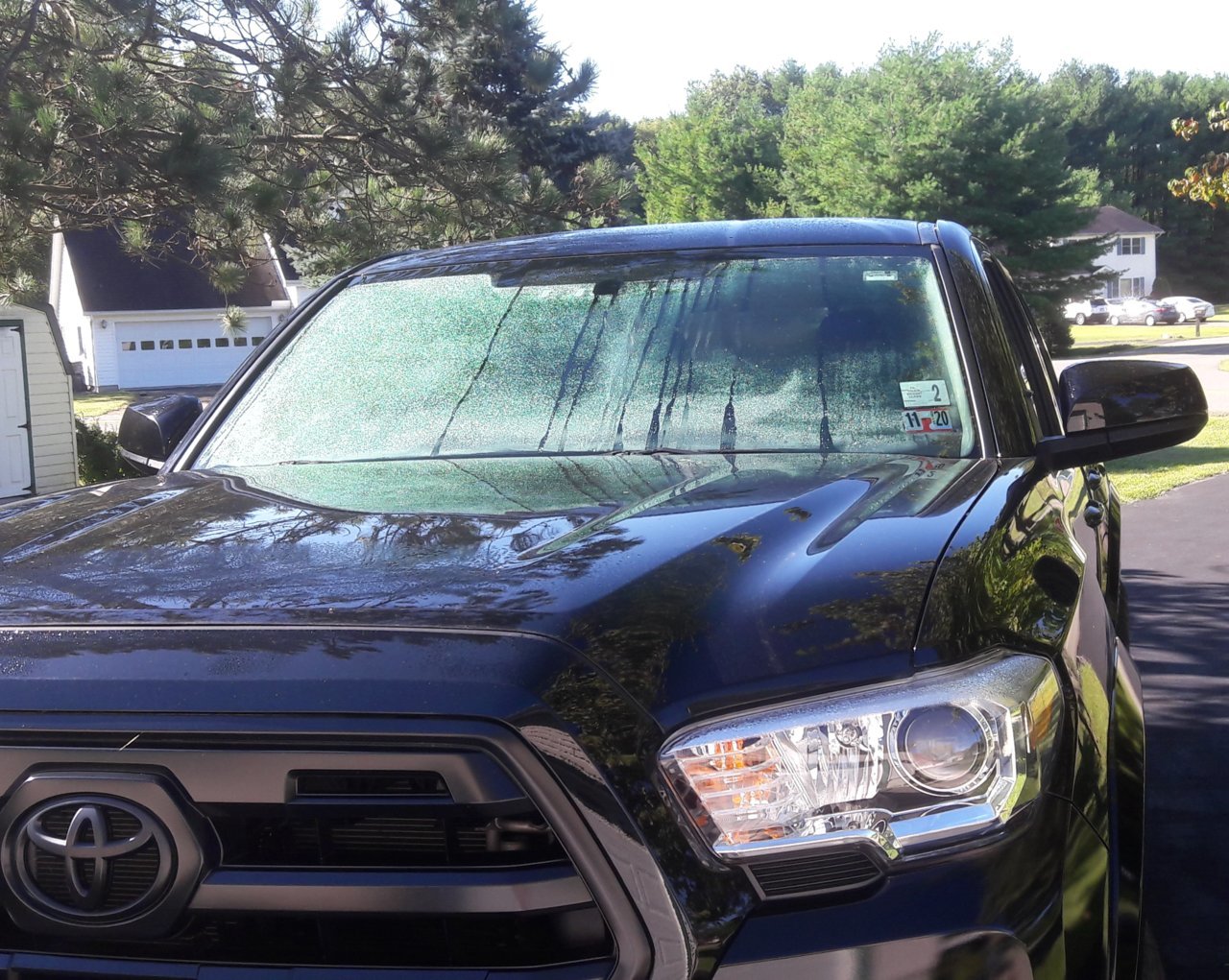

  10. Sep 26, 2020 at 10:30 AM
    TacoGroomer
    TacoGroomer Member
    Sep 23, 2016
    #198077
    8
    2016 Black Tacoma LTD
    Mine was a leak in the third brake light. They almost didn't cover it under my extended warranty because they said it was the gasket around it that was leaking. Ridiculous excuse. They ended up showing good will & I just got it back this week. Waiting for the next rainfall to see if it holds up. If you run your hand behind the rear seat, you will feel the wet carpet.
    I had to open my door & windows to get it all dried off. Hope this helped. Here's a picture of my windshield. The water is on the Inside!!!20200910_090304.jpg
