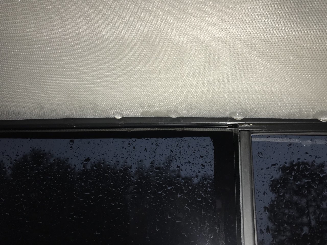

    I have a 2017 DC 4x4. Rained all day yesterday, got in it at 5pm turned on the A/C, all windows were fogged up so bad it took 10 minutes of heat to clear up and smelled slightly stale. Thought it was wet mats? Rained again all day today, 5pm windows fogged and smelled like mildew bad. Got home and read this post. Checked and no cracking on light but noticed gap where light gasket was not pressing against the body. Started raining hard again so I got in the truck with a flashlight and its freaking raining in my truck from the headliner! At 19K miles, bought it at 14K from Autonation. Taking it to the dealer in the AM. The dealer better fix it right and get all of the wet carpet & seats dry and like new...pissed!

    These cases are becoming very frequent recently. Hope the dealer can get it fixed, it’s a known issue
