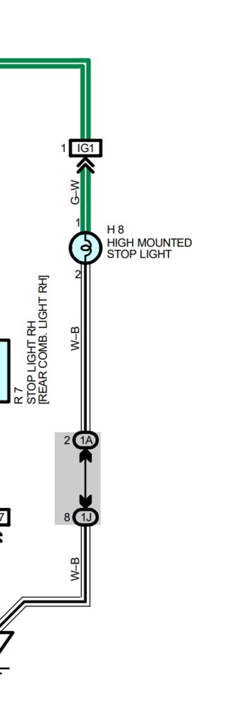

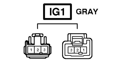

    Does that 3 wire plug look like this?

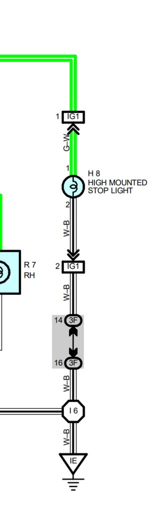

    Yeah man......
    It's different......
    Notice how the 2003 comes in on the IG1 connector at pin1?
    Then notice that the 1998 comes in on pin1 but back out on pin2 to ground?
    Yeah that pin2 on the 2003 is used for the interior cab light.
    You can make this work.....But you need diagrams. And time. Lots of time.

    That 3 pin connector is the one. I used a meter on it today, and if I remember correctly, the middle pin is hot constant.....the outer pins go to ground....that is on the 03 side.
