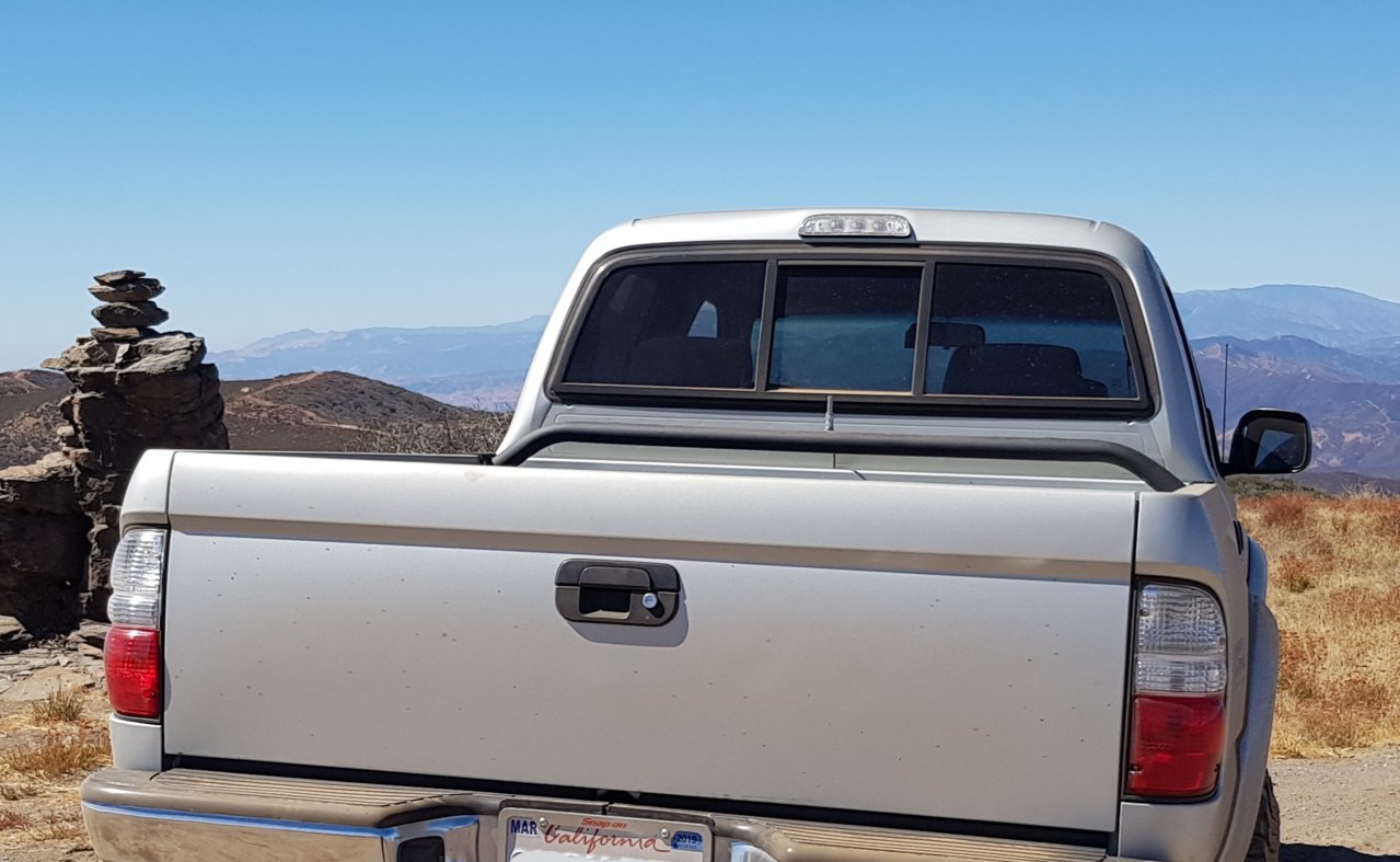

    You guys are lucky, on a 1st gen you have to drop the headliner to unbolt the 3rd brake light housing if you ever need to change it for some reason.

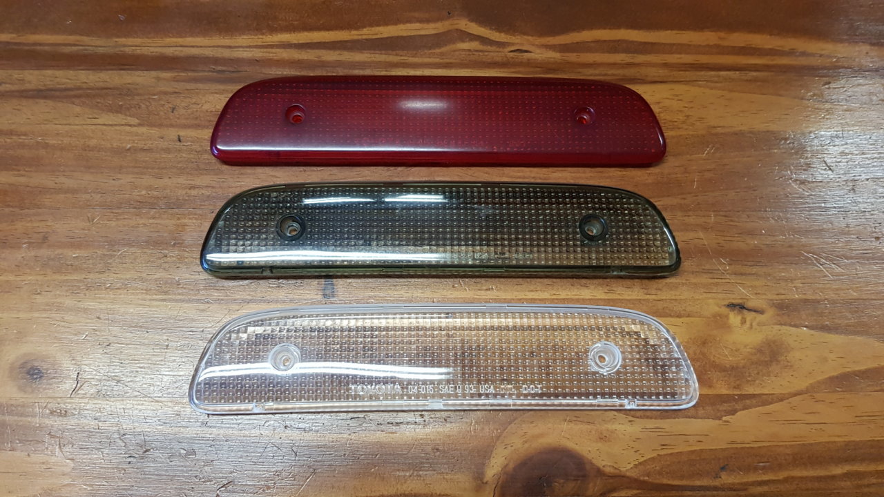

    Yes there is. They have clear & smoked. I have a clear one on my 1st gen. But they're in Canada so after shipping it gets kind of expensive. Not that it matters but the 1st gen ones was molded off an OEM lens so it says Toyota on it. For the second gen the photo they show doesn't say Toyota on it, not sure if an OEM does but again whatever.
    https://klearz.com/05-15_tacoma_3rd_brake_light
    I originally wanted a clear one but stupid me last minute bought smoked instead. I could of sworn when I bought it they listed smoked & light smoked and I bought light smoked. But they don't show light smoked anymore. Maybe it's a custom option now as they show custom in the drop down. Didn't like it on my truck so I sold it & bought clear which I should've done in the first place. :facepalm:

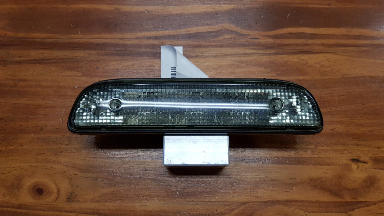

    (I pretty sure this was light smoked or maybe I'm remembering wrong, it was a while ago)
    EDIT: Found my FS post, yup that was light smoked. Here's another photo of it shown on the light housing.
