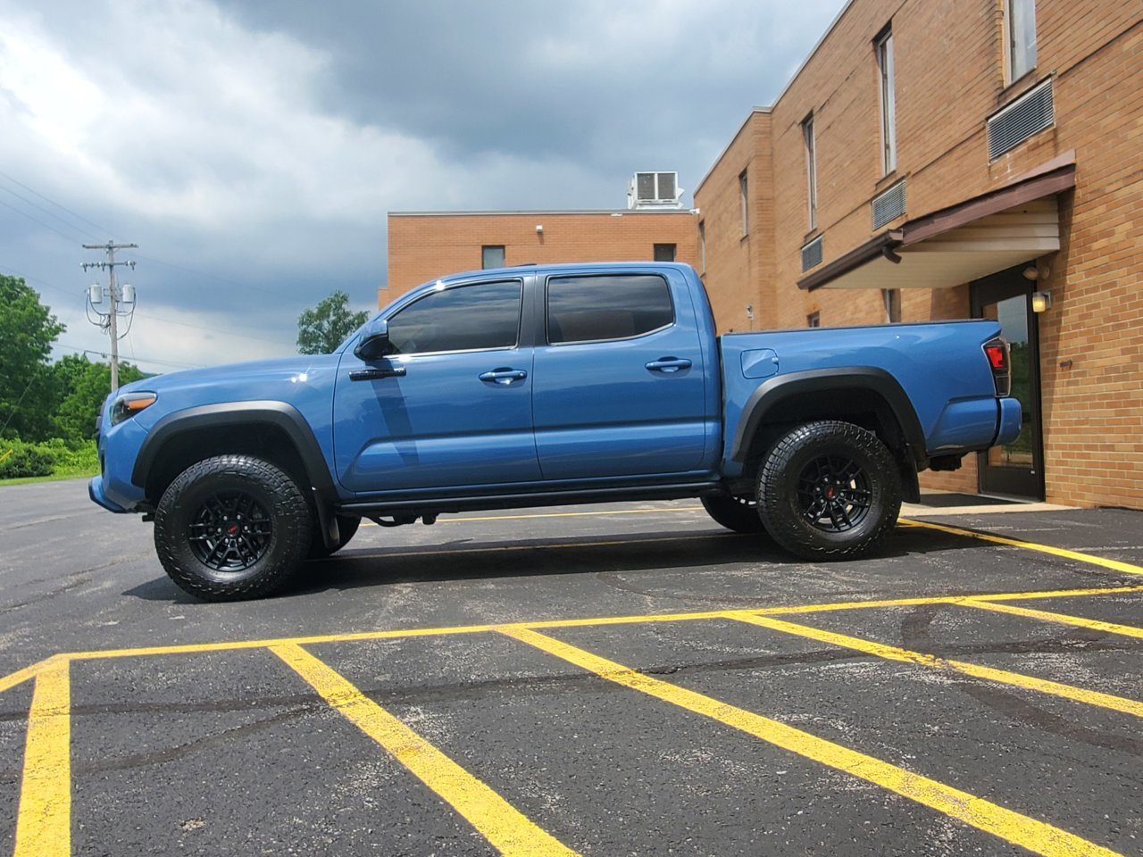

    A few.
    This is my trd offroad with bilstein 5100s on the 3rd notch (1.1" lift) up front and a 1 inch lift block in the rear with 1" bigger tires. Of course u could also go the cheaper way and install a 1/2" thick shim/spacer on top of the front coilover assembly for 1" of lift also.
