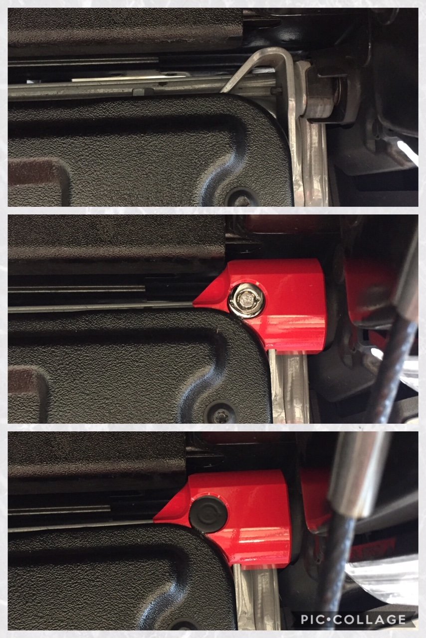

    #233
    jester_motorsports
    jester_motorsports Well-Known Member
    Mar 10, 2017
    #212851
    199
    Josh
    Edwardsville, IL
    Black 2004 TRD Off-Road 4x4 Dcab
    That skin has play in it to shuffle it around a little if you just loosen all of the screws like a quarter turn. Once you loosen them you can shift it off to the driver side enough to clear the new lock and not put that plastic skin in a bind.
    Also, what’s the little black cap over the lock portion in your last photo?
  14. Aug 12, 2018 at 8:16 PM
    #234
    scleaf
    scleaf [OP] Well-Known Member
    Jan 6, 2014
    #120062
    1,019
    Torrance, California. USA
    2013 Silver Tacoma TRD 4x4
    SaBellCo's Tailgate Lock :), Cable mod
    We recommend in the instructions to loosen the all the screws so when the lock is in place you can adjust the tailgate skin to fit. The screws holes should center up to the plastic nut plate but there could be a little variance between trucks. You don't really want to have it snap into position. I think each truck will vary based on how the assembly person installed the tailgate skin though.
  15. Aug 12, 2018 at 8:23 PM
    #235
    jester_motorsports
    Mar 10, 2017
    #212851
    199
    Josh
    Edwardsville, IL
    Yep, I figured that out when I went to put my skin back down. It hung up on the lock so I just loosened the skin screws again, adjusted it to the side a tick, and it dropped right into place. Perfect.
