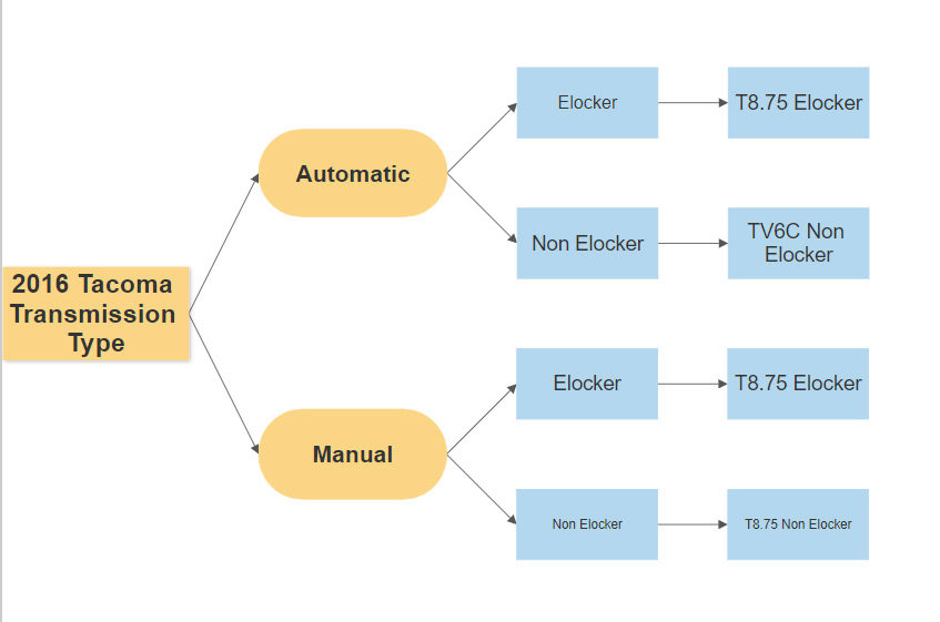

    Here’s a fun chart to know which trucks have the 8” diff. A fun fact is that the 3rd gen Tacoma 8” diffs are not interchangeable with any other 8” diff as the bolt pattern and housing is just slightly different than previous models tv6 non elocker. But the gear sets are interchangeable.
