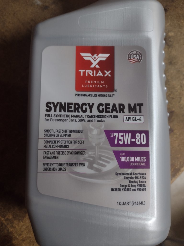

    Two4Runner
    Two4Runner Well-Known Member
    Jan 6, 2018
    #240460
    118
    LD
    Shreveport
    2017 DCSB TRD Offroad 4x4
