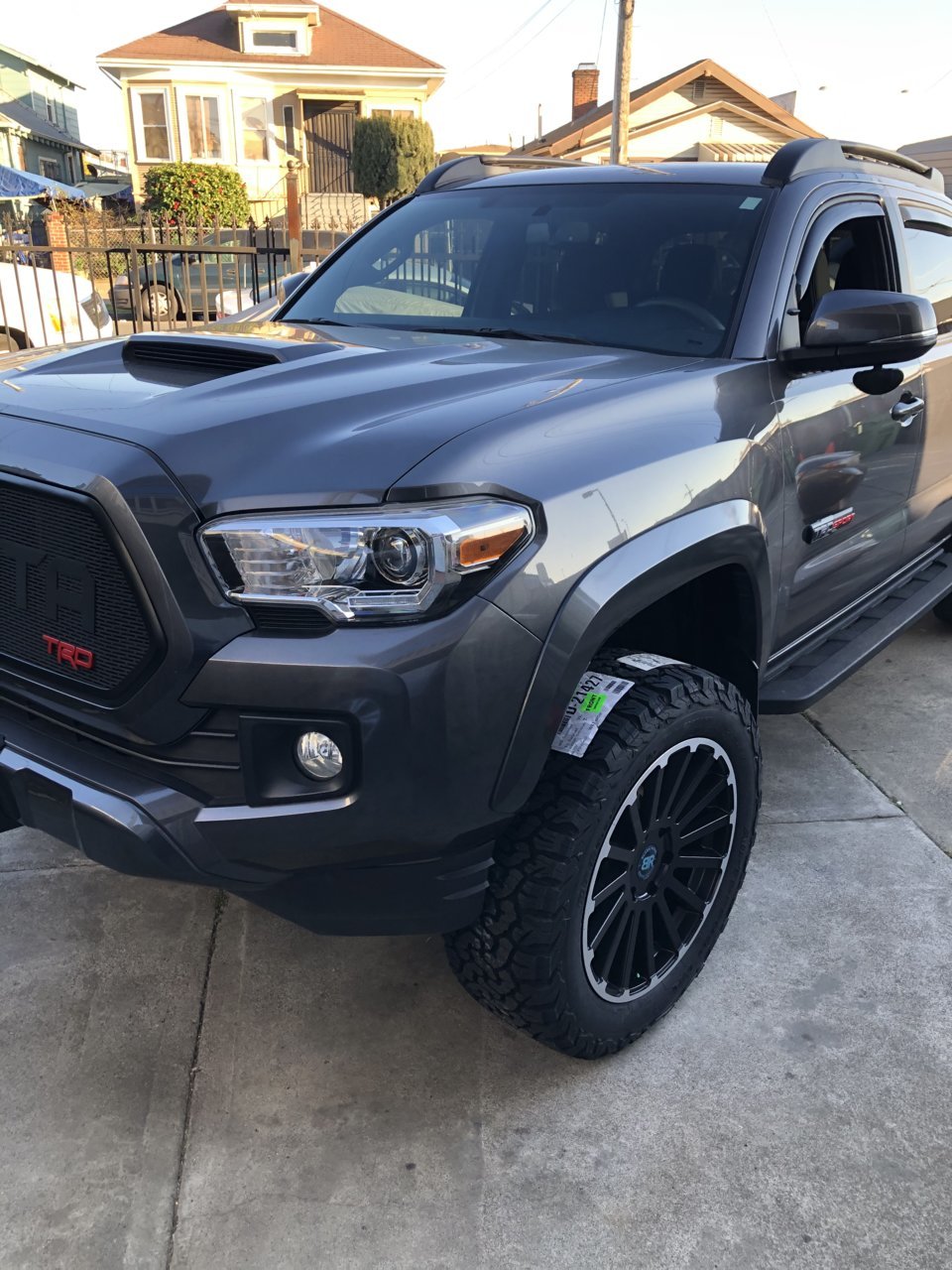

    So I just purchased 20x9 wheels with 275/55/20 ko2 tires....I’m having a 3inch front and 1 inch rear leveling kit installed....will my wheels still rub????....about 31.9 inches measured from ground to top and I also have a 1.25 wheel spacer put on?????

    So the shop just installed a 2.25 front and 1 inch rear leveling kit....the rims I have are 0 offset....thanks for your help...any information is very useful.

    3/1 inch leveling kit....front bottom air guard has to come off but very minor rubbish...I’m happy.

    Looks good and glad to hear there was no major rubbing.
    Is that wheel the Black Rhino Spear?

    Yes!....the wheels did rub, I watched a YouTube video of this guy with a 3rd Gen with the same size rims and tires and claimed it didn’t rub....total BS....the wheels were smacking everything inside the wheel well....after the 3 inch leveling kit was installed there was minor rubbish when the steering wheel was at full turn....I took off the front lower plastic air guard and pushed the wheel liner forward 2 inches and now there’s no rubbing at all. Hope this information was useful.

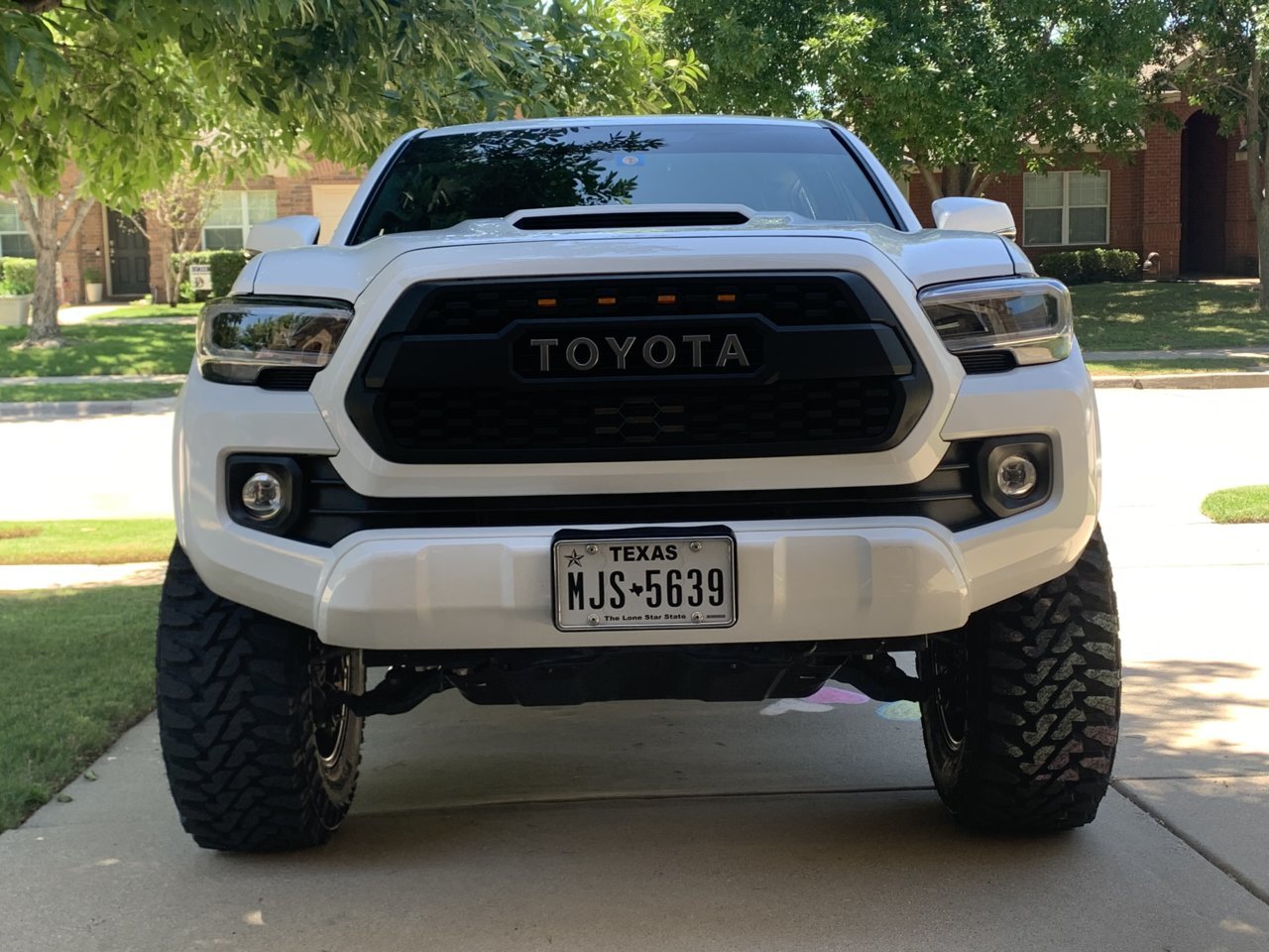

    No cutting. I have 3" front, 2" rear leveling kit. Caster moved to +1.5. I removed air dam, and relocated hole in front inner fender plastic by 1". No Rubbing. Wheels are Black Rhino- Armory 17 x 9.5 @-18 offset w/ 33-12.50 Yokohama Geolander MT
