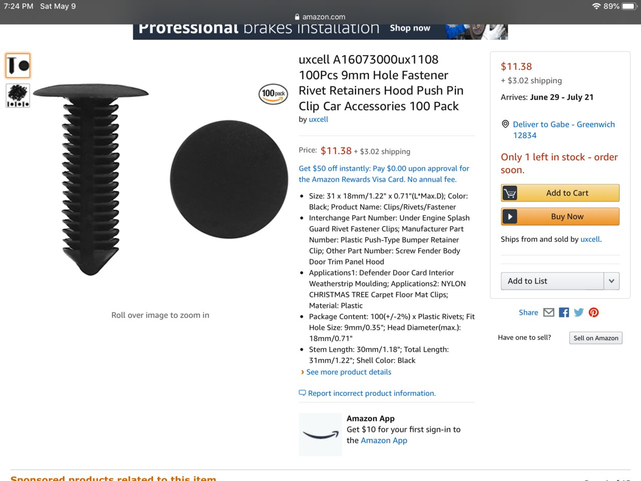

    What depth of clips are recommended? Sounds like 7mm clips are best?

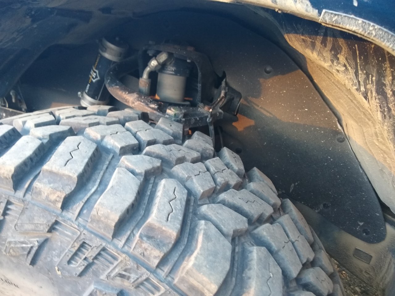

    Finally got around to cutting and installing splash guards for a 2007 2.7l Rwd, heres what it looks like. Passenger side has alot less holes to clip into

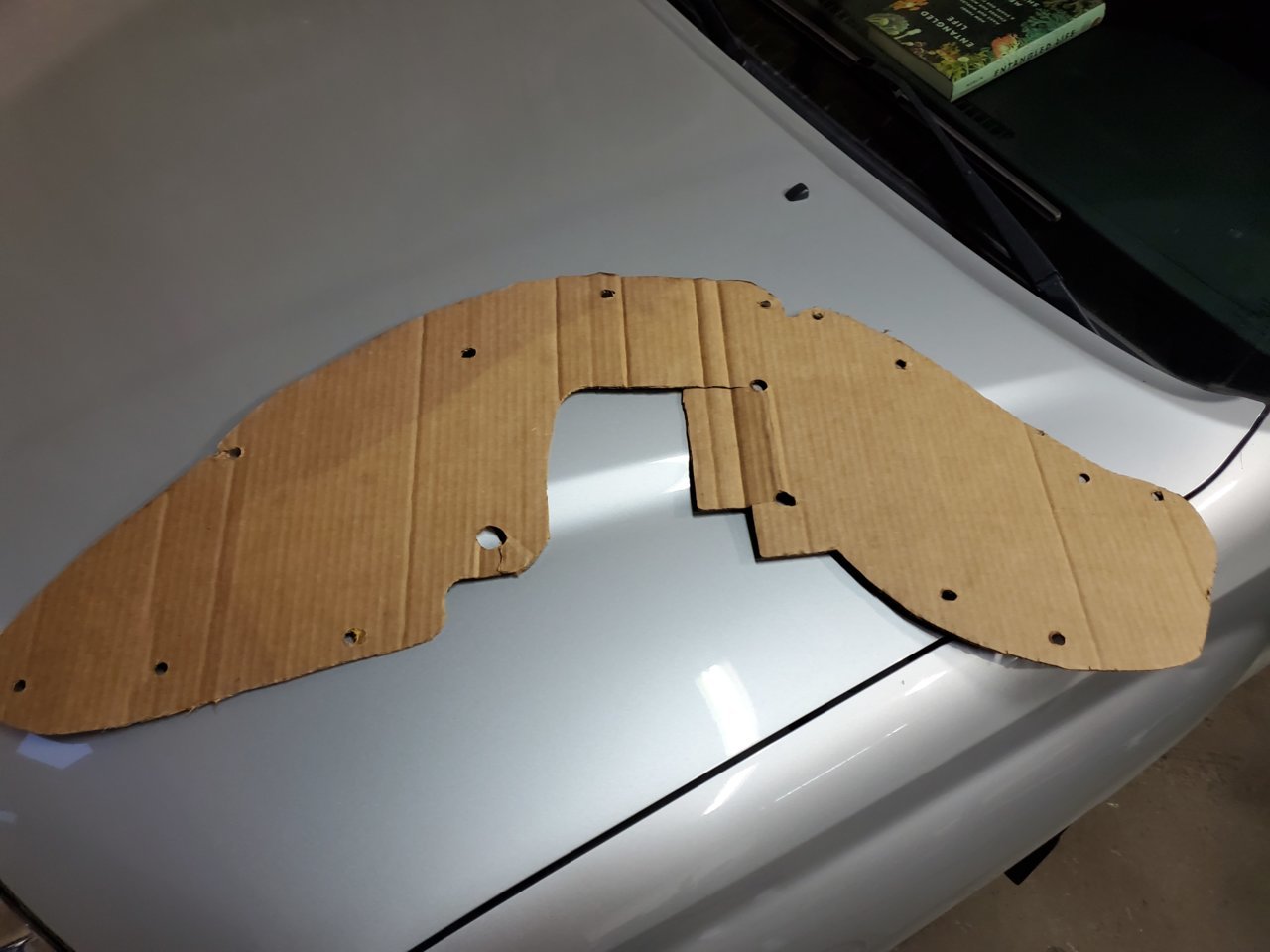

    This is what I did ,

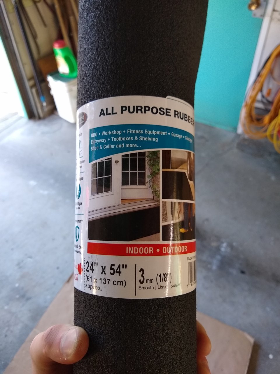

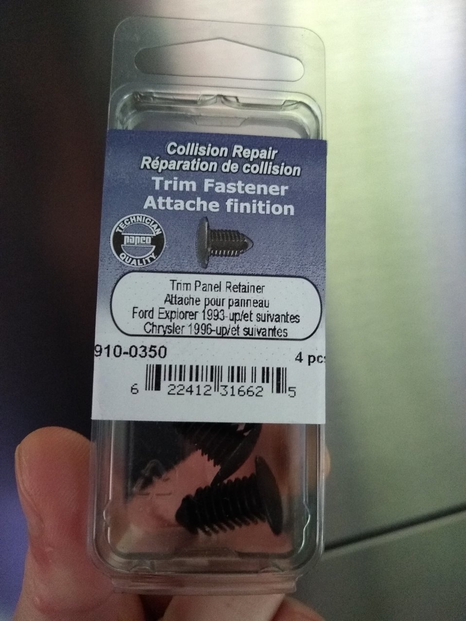

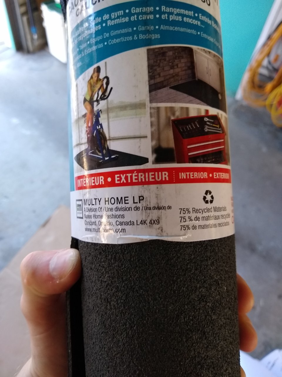

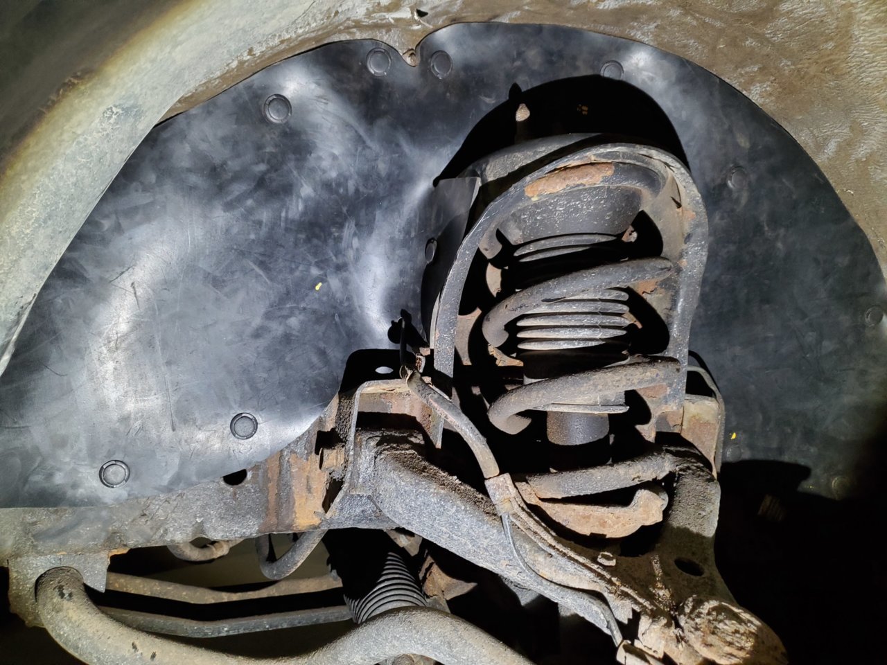

    INSTALL NOTES:
    I snapped some photos of the materials that I used to aid others with installation. I fit two templates on one $14 matt from Home Depot (Canada) and bought individual packs of Christmas Tree clips from the local auto parts supplier in pinch because the big bag of Amazon clips that I ordered weren't going to cut it. More expensive, but hey, they ain't going anywhere. In fact, I had to tap them in with a rubber mallet, so they'll be destryoyed if they ever have to come out. Drilling the rubber was my intial plan but obviously that was a stupid idea. I ended up using a leather belt bunch to make the initial hole, then ran a coarse round file through it a few times to enlarge/stretch it so that the clip could fit through (a 3/8 hole punch would be the cat's meow). Most of my sharpie marked holes were out a bit when I test fit on the truck, so I simply made the holes on the fly. I highly suggest test fitting first before you end up with a bunch of random holes!
