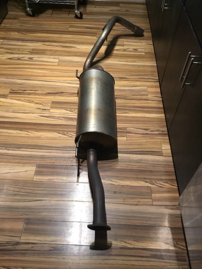

    I presume the answer is no but does anyone definitively know of the exhaust from the cats back to the tail pipe from a 3rd gen 3.5L v6 fit on a 2nd gen 4.0L V6?
    thanks
    pic of 3rd gen exhaust

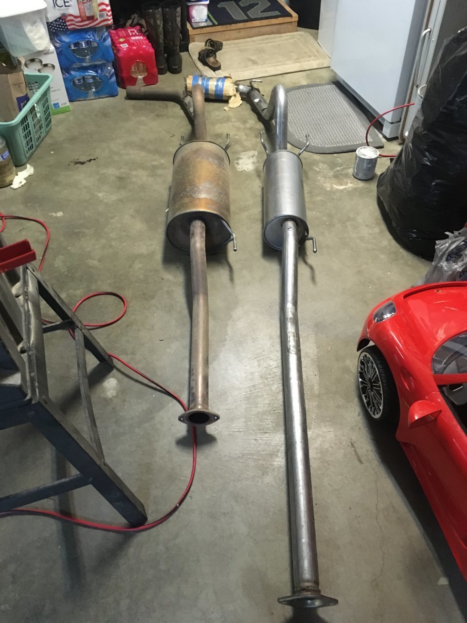

    Pic of 2nd gen trd exhaust compared to 3rd gen .Just to get an idea how it compares . Got pic on here .

  7. Apr 21, 2021 at 7:30 AM
    nd4spdbh
    nd4spdbh Well-Known Member
    Oct 7, 2013
    #114055
    14,598
    SoCal
    13 DCSB TRD OR v6 Auto
    woah no wonder why the 3rd gens are more raspy/loud, didnt realize their muffler was so much smaller!
  8. Apr 21, 2021 at 9:54 AM
    hemitruk
    hemitruk Old man , young boi truk
    Oct 17, 2009
    #24461
    2,302
    Kurt
    Hawaii
    2010 Dbl Cab Sport,
    A few
    Actually the smaller one is the second gen trd exhaust . The 2nd gen reg exhaust has same muffler as the 3rd gen . (Looks thle same)

  9. Apr 21, 2021 at 8:53 PM
    Markcal
    Markcal Well-Known Member
    Aug 14, 2014
    #136147
    3,115
    They say when we buy a car like the red one in your photo, it's a mid-life crisis, so would that make it a mid-adolescence crisis for your child? :confused:

  10. Apr 21, 2021 at 11:23 PM
    hemitruk
    Oct 17, 2009
    #24461
    2,302
    Kurt
    Hawaii
    2010 Dbl Cab Sport,
    A few
    lol. Not my pic .Got pic from a thread on here .
