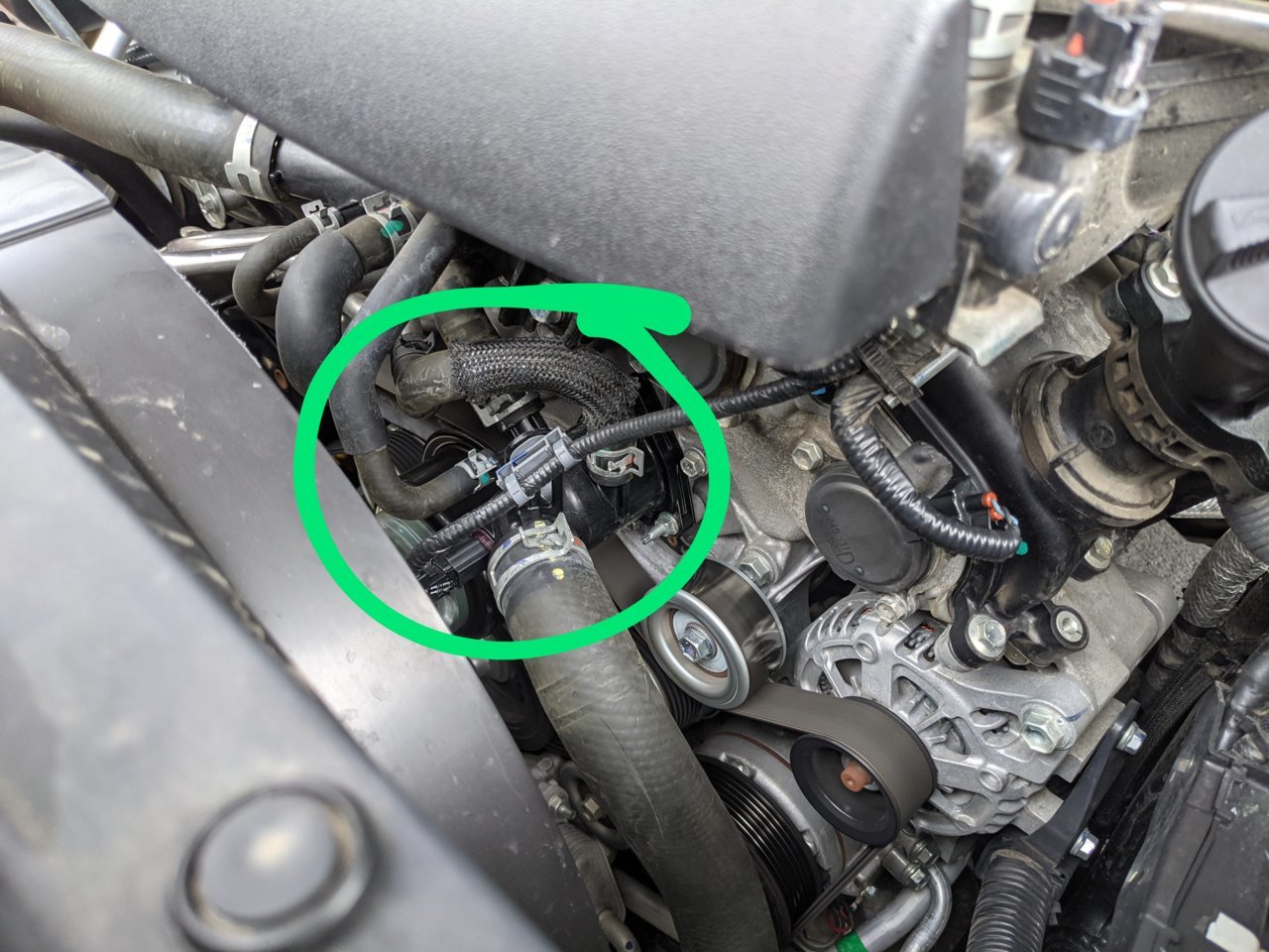

    Just over a year ago my 2018 with 31k had a stuck open thermostat. It never triggered the check engine light or any codes at all. It took much convincing of the dealer that there was an issue until I took the tech on a ride along.
    They might be modern vehicles, but the cooling system is still controlled by a $50 thermostat, no matter what data logging goes on.

  10. Feb 4, 2022 at 9:47 PM
    PlymouthJLA
    PlymouthJLA Active Member
    Nov 26, 2018
    #273850
    40
    East SF Bay Area
    2018 Tacoma OR DCLB
    The thermostat is right here at the front on the engine. It's an entire plastic assembly.
