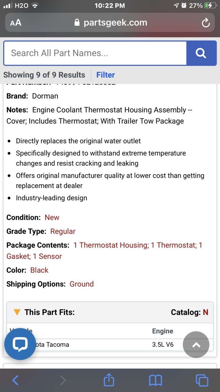

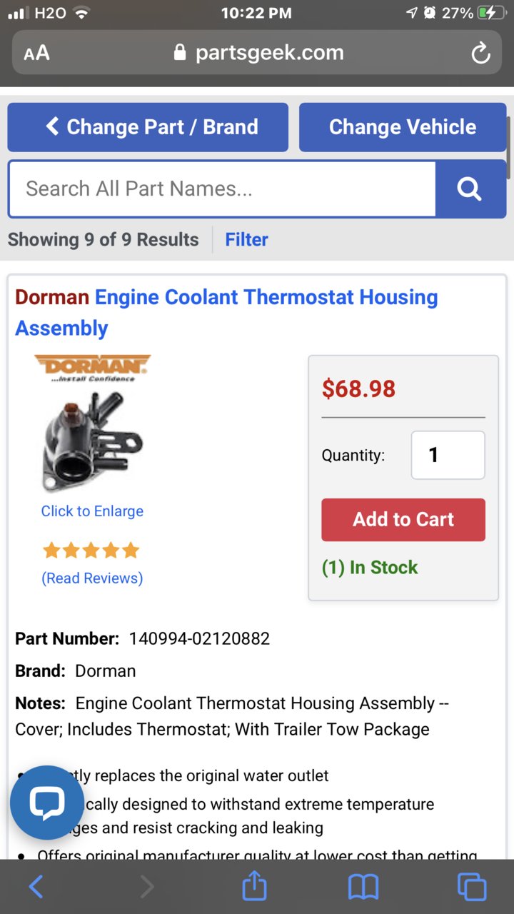

    As for the shortage of thermostats, there is no shortage. I found a few aftermarket thermostats made by reputable companies and ordered a dorman brand one from partsgeek. It was the cheapest place I found at $68 usd. Here’s a link if you want to cancel your back ordered thermostat! Or for anyone else that stumbles upon this thread.
    https://www.partsgeek.com/catalog/2017/toyota/tacoma/cooling_system/thermostat_housing.html
    Also please note in all the listings I’ve found there is a clear message saying “with tow package” on some, and “without tow package” on others so there may be a difference.

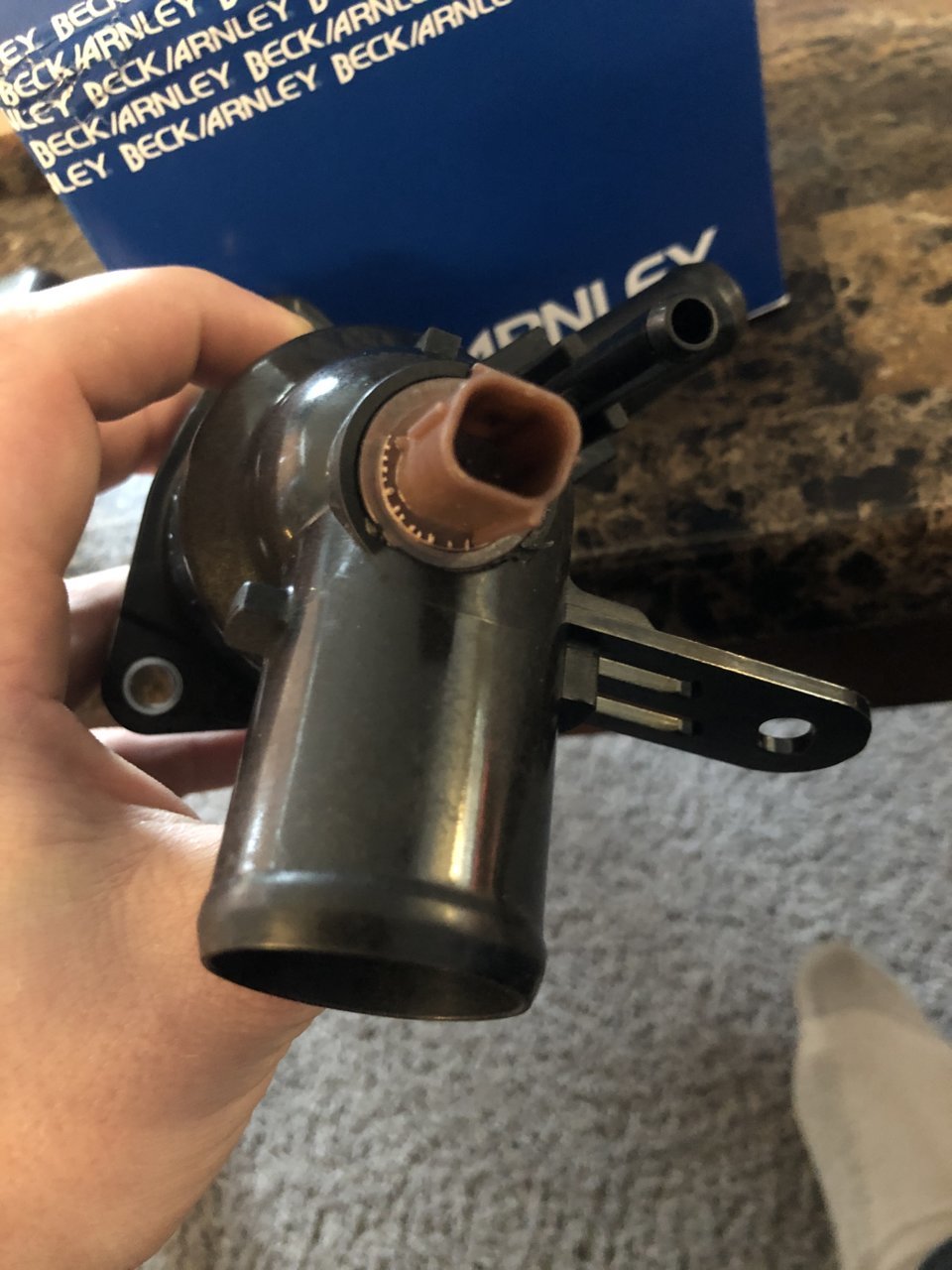

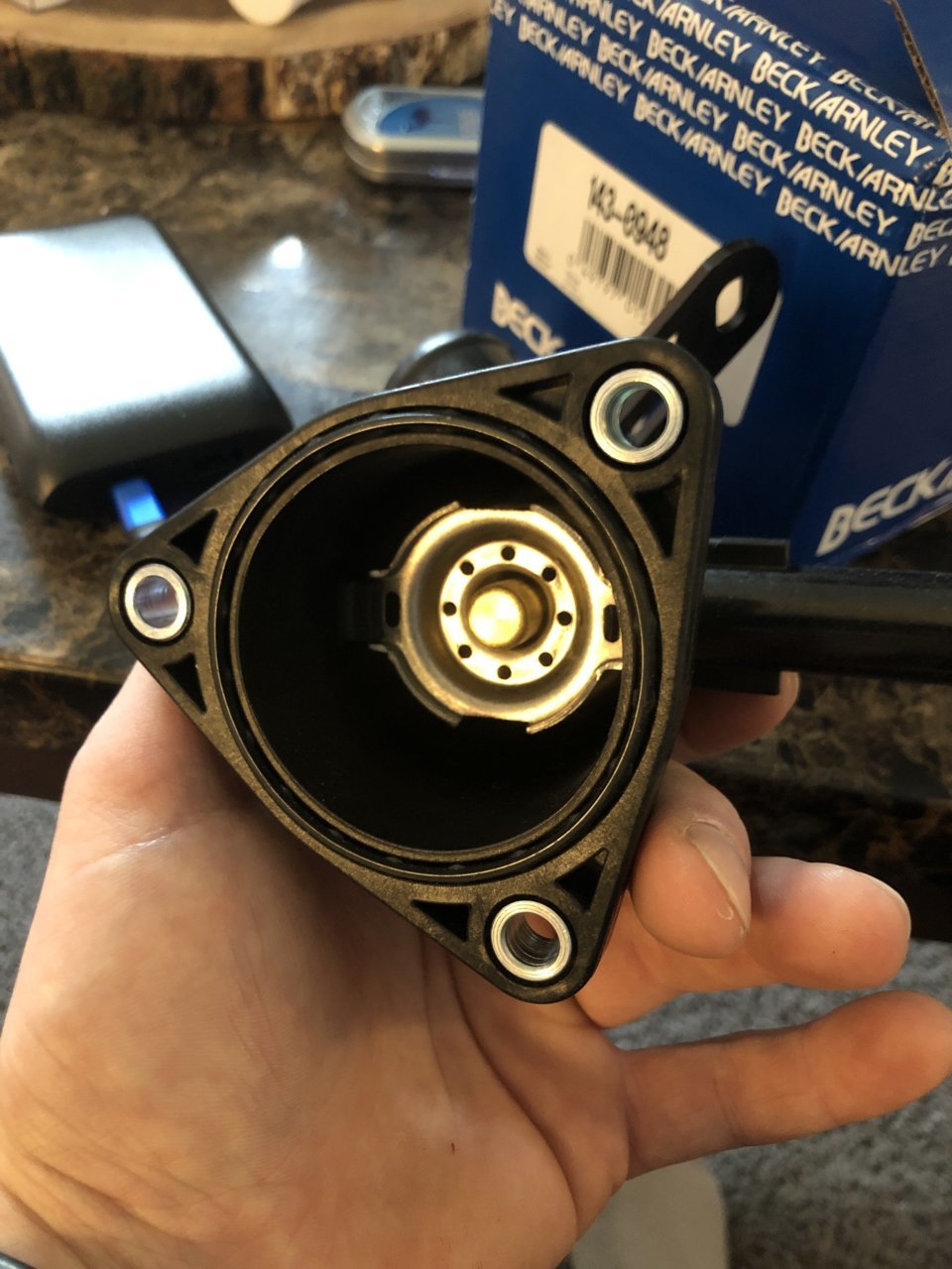

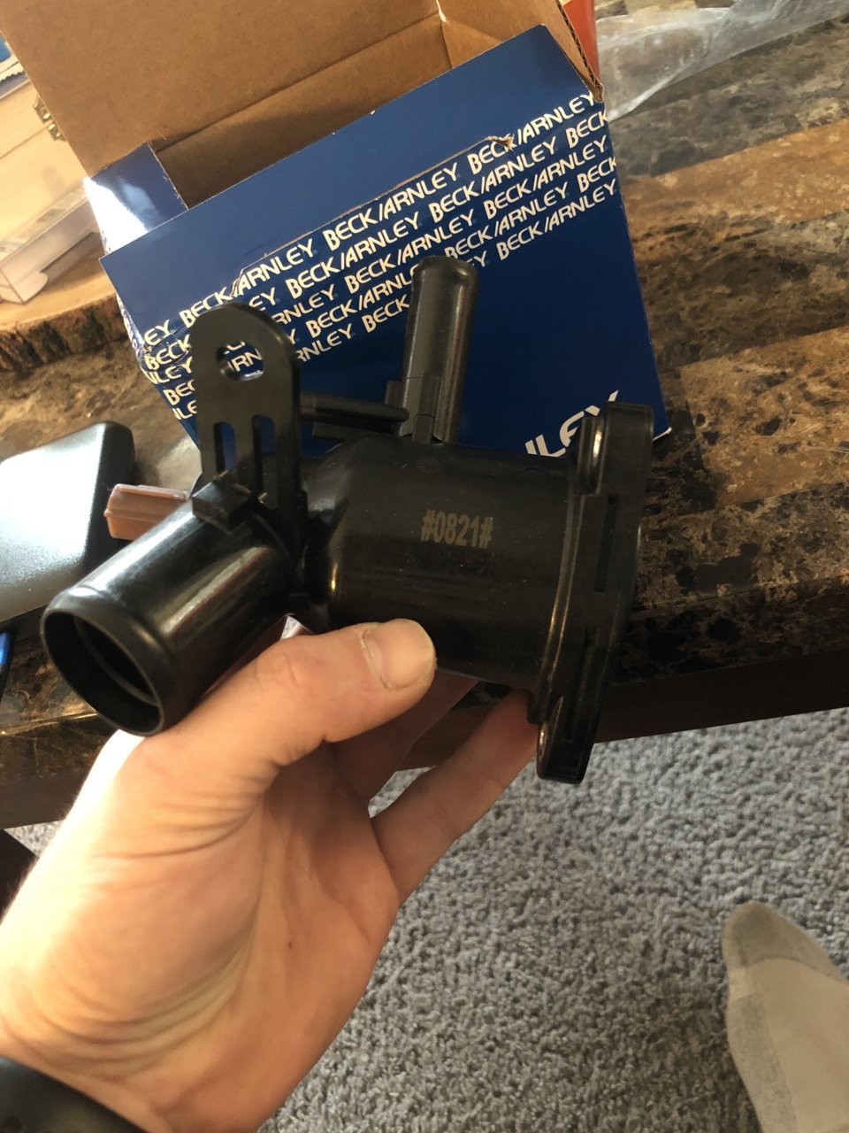

    [Update]
    New thermostat arrived earlier than expected. Was set to arrive on the 15th and it showed up friday. So parts geek apparently gets parts out pretty quick. It is a beck/arnley I thought I ordered a dorman. But it still appears to be quality and they were the same price. Around $65.00 which is significantly cheaper than oem. But what’s new Oem parts aren’t cheap.
    Also I will dissect my factory assembly and figure out where the oem thermostat failed, just to satisfy my and anyone else’s curiosity. I will post the results up once I get everything swapped out and have time to dig the old thermostat out of the housing.
