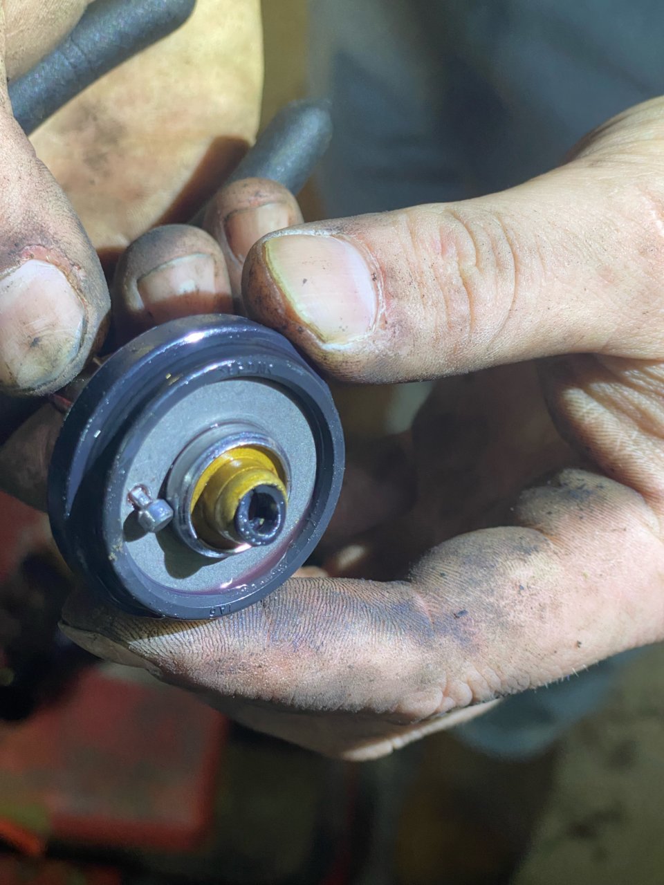

    [update]
    I found the time to tear the assembly off tonight, parts geek had sent me the wrong part for a 3rd gen “without towing package” which it is what it is. I inherited the family’s bad luck so I’m used to it.
    Anyways I managed to tear into the factory assembly and found the issue. It was in fact stuck open. And the culprit was a plastic bushing. It was sitting sideways and preventing the thermostat from seating fully as you’ll see in the picture below.
    I corrected it by filing it down flat so that the thermostat would seat completely again and it works, I cannot blow through the housing whatsoever and before filing it flush It was free flowing when blown through.
    I would say that this is a design flaw on Toyota’s part. That plastic bushing kind of floats around in there, enough that it managed to work its way out and get wedged at an angle. My truck has a little over 40k on the clock.
    I decided to tear into the beck/arnley and see if it was the same design with a plastic bushing but it was not. It was solid brass and appeared to be very well designed compared to the oem stamped metal and plastic bushing one. I didn’t get any pictures because my phone died but I will post some of the internals when I get the right part in. I’ll do a comparison of the guts of both assemblies when I have them both off.
    I just want to mention in the picture you will see a small slit in each side of that plastic bushing, they let coolant contact the temp probe when fully closed. I did not replicate them when I filed it flush and it seems my temp gauge is reading lower than actual engine temp now. But I did fix the overall issue until I can get in my new assembly. I have heat, and my truck is much happier and running at normal operating temp.

    That's not a sensor in the t-stat, but rather a preheat device which helps the thermostat open very quickly. Toyota runs the coolant temps in the Taco a little hotter than normal, which in my best assumption, places the cooling system a bit closer to the edge. There's no time to waste with a regular old lazy t-stat.

    Hmm really? That’s odd, if that’s the case the bushing that rides on the heat probe is just made of plastic and plastic doesn’t transfer much heat. That thing would need to be extremely hot to heat up the assembly enough to open. You have to figure that the spring needs to heat up to open the tstat. So that probe would have to transfer heat through the coolant between it and the metal tube that encases it. Then the heat would have to transfer through the coolant in the tstat housing to begin opening the thermostat. And those puny wires leading to it can’t pass much current so I would say that it probably doesn’t work all that well. But I guess we will find out. It’s getting unplugged next time I let out the pooch and I’m going to see if It heats up any quicker just out of curiosity.

    Hey man any information is helpful in my eyes, I like to learn. There’s not much easily accessible info on the 2grfks so yes that is helpful lol it’s just crazy to me that that is supposed to get the surrounding area hot enough to let the spring open. But I suppose if their goal is to help the tstat open “faster” then that heater probe probably only comes on when the coolant is just about hot enough to open the tstat on its own. So I suppose it could be effective in bumping the temp up just enough to open it quicker.
    Are you able to throw the link up to that information for me, and any other curious people that stumble upon this thread?
