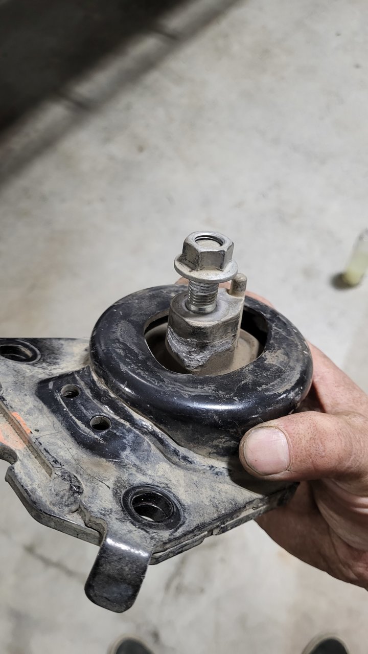

    It does move around that much when actually crawling, bombing through whoops, and so on. Forest roads, no. When you're in 4lo especially, you effectively have over double the torque forcing on things. Make those forces more with bigger tires.
    Theres tons of threads on 2nd gen guys breaking the mounts off the frame, etc.
    For example, I just broke my dual case shifter off since the shifter moved about 6" while under full load, bound up against my center console and broke off. I thought it was only going to move 3". With duals I effectively have over 5x the torque forcing on everything
    The motor moving also becomes a problem when guys (im doing one this weekend on mine) put a bigger steering rack in, as clearances are more than tight already, and then you throw a larger rack in and you need to know that the motor isnt going to slam down onto the rack.
    Heres a photo of my stock mount, it was binding into the metal, and in turn creating inches of motor movement.
