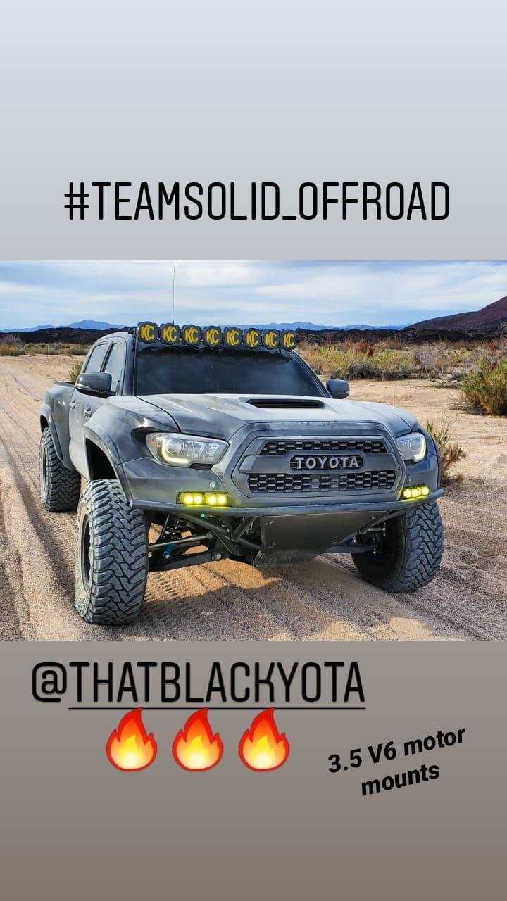

    This was our 3.5 test truck, not sure if any of you are familiar with the truck or owner
