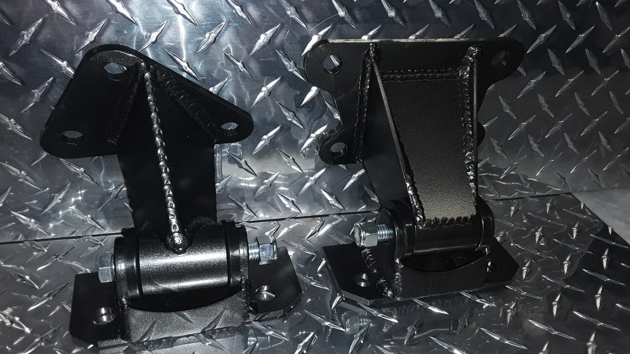

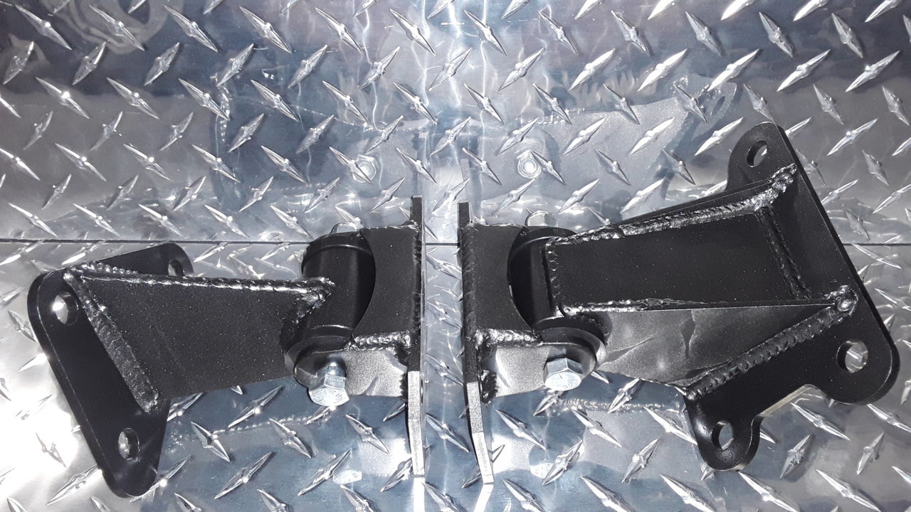

    Not talking shit or anything negative, but invest in better lighting / background. The lighting makes the undercut look huge on these.

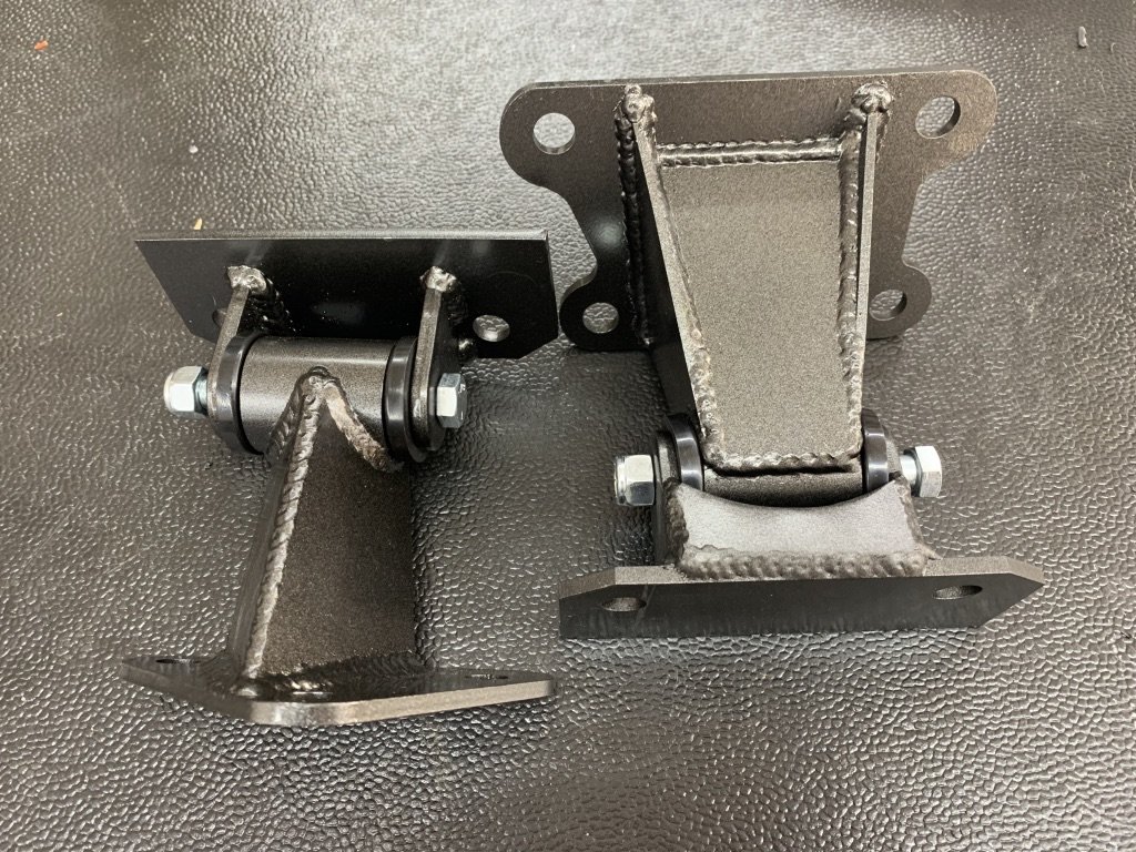

    what would your opinion be regarding the install? the instructions look super straightforward and he says it only requires significant prying etc if the frame has some deflection. after everything i just did i really don't want to pay to drop the diff for access. but if we need to we will...

    I've only removed them with engines, never replaced. I would say a ratchet wrench is critical and jack up the motor as high as it can go.
    The long way, but easiest would be to remove the manifolds.
    Book time is 10 hours, it's not easy.

    Front diff makes it more work for sure, just less room. I have guys that said 3 hours. Ive had guys that say all day. Its really dependent on your mechanical skill and assortment of tools. Having a buddy always helps.
    If your truck frame/perches are bent from off-roading, then it will be more work to line things up haha. It doesn't take much to tweak these frames as the OEM mounts allow for so much flex.
    Remember, a flexy bendy rubber mount is easy to move around to line holes up. Harder, polyurethane mounts are not. So the tolerances are TIGHT. Leave everything loose..everything until all bolts are hand threaded in. This can take some trial and error!
    Personally, I'm around 4 hours for the 4.0 and the 3.5 motors. Gear wrenches are a lifesaver, and socket extensions.
    The good news, you wont have to do it twice and you'll have peace of mind and cheap insurance:thumbsup:

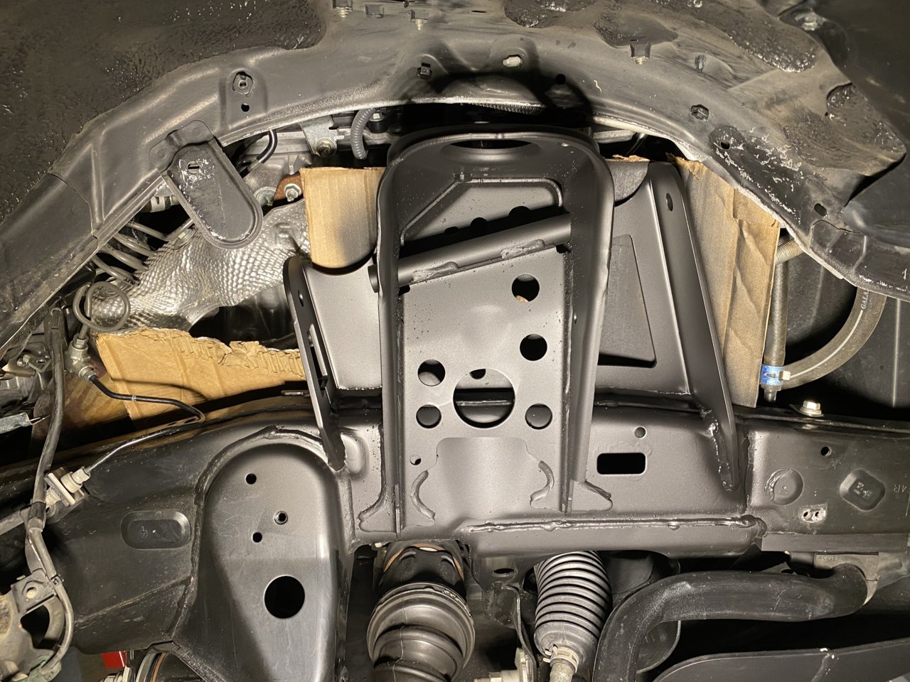

    I’m going to regret doing this before installing mine! Looks like there is still good access. Shipping soon???

    Yeah most of the access is from the top so DO IT BEFORE MOUNTING UP THE TURBO MANIFOLDS! It will make it 100X easier with all that out of the way. I have reinforced shock towers too.. doesn't make it easier or harder lol
