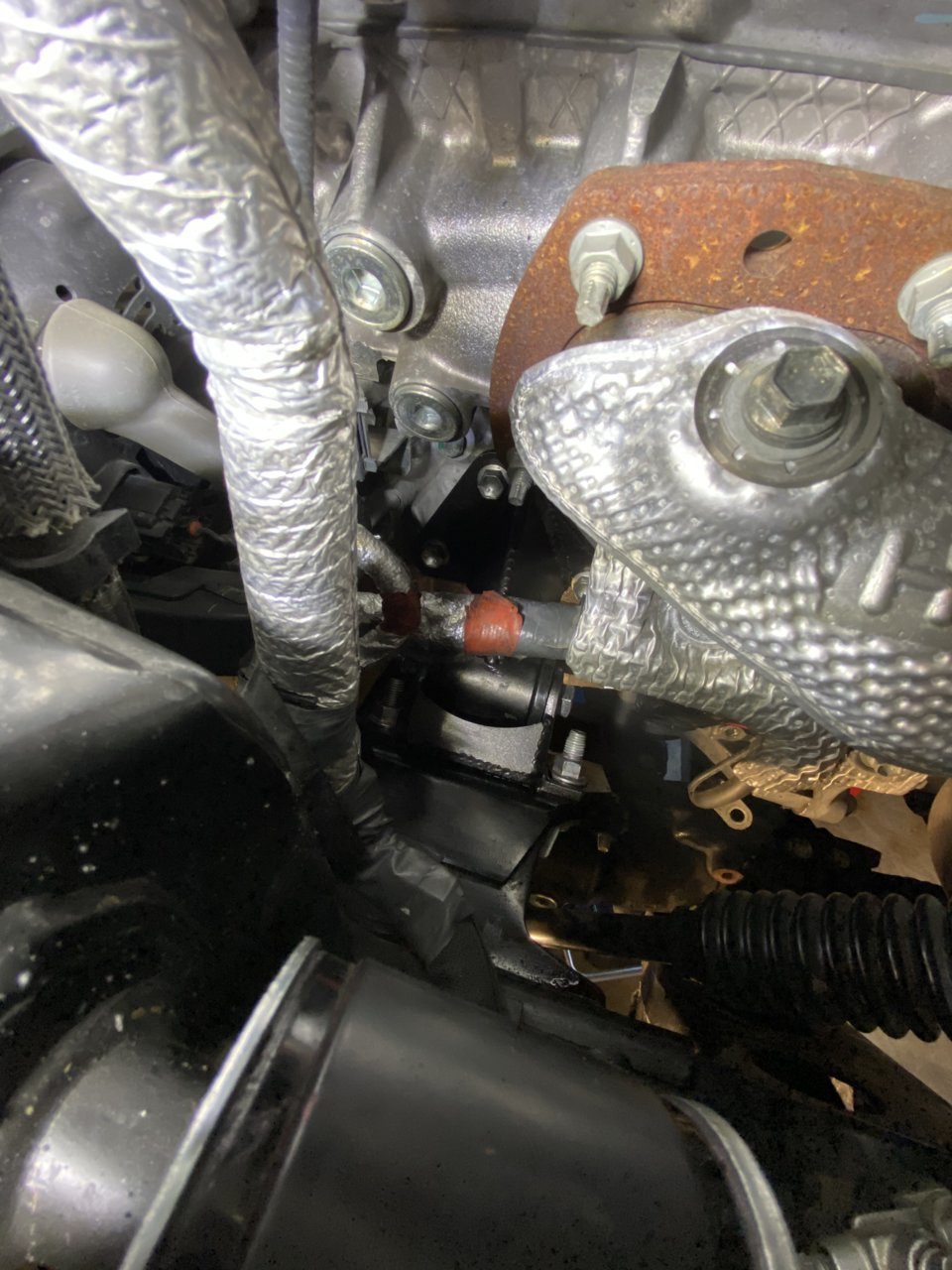

    I know it's hard to get a camera in there, but any chance you have an after pic of the mount installed?

    I cant specifically remember a customer sending me a pic of the 3.5 mounts installed yet. I have a bunch of all the other kits. I'll ask on Instagram if anyone has.

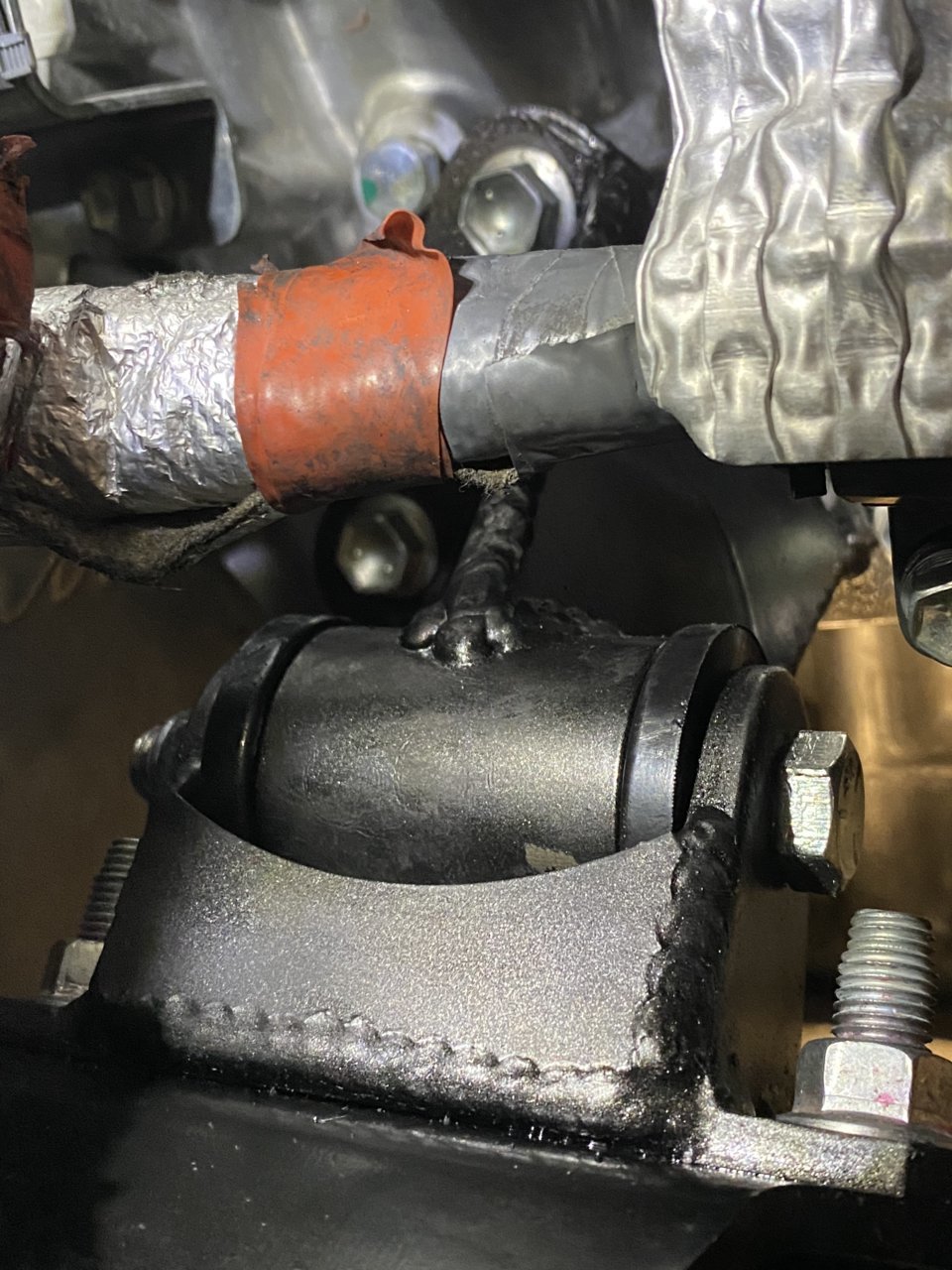

    Got the passenger side done, not too bad with the shock removed. Took a bit over an hour.

    very nice, any other tips aside from shock removal? about an hour per side after shock removal?
  9. Oct 10, 2020 at 7:04 PM
    #89
    rj_taco
    rj_taco Well-Known Member
    Feb 28, 2017
    #211935
    240
    All bolts are 14 mm except for the center nut on the stock mount is 17mm and the thru bolt on the new is 16mm. I used a jack to support the center and a 2nd jack on the oil pan to line the bolts up. Pretty much break all bolts free and if the holes quit lining up as you remove the bolts, use the 2nd jack to line them back up. Also, before removing the last bolt go ahead and remove the 17mm nut in order to remove the mount in 2 pieces. Use blue thread locker for the engine block mount and a dab of red for the others. Make sure to have the through bolt in place before tightening any of the bolts. Couldn’t get a torque wrench on pretty much all of them, just be careful with the aluminum threads on the block. That’s pretty much it. I can see it being even easier if you don’t have the shock tower gussets. Should be fine with the shock in place though, just made it easier with it and the UCA out of the way.

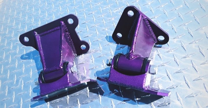

    Does anyone have a comparison/side by side picture with the OEM and OP’s motor mount?

    Just finished these, definitely a first for me haha

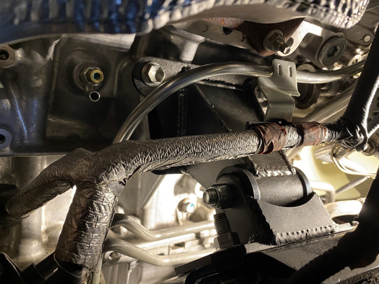

    How those will appear when installed....

    Drivers side done. Left everything in, except wheel, mud covers and a ground bolt. I don’t have the shock tower gussets installed on the drivers side yet. Removing the OEM mount wasn’t too bad, tight. You have to remove the ground bolt on the block in order to get the lower half of the OEM mount out. Other than that, same as the other side. Make sure the holes line up as you remove the last engine block bolt. A 17mm ratchet wrench will save you time on the center bolt on the OEM mount. After getting all bolts snug (except for the through bolt), push the through bolt flush and tighten the left frame nut first. Do the through bolt last. I put the through bolt nut on the left side. A 14mm 3/8 short socket will fit on the through bolt head. Holding the nut with a wrench, tighten the bolt with a ratchet. Took an hour and a half. With tower gussets it will take some effort to brake the block bolts lose, since you won’t have a clear line of sight to them. Eat your cereal before doing this!
