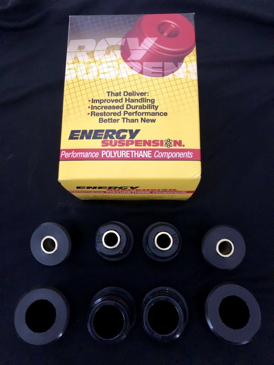

    Just gettin started

    cool!
    New get to :bananadead: those old ones out. Be patient. It might take a little while to melt the rubber out. I ended up going back and forth with the torch and a screwdriver and eventually got to a point where you could peal out the rubber. Then clean it real good. I used a wire disc on a dremel.
