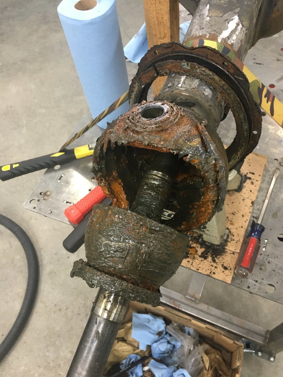

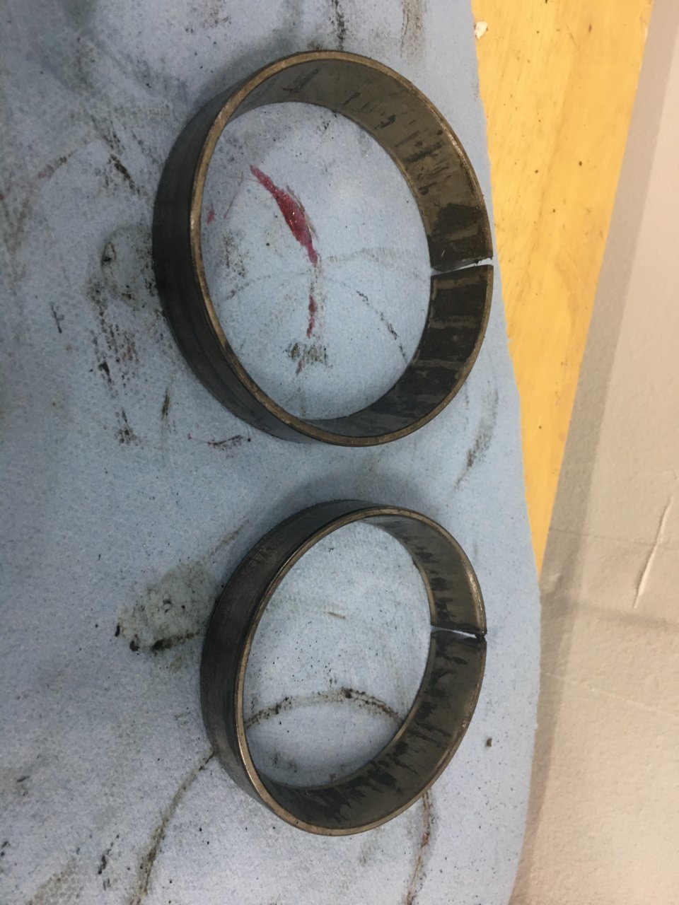

    Maybe common knowledge, but a relief cut in old races makes a perfect driver for new races. All new wheel and trunnion bearings/races.2589D353-7382-4CFD-9582-663F6B3D86EA.jpg3B72FF9D-639A-41D3-BBC0-68CDBC37E220.jpg

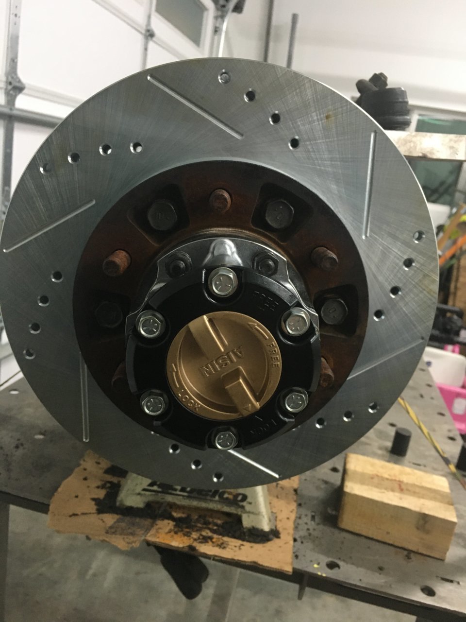

    These locking hubs accommodate the snap ring location of the shorter fj80 birf, and will be compatible with the rcv hub gear/birfs. Buying them new is almost as much as junkyard solid axle aisin hubs these days. I’ve never been able to break a stock fj80 birf but wanted future options just in case.

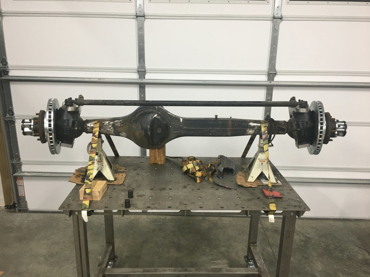

    Axle is ready for link brackets
