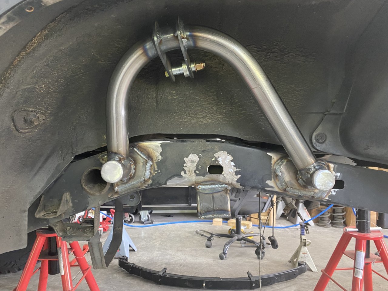

  12. May 22, 2023 at 8:45 PM
    #192
    smacaulay
    smacaulay [OP] Well-Known Member
    Nov 6, 2015
    #168830
    294
    Slowly getting there
    Duckfatt, ToyRyd04 and 02hilux like this.

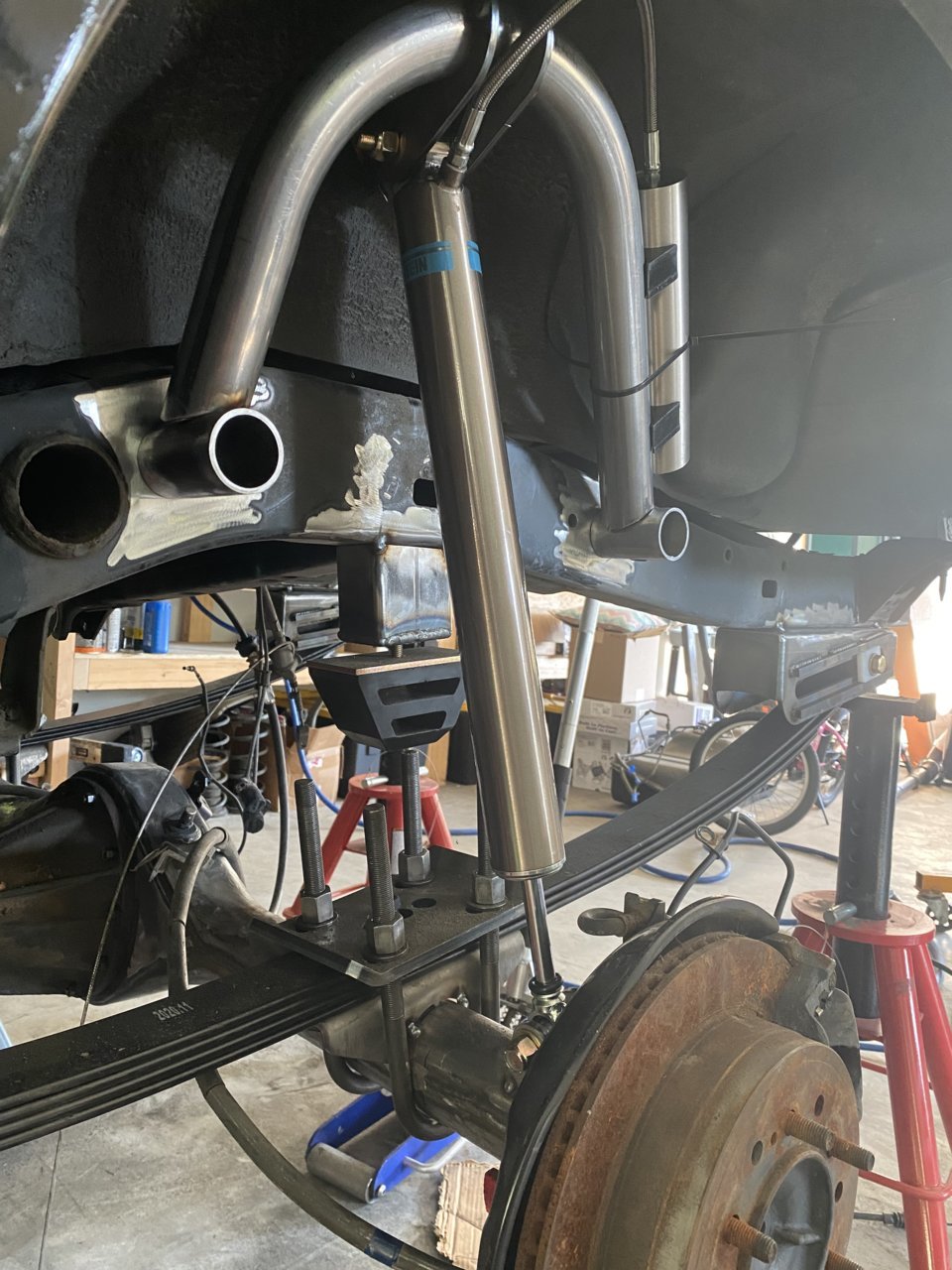

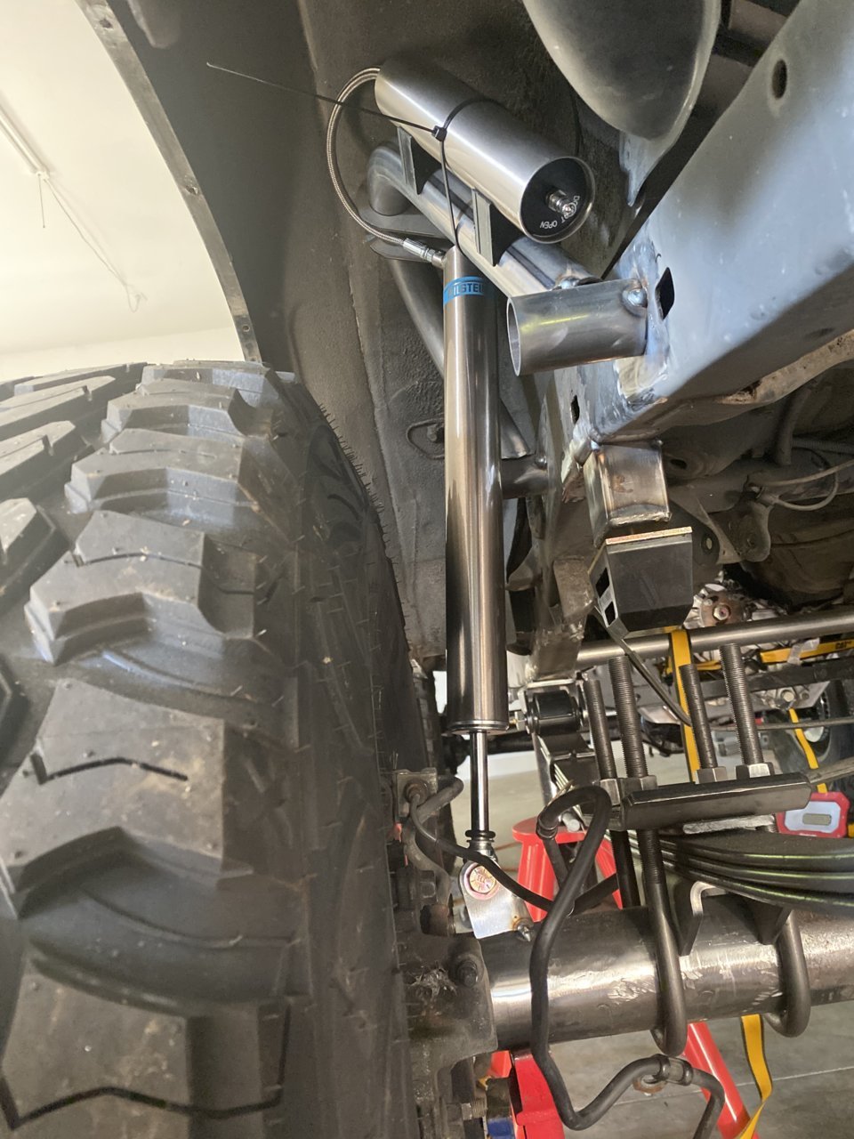

  13. May 25, 2023 at 6:40 PM
    #193
    smacaulay
    Nov 6, 2015
    #168830
    294
    Finally got some bolts. Gonna cut the lower bracket down a bit and move it an inch inboard to clear the brake line better. Probly 2” to full bump, and 3” of shaft showing.
  14. May 29, 2023 at 2:05 PM
    #194
    smacaulay
    Nov 6, 2015
    #168830
    294
    Both shock hoops are in, ran outta gas.
    Duckfatt, sparkystaco and 02hilux like this.

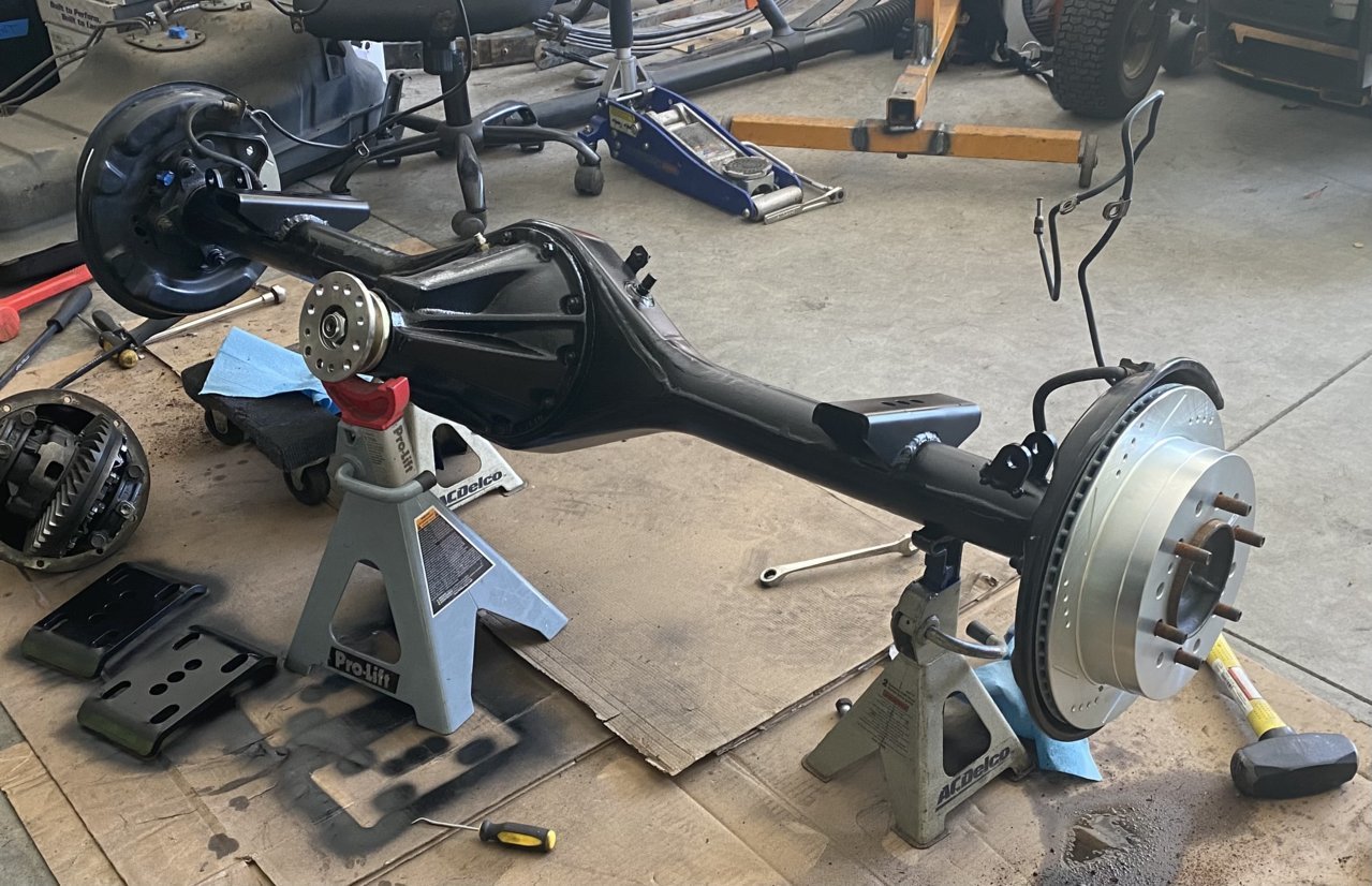

  15. Jun 3, 2023 at 4:56 PM
    #195
    smacaulay
    Nov 6, 2015
    #168830
    294

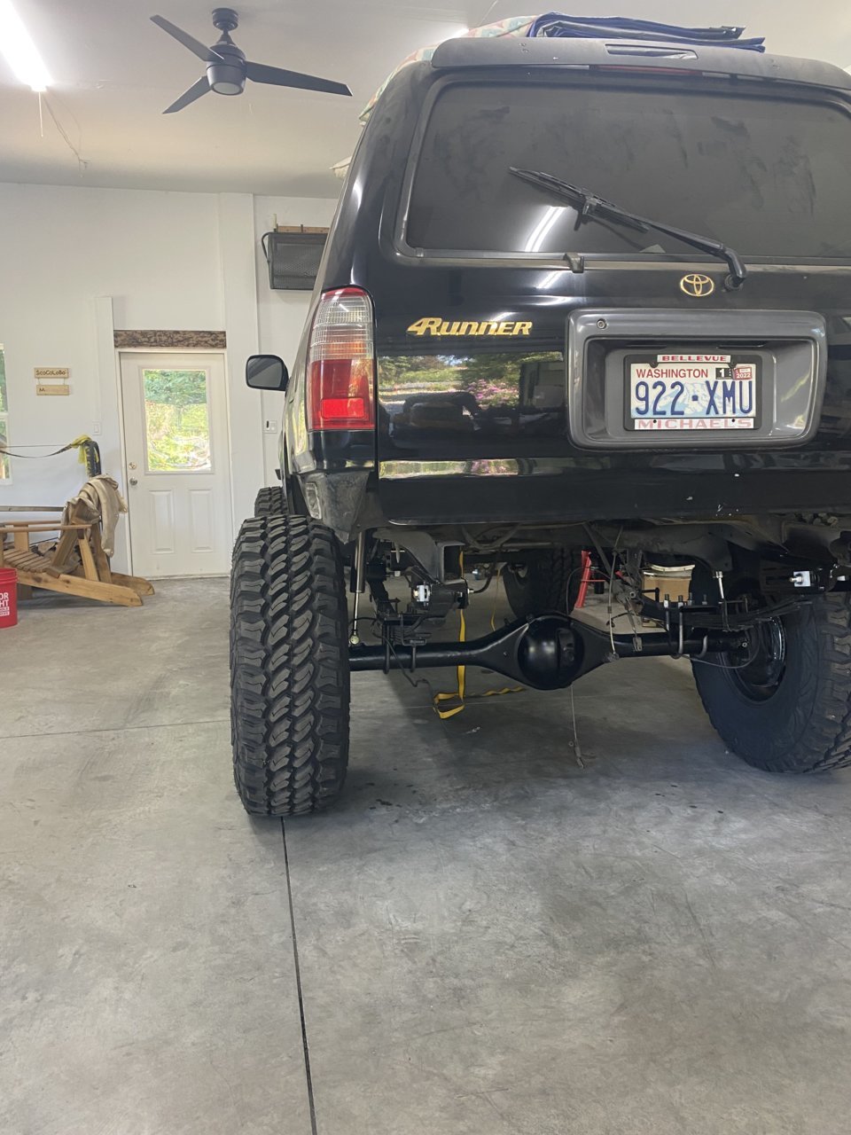

    Rear axle is ready ish. Should be finally on the ground tomorrow.
    ToyRyd04, sparkystaco and 02hilux like this.

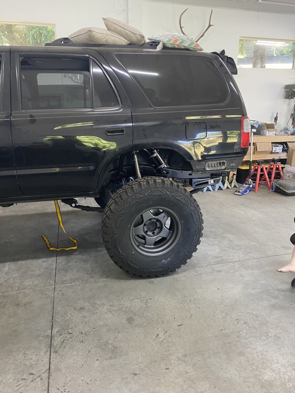

  16. Jun 4, 2023 at 2:36 PM
    #196
    smacaulay
    Nov 6, 2015
    #168830
    294
    No jack stands, weird.

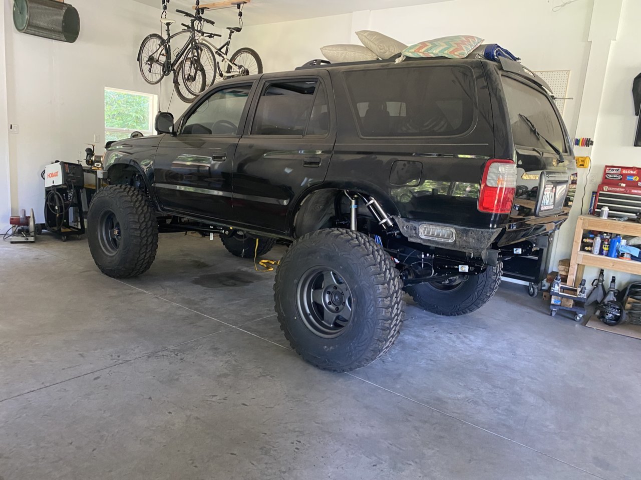

  17. Jun 26, 2023 at 11:02 AM
    #197
    smacaulay
    Nov 6, 2015
    #168830
    294
    Ordered all my hydro assist stuff. Went with trail gear hoses as they are super inexpensive vs. PSC fittings. Ordered some summit fittings and hose for low pressure lines. The hydro assist fitting on my tapped box goes right into the body mount....I should be able to modify it to work. Also got an intake made, fuse box and evap mounted, battery will go behind the rear seat. Lot's of little stuff.
