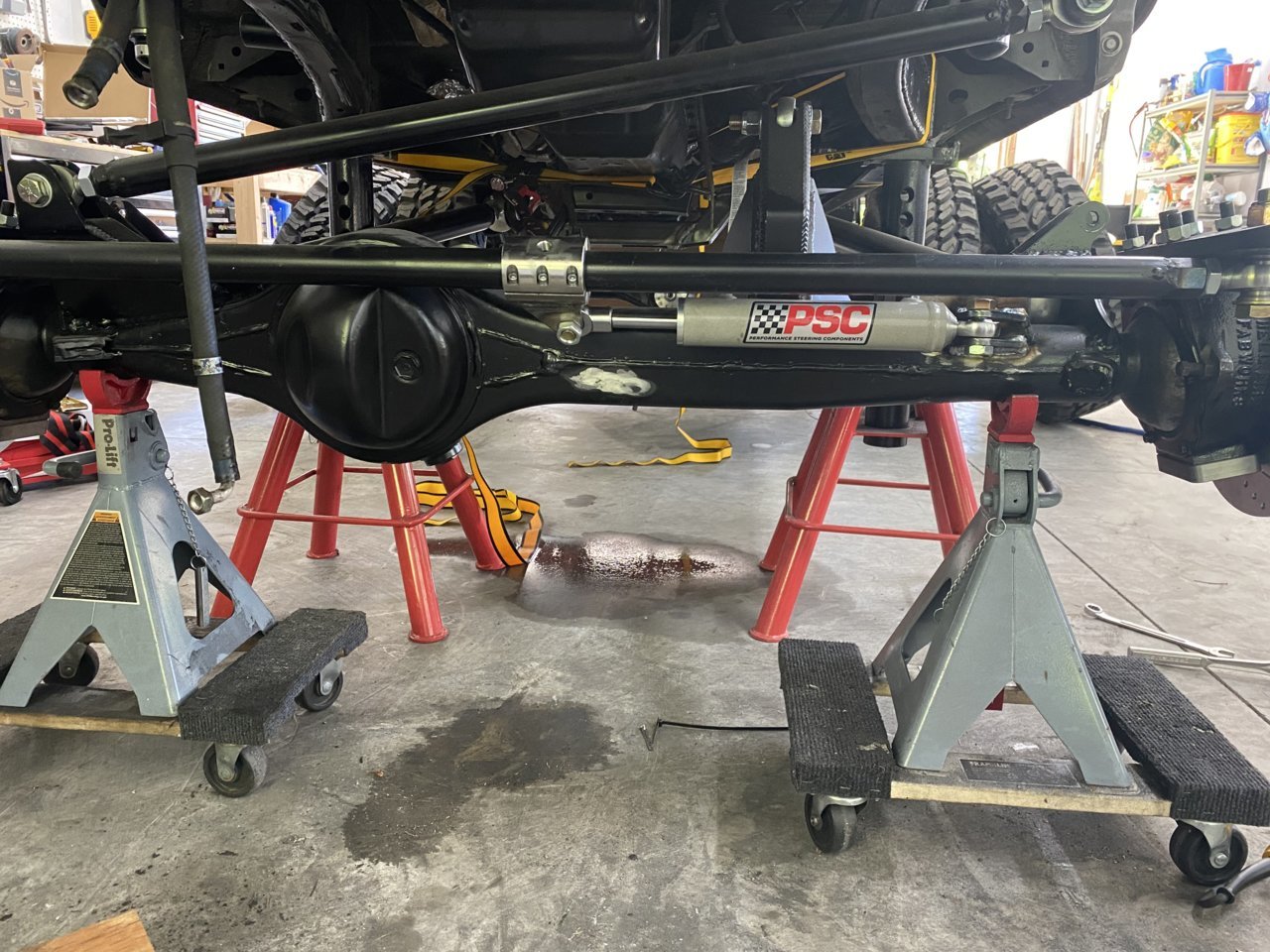

    Rez and cylinder mounted. Will make a tube bash bar…at full bump space is tight.

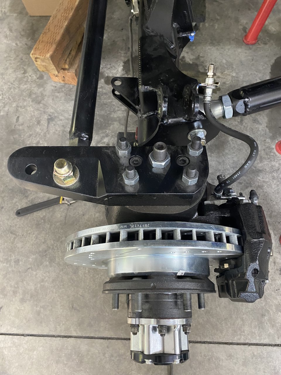

    Trail gear pump, hydro box, and cooler are in. Gotta finish up the routing just waiting on some fittings. Made a little progress on the front brakes.

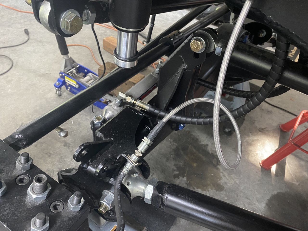

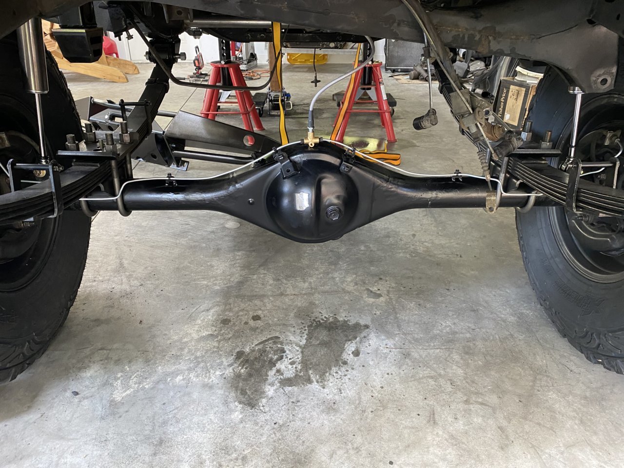

    Rear brake lines in

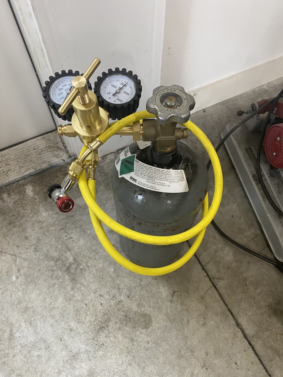

    More baby steps…hydro lines abrasive wrapped, shocks/bumps pressurized, brake lines finished, battery mount made on the passenger side under the hood…positive cable reached but need to make a couple longer grounds. 4wheelparts charges $25 per shock/bump to fill…prices suck these days.

    Thinking about getting a tank setup too, how much that run you?

    $250, local tank, power tank no leak valve, and cheap Amazon regulator.

    That Powertank no leak valve is great, wouldn't buy anything else. Lot of cheap "no loss" valves out there. Nice :cool:

    Agree, made it super easy. I was surprised that all dirt bike shops and most 4x shops won’t fill shocks around here.

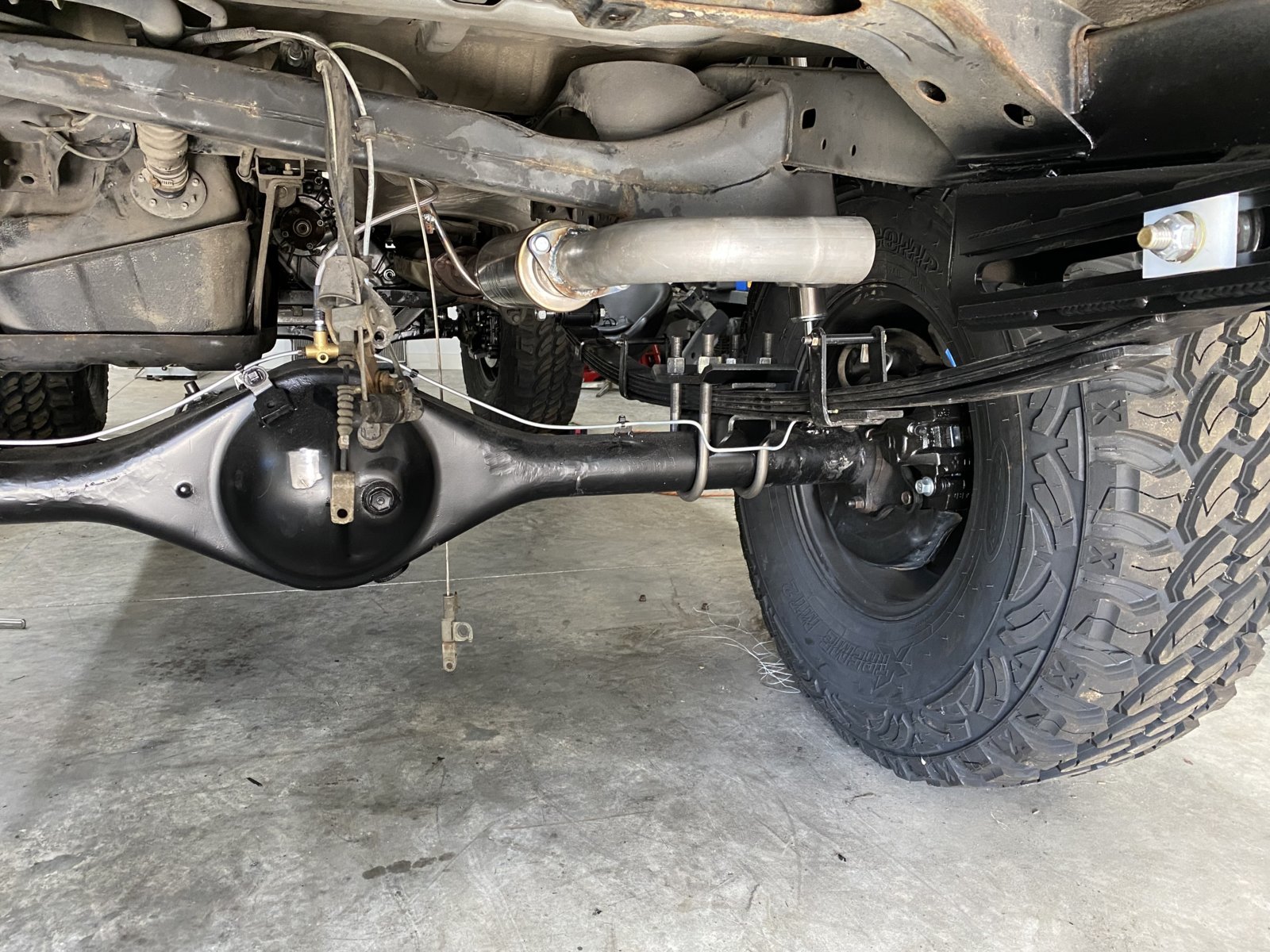

    For future reference, A340F output seal is Toyota PN 35015J, 90311-43007...i spent way too much time figuring this out. Once i get the seal should be able to put the t-case back in permanently. Ordered up exhaust tubing and a dynomax muffler, cat's home will have to be after the t-case x-member.

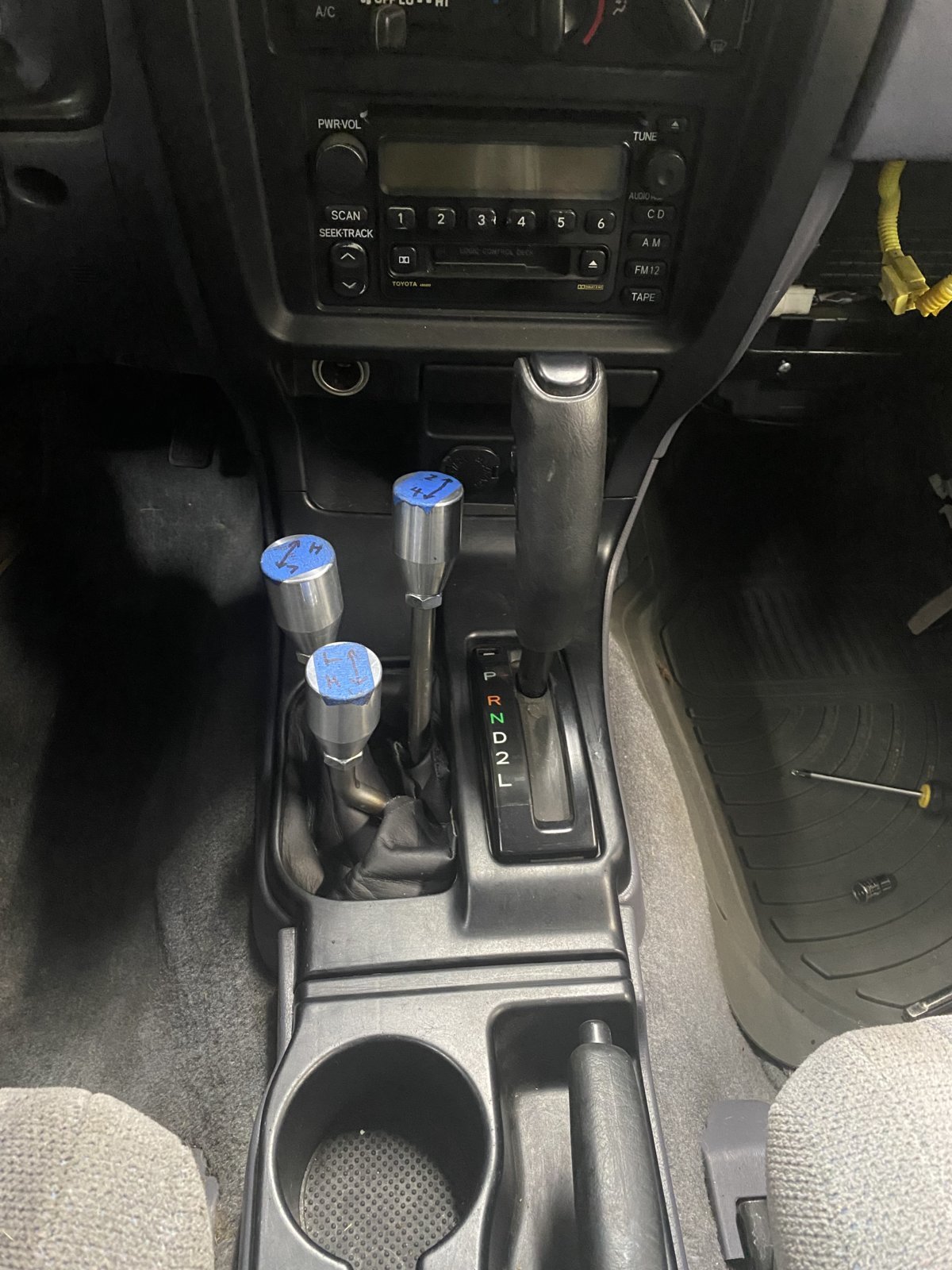

    Exhaust is done. Had to modify every Nwfab shifter, but they fit without cutting trim.

    Did your 2-4 shifter contact the L-H shifter behind it when in 4LL?

    All shifters cleared each other initially, they just didn't clear the driver's and rear side of the trim surround. I guess it's a lot to expect that triple sticks would be designed for every interior configuration and were pretty simple to modify.

    I had to shave the top of the 2-4 shifter to clear the gear shift (because I raised everything like an inch) and need to figure out why my 2-4 and H-L contact when in 4LL. But otherwise have been happy with the setup.
